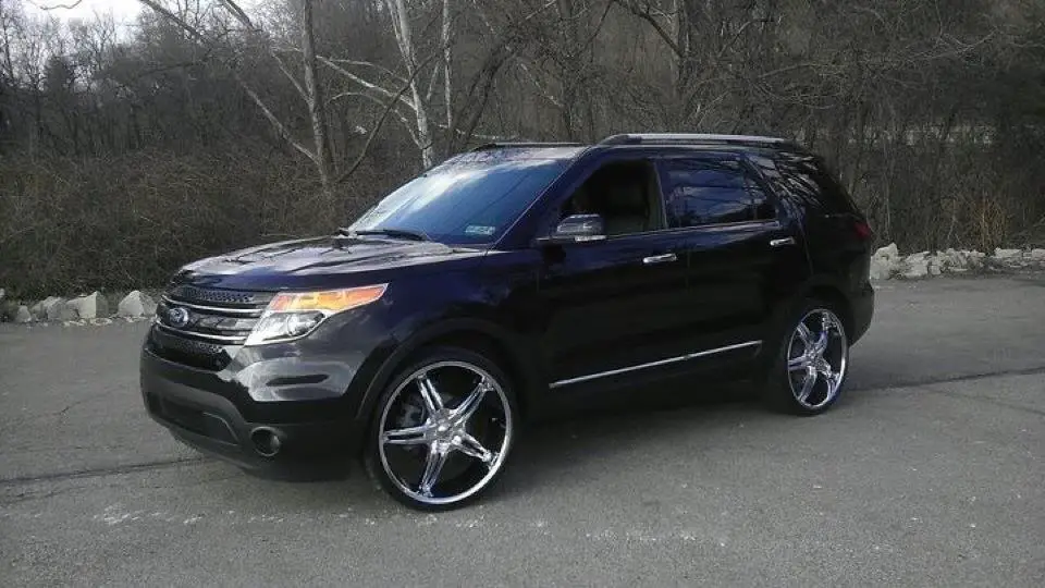

Just thought I'd let you guys know... The lowering kit from Eibach (#35121.540) fits the Explorer 4x4... It was designed for the Ford Flex, but they both have the same springs (even though different Ford part #s)... At the SEMA show you may remember seeing the lowered Explorer with 22" wheels... These springs were used for that Explorer. I have ordered them from Eibach, and just received them... Will be installing soon hopefully.
Before Lowering... With 24" Wheels
Before Lowering... With 22" Wheels
Lowered with 24" Wheels....
**Pics To Come Soon**

Not sure, but have there been any updated pics posted after the ride was lowered with 24s? Interested to know if the Flex springs installed with no problems and difficulties on your Explorer since they are the same springs used.
Bstollmaier
April 5, 2013
131
2
Cincinnati, OH
2013 Explorer Limited
I installed the Flex H&R springs last week on my 2013 Limited and I believe it looks perfect. I'll upload a pic when I get a minute. They fit perfect.
