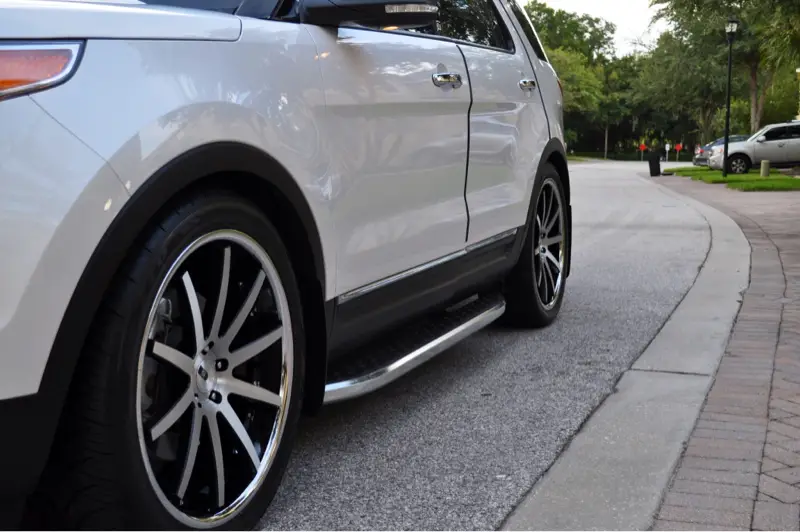

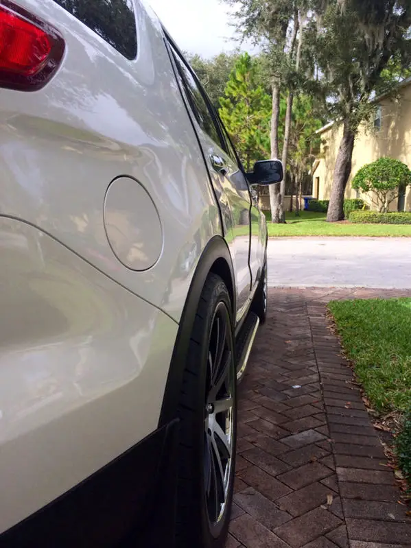

Keep in mind that if you are planning on getting wheels with an aggressive offset or spacer, you are going to have rubbing issues and will scrape the lower front "lip" in most parking garage's concrete "stops". I'm using the flex springs with 22 inch wheels and spacers and had to modify the quarter panel molding to reduce the rubbing on the back. The truck looks great though!
I'm single with no kids so most of the time is just me in it and I'm in florida so the roads are pretty good but, it still rubs when I put 3 adults on the back and hit even a small bump on a bridge on the highway. I'm considering trying the explorer specific springs.

The spacers i'm using are 25mm rear and 15mm front. The rims have a 38 offset. The front spacers are still in my toolbox due to the studs in the truck being too Long and hitting the back of the rim which doesn't allow it to sit flush against the spacer. I didn't have that problem on the back since the spacers are thicker.
