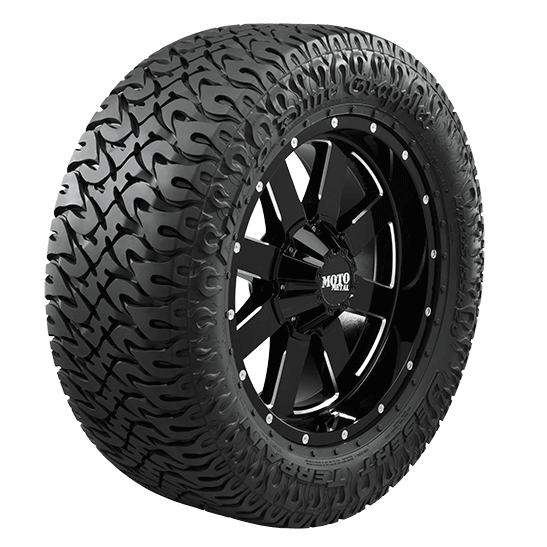

These are the tires I'm looking to drop in for my every day\ on road tires
I've had them before and loved them.
