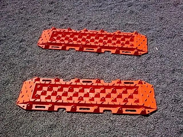

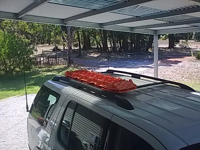

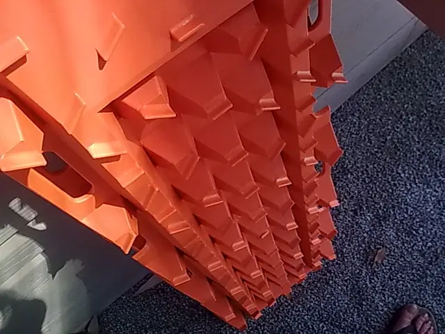

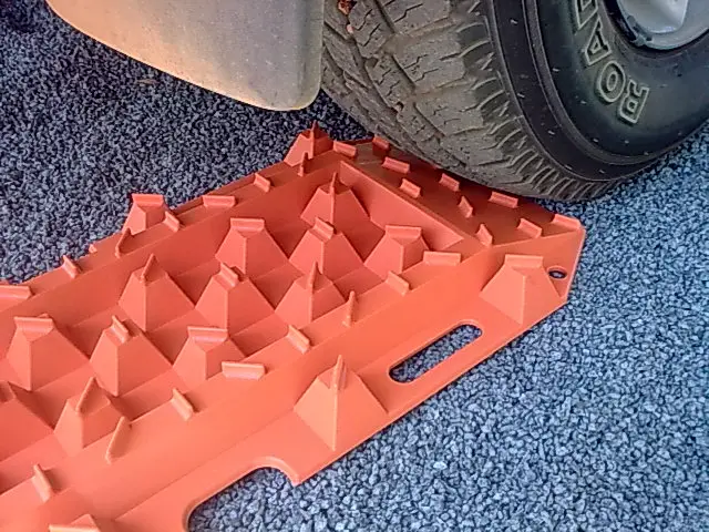

Got me first set of claw trax the other day. These should help get me out of the s*** if (who am I kidding?) when I get bogged. Check out this link to the off road access sub forum if you are interested: http://www.explorerforum.com/forums/showthread.php?t=307442

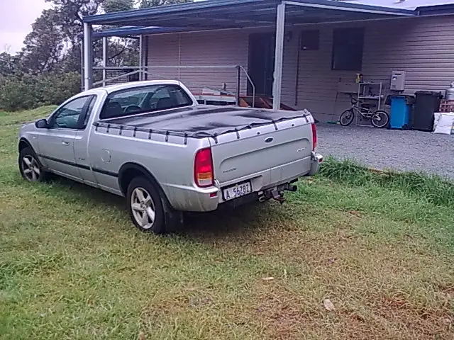

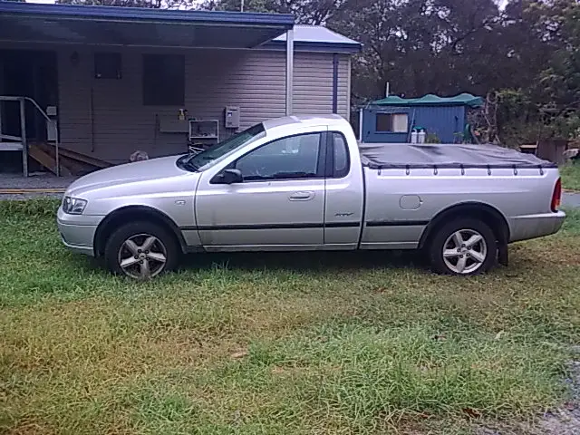

Me mate left his Ford falcon ute here while he work's on Uma so I thought I'd post some spec's and pic's of it for you guy's to have a squiz at.
2007 Ford Falcon RTV ute
4.0 lt inline six
factory electronic rear diff locker
2200 lbs (factory) load carrying capacity
OEM raised suspension.

It's like a sedan with a Ranger bed thrown on the back...confusing and cool.

I will paypal you $100 USD if you send over a pic of that ute, airborne off even a small dirt ramp. I want light under all 4, and the plate visible.
Cash.

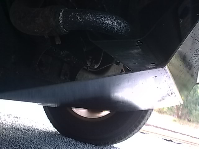

Damn, that was furken awesome!!! But he didn't leave the keys and I'm not a hotwire sort of a bloke. On a freak out note, he rang up saying he stripped one of the two bolts on the back of the cross member. Grade 10 structural one that opened up the spanner he was using to hold the nut when he hit the head with the rattle gun. He did manage to scab a structural rated bolt from one of his mechanic mate's so crisis averted. Sorry if this doesn't make sense all I know is the location of the bolt!

That falcon is something else.....I reckon the Explorer is more of a truck than that thing ever will be![]()
She's just a ute mate, not a truck
Does come with a 330kw engine version tho'.lynchy wa

Skid plate is on. The front is reinforced 6mm bar that bolts to the bumper mount, the plate itself is 2mm and it picks up the bolt's on the rear of the cross member for the rear mounts (the thread visible is the replaced 10.9 structural bolt that broke). I may add some ventilation holes if the power steering cooler needs them, let me know if you would, if you reckon I should do that. So all done.

Just a guesstamite, but I'd say about 20-25 lbs. SFA in the scheme of thing's mate.
Total cost= 3 cartons/crates/boxes of piss (or about $100.00)
