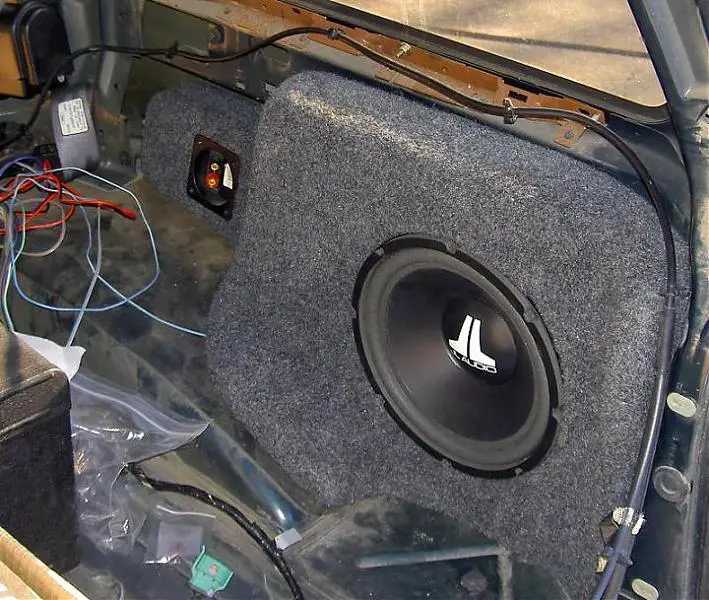

It's a lot easier to find a 8" sub than a 6.5" one. If the JL 6W0 (which can replace the factory 6.5") is too expensive for your budget (even at ~$50 on ebay), then throwing in a cheap 8" by enlarging the factory hole is the way to go. You CAN get the 8" box from a 95-01, but that also involves messing with swapping out the boxes and messing with the wiring, just hacking the stock box you have now and wiring up the sub and mounting it would probably be easier.
Spare parts should be easier to come by now, they are turning up in salvage yards now. I have a spare sub box from both a 93 and 98, plus a used JL 10" 0W speaker(came with Stealthbox).
If anyone changes the sub amp to an aftermarket, you need to know about the second signal in the line, a 5v mute signal. It supposedly affects the bass if you don't remove the 5v signal. I had five RCA preouts installed in my Mach recently. Good luck,

The Mach is the only one that came with the subwoofer(5 outputs). The Premium has four outputs, all full range.
