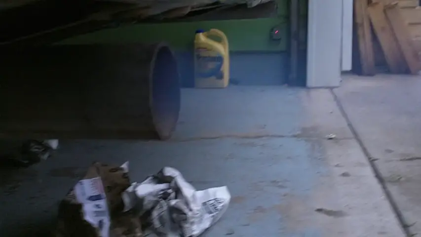

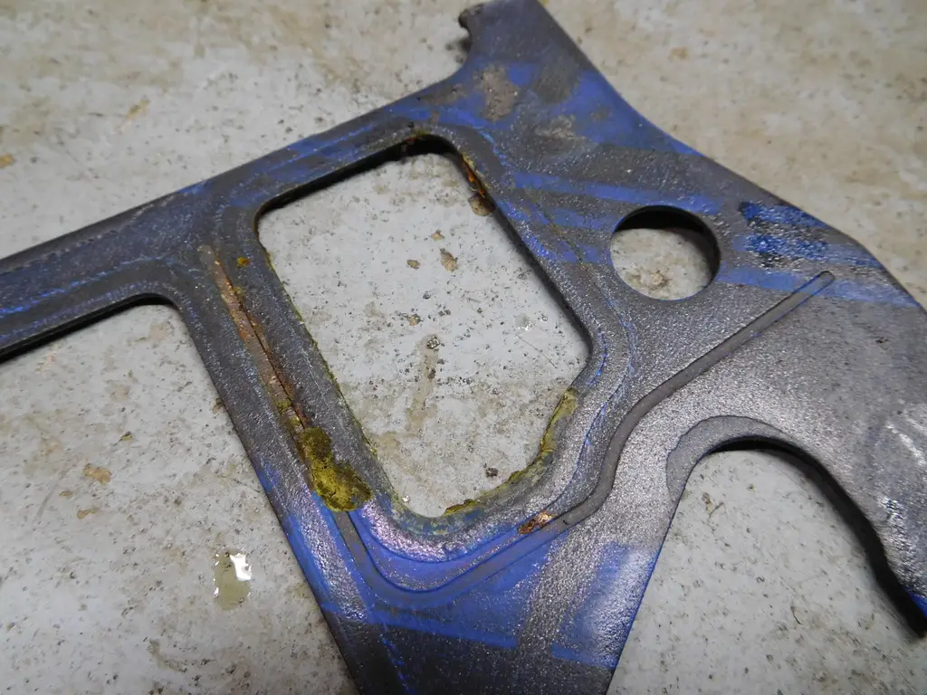

Well, here is how the Galaxie sits tonight
Unfortunately after we got her timed and she started warming up it became very evident that a cloud of smoke was developing behind the car. One tailpipe (Driverside) would start blowing smoke after 1 or 2 minutes of running and then the Motor would begin missing. It was a good day or two of test and theories.... Compression test - Good Compression.... Timing - Good Timing.... Firing order - Good Firing order.... Oil Pressure - Good Oil Pressure.... Temp - Good Temp... AntiFreeze in oil - No AntiFreeze in Oil... etc. Finally we agreed the mix of stuff coming out the tailpipe included AntiFreeze, so we finally started doing some research on the intake manifold gasket. What we found was that despite Fel-Pro being a good brand, it is common to have Fel-Pro Gaskets fail around the waterjacket/intake ports. Well pulled her off and there is some promising evidence that this may be Max's problem:
So, I've got 2 days, maybe 4 if I put off Moab till Sunday the 15th. We'll see how she goes, I'm not giving up on her, but boy am I getting dealt a tough hand of cards tonight! Thanks for all the support guys, hoping it all works out!

Get that thing back on there and let's go!
USMCBuckWild
December 31, 2014
133
4
Camp LeJeune, NC
2007 XLT
Don't get discouraged!
Take your time, haste makes waste. Prep it properly, align it all correctly, properly torque. Don't rush it and you'll be fine.

I did a motor swap in an older bmw many years ago, got it in and running letting it get good and warmed up. About the time the temperature was at operating temp, my buddy noticed a big cloud of smoke behind it (it was dark out and didn't notice right away). Sat there letting it run while I scratched my head for a while trying to figure out how the good running motor, that we even drove in the other car before pulling it, went bad from putting it in this car! All the while its putting out a steady, heavy stream of thick smoke clouding the whole neighborhood, I finally figured it out. The old motor had dumped a bunch of water/antifreeze into the exhaust and it was just burning up as the exhaust got hot enough, sure enough it quit smoking after probably 20 minutes running. It scared the crap out of me at first though!
