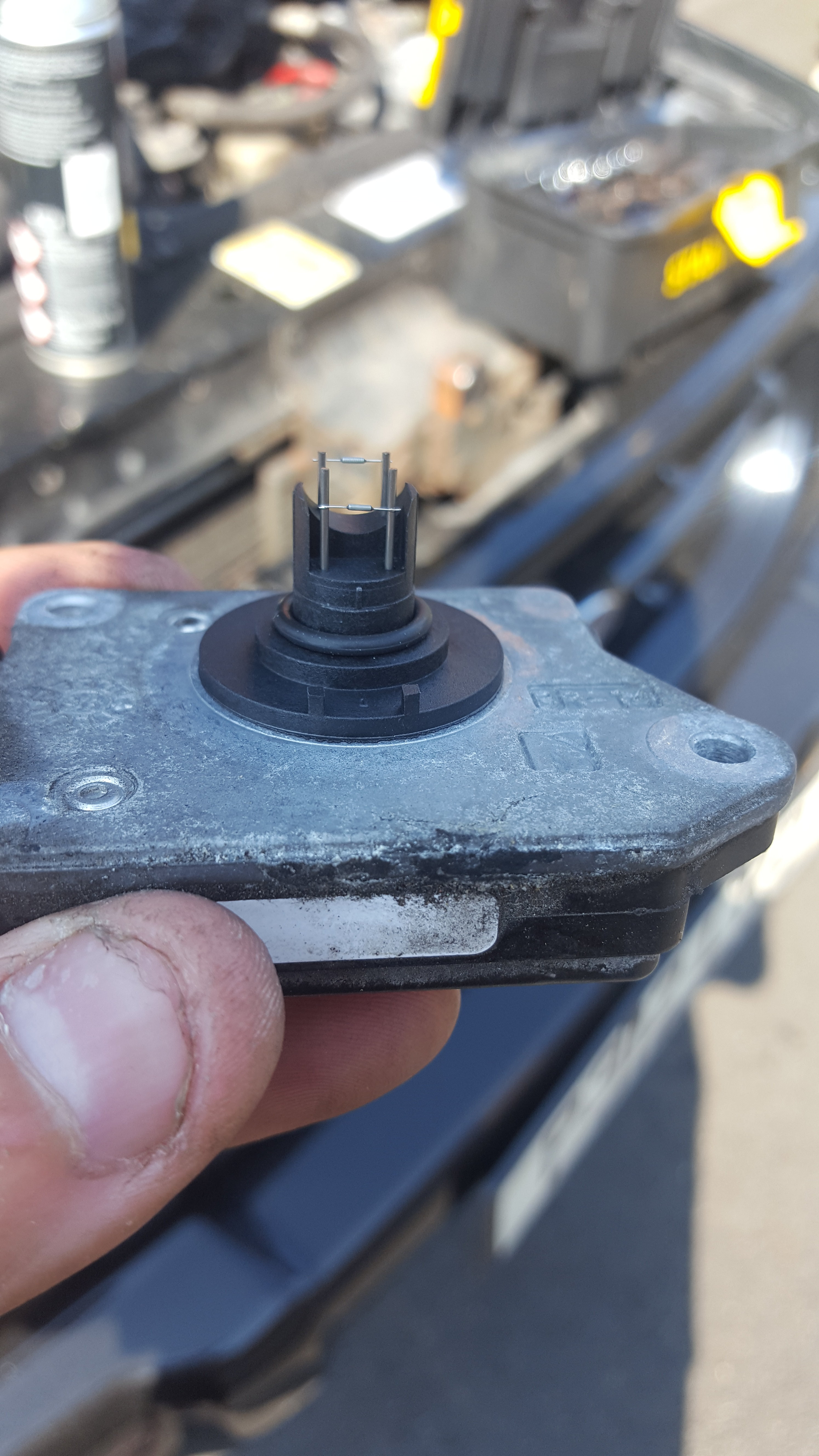

Been advised by local mechanic to change my MAF as it splutters under acceleration but doesn't have any codes.
My MAF is pictured below but none of the ones listed on rock auto look the same
97 explorer 4x4 sohc
Si
Looks good...replace your mechanic instead.
Others (who know the SOHC) will probably chime in with suggestions, but your MAF looks good and clean (I see you have a can of cleaner in the background) and you have no codes. Your problem is almost certainly not the MAF.
On the photo your MAF sensor appears to be perfectly clean, so if you have or can borrow an OBD2 scanner that reads out live data, then you can look at the values it reports (or rather the calculated results for the MAF of those values). If those make perfect sense and change reasonably according to the throttle when you play with the gas pedal. If those make perfect sense, then it's highly unlikely (to nearly impossible) for the MAF sensor to really be bad, unless there's something wrong with the electronics inside that makes it only fail sporadically.
But that should then throw some code I would suspect.
So yes, sounds like lobo411 is probably right and you might want to change the mechanic rather than the MAF sensor.

Yes, you need a good scan tool that can read the BARO parameter. There are internal checks that use the MAF to compute current barometric pressure. At sea level, it should read 159Hz give or take. If you see 149 for example, either you live very high up or you can suspect the MAF. There are some other tests too.
It is hard to tell if the MAF has a problem. Yes, it looks clean, but someone can look great and be very ill. I've been playing with Fords since 1996, usually they don't go bad electronics wise. They are usually replaced for a bad diagnosis, being dirty or damaged, but who knows.

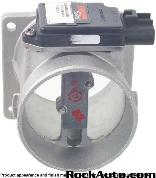

I agree with the other posts that it might be premature to assume the mechanic is correct about the MAF sensor needing changed, but what puzzles me is what you are stating about the MAF sold by Rock Auto looking different. Can you link a picture of what you feel looks different?
Some of them on RA do include the housing instead of just the sensor, for example the first pic below, but the 2nd pic looks the same as yours to me, or am I missing something ??
^ This 2nd pic is this: https://www.rockauto.com/en/moreinfo.php?pk=6284454&cc=1119675&jsn=635
It is showing up under the MAF listings for a '97 with the SOHC engine.
Some include the housing. Theoretically they are married and not supposed to be separated. It is very easy to damage if you are not experienced. Even a busy tech could drop and destroy it.
