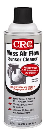

MAF Sensor Cleaner.
Any decent Auto Parts Store will have it for around $8 - $10 a can.
You will need "safety torx" bits to remove the MAF Sensor (the ones with the hole in the middle).
NOTE: Depending how dirty the two sensors within the MAF are, to get them totally clean, you MIGHT have to coat a q-tip in MAF Sensor Cleaner, and VERY CAREFULLY wipe off the sensors. And I mean VERY CAREFULLY as they are suspended with very thin wires...
maf-sensor-(2).jpg%20alt=
