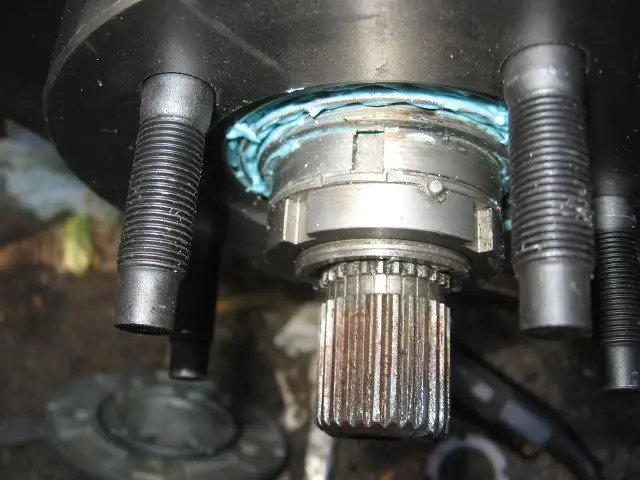

update...the verdict: pulled the tire and the front left hub is shot....the plastic splines on the hub ar chewed right thru the center...real easy to see...then, i just also developed a leak on the left axle and it wobbles too...that will be fixed monday or tuesday and we will verify the right side as well....so i got 2 4x4's with only 4x2 so wheeling is out this weekend,lol...
heres a couple pics for you....what is wrong with this picture????
this one should give you a better clue.....
So all is good, did you test it to make sure everything works now.

you thought i was joking huh??? look inside that hub, nothing....lmao....thank you very much mike...i put the hub on the left side and manualy tried it locked and then tried with the right side locked...looks like it works...if i had the time and money i would run up to azusa but i think i'm going to check out the X and try to watch a nascar race at the same time...again, thanks and i might even let you drive the project X for your help, lol...

this is my hub and below my hub is on the right...i went wheeling before i had my tires swapped on my wheels and then i went to the sand dunes to go wheeling and i had no 4x4...when i got home and took the hubs off my left front hub had been swapped with an empty hub...the turn knob was on it and it moved like normal....with nothing on the inside you would never know the difference until you went wheeling and locked up...i was already in sand but it was when i just dropped for no reason and was still moving when i knew something was up...i must say i was surprised to find a totally empty hub...
I'm wondering if the snap ring inside came off or something and they didn't know how to put it back together so some newbie mechanic just threw it back on there without the gear. I'd go back to the mechanic and talk to them, the piece may be sitting in the mechanics tool box.
Is the inside of the hub damaged from the shaft?
i thought about that and besides it being over a month ago, you know nobody will know anything...as for damage inside, the housing has some marks in the middle but i can't even verify if that is even my hub or a swapped hub from the shop that left me with it...i do know there is no damage showing on the outside of the hub nor does it look like something came apart inside...
