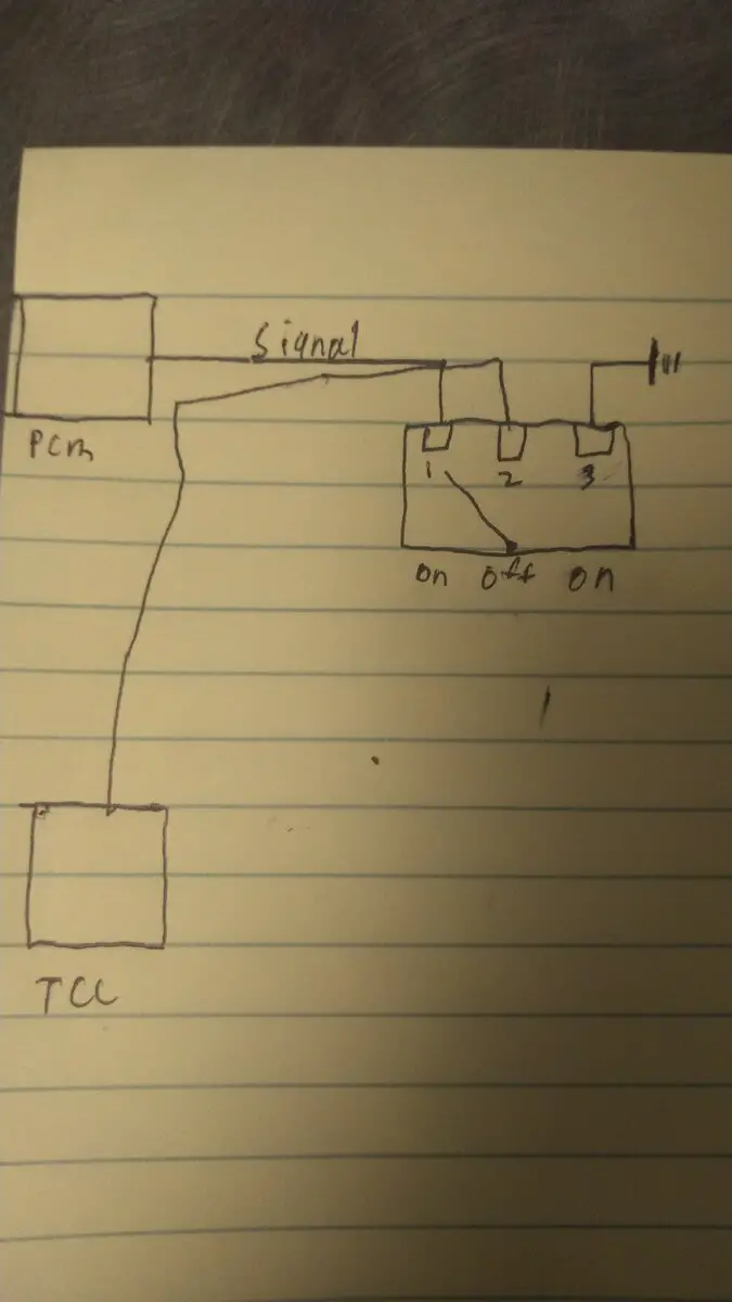

Yea I'm a complete idiot / unfortunate. The program I used for wiring diagrams is called all data and it stated the tcc solenoid is white for a 91 ford ex. Then I started looking at other diagrams and the solenoid is different colors each time but the only wire that stays white is.... The injector pulse for bank 2....Ah long reply wanted to do more research as to completely clear this topic up. The switch did not work, same symptoms. Thinking the relay may be the best route. Would I loop the energizing part of the relay back to the pcm? As it would be completing a ground or inturpt the power supply then tie it to the ground signal? Or maybe not even involve the pcm. I'm driving up to keblar pass this weekend. I don't wanna loose my lock up at higher elevations going through 285.
