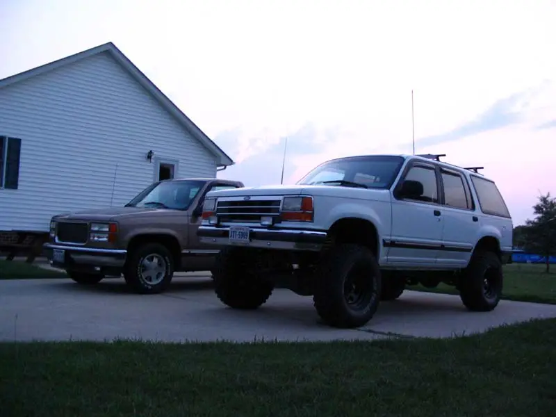

May 12, 2006 Update Teaser... :p

I've been busy...

bitchin dude, now its your turn to get real dirty with us. I should be ready by mid june to hit it up again.

Looks badass.

Thanks, I'm loving it! I'm ready to take it out on the trail, get it dirty and see how much flex I have. This setup is very soft, particularly the superlift leafs.
Have an Aussie locker and Trick Flow girdle sitting here ready to install this weekend. I'm ready to throw down.
