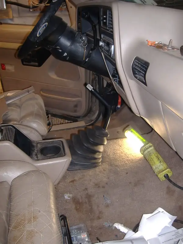

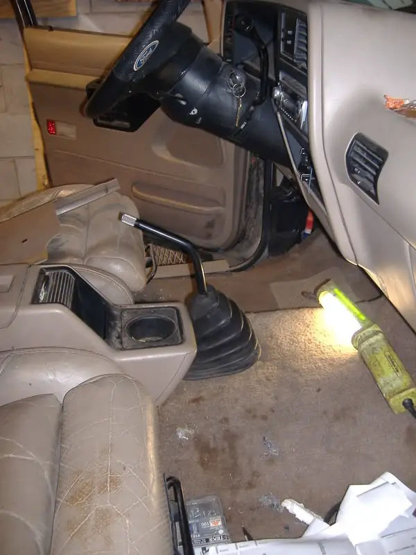

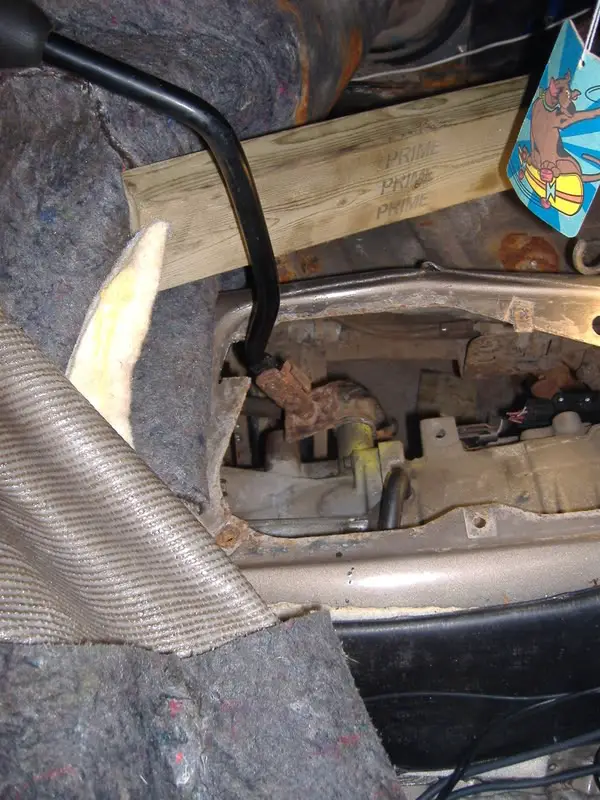

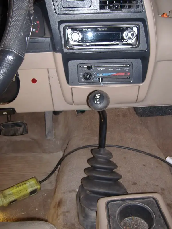

Got my shifter from an '85 F150 w/NP208 and AOD
Had to cut and reweld the shifter at different angle
Low range notch in opening
Low range
2H
2H Drivers P.O.V.
I really don't want to have to go manual but I may have too.

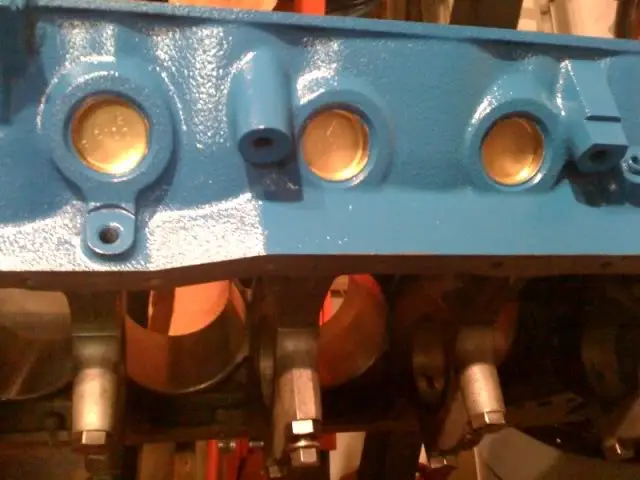

New rods are purty.
My engine has Bling.
I'm jealous, mine are steel, I like the brass.
hhhm
You would think that steel plugs would run therisk of cold welding or rusting to the block.
I like the brass as well so I coated them in grease before I painted. Only way I could think of to mask them.
Yes, I will paint over mine, they left them bare.
