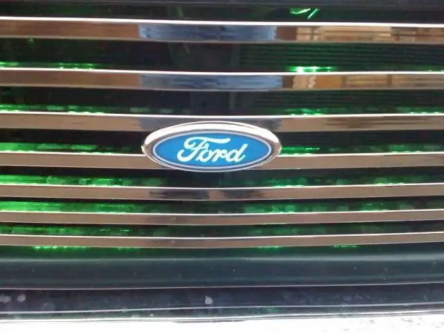

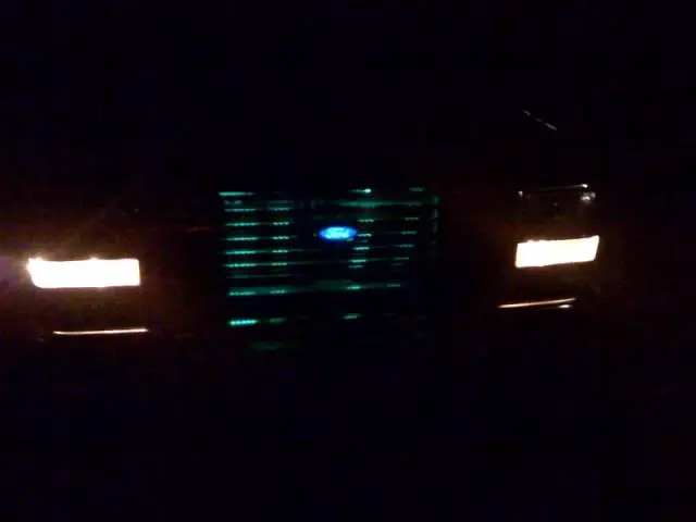

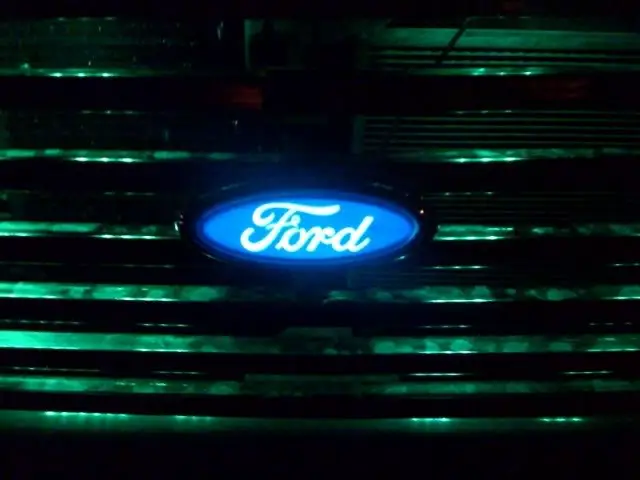

ever since i installed my tube grille, ive thought it was missing a little something, but couldnt put my finger on it.
i think ive got it figured out:
Bought it from a guy on here. Hard to find. Don't make em anymore.
Called "Lumilogo"
Thanks guys.
If you can find one for sale I say get it. They are cool.

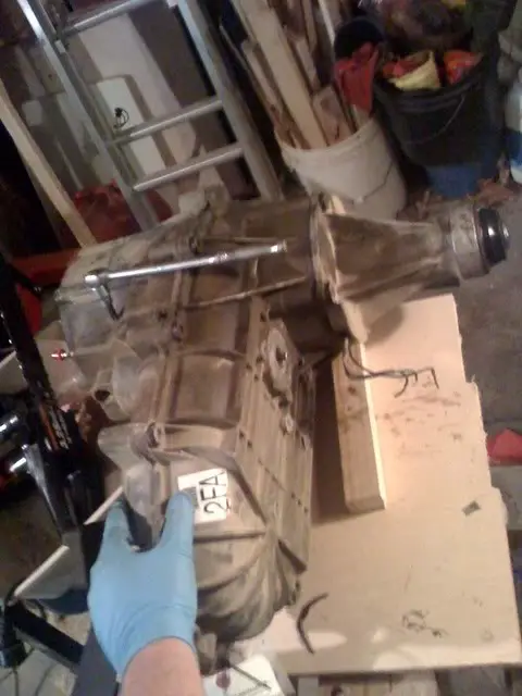

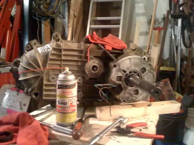

Sweet. Got a tracking number for the tcase. Should be here tomorrow.
Good News:
T-case and bearings have arrived!
This is why UPS sucks:
guy was seriously ROLLING! the box off his truck cause he didn't want to pick it up. i was bout ready to jump on the truck and read him the riot act. but its Christmas eve and he doesn't want to work and its hard to bust this thing anyway (internal parts not-withstanding) so i gave him a break.
This is why Summit Racing Rocks:
I ordered those on Monday and fully expected them to show up next week!
I know you guys said this thing was big but HoLy CrAP!

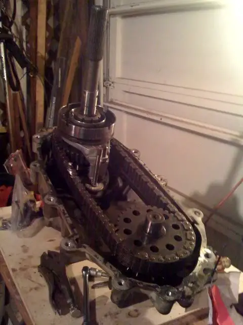

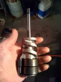

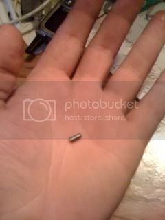

Bad News:My Stupid Ass may or may not have broken this:
When i was prying the main case apart i thought i heard an ominous "Crack". which may or may not have been this shaft snapping.
i don't think i was putting enough torque on to do this, but perhaps it was flawed or already weakend buy some un-forseen factor.
it is the shaft that turns the shift control cam, which is what moves the mode and range shift forks back and forth. engaging and disengaging the different modes, 4x4, 4x2, low range. part number;1356-122-007 listed as "Motor Shift Shaft"
but even had this been a non flawed shaft, were talking about the most pitiful piece of load-bearing metal i have ever seen in my life.
the shaft starts out as a stout 3/8ths bar stock and narrows at the end, the piece that inserts into the back half of the casing, to a fragile 1/8th!!
WTF was BW thinkin on this? :dunno: :crazy: there is plenty of room to have the full diameter shaft insert into the case but no, they cut it down to this little stub thing.
my dad brought up the idea that it is a designed fail-point to keep the whole case from grenading if something were to bind up big time. which makes a some sense.
any way, the part is cheap, like under 20$. so I'm not sweating it.
More Bad News:as you can see from the pics, though this is listed as coming from a 94 f150, it has no speed sensor gear. so i guess i get to swap some more parts around.
some one mentioned a thread on putting a speedo gear on a non-equipped output shaft. could any one have a link? i will do a search.
