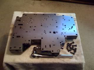

valve body nightmare, reading the book, looking at check ball locations, look back at valve body, look back at book, I think my head is about to explode! what a puzzle that sucker is :)
Wasn't to bad.
But it had only seven checkballs on the instructions while I had 8 in my valve body.
The instructions had a picture of the channel side and it had an arrow pointing to one of them that said "do not put check ball here". So I now have one left over.
I'm thinking about double checking with transgo about that before I reinstall it.
Transgo has done that a lot in AOD trannies, seven sounds like the right number.
I'm thinking it has something to do with making the trans hold 1,2, and 3 to any RPM.

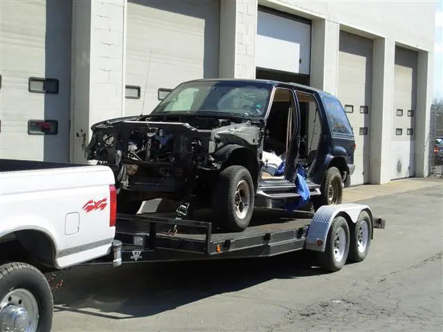

Boy, it was like Christmas at work for me today :D Thank you again for the tailstock & shaft, Matt! I have a bunch of v8 accessories floating around from my '99 XLT parts truck, let me know if there's anything you need :)
do you still have the truck?
Unfortunately had to trash it, didn't have anywhere to keep the poor thing :(
