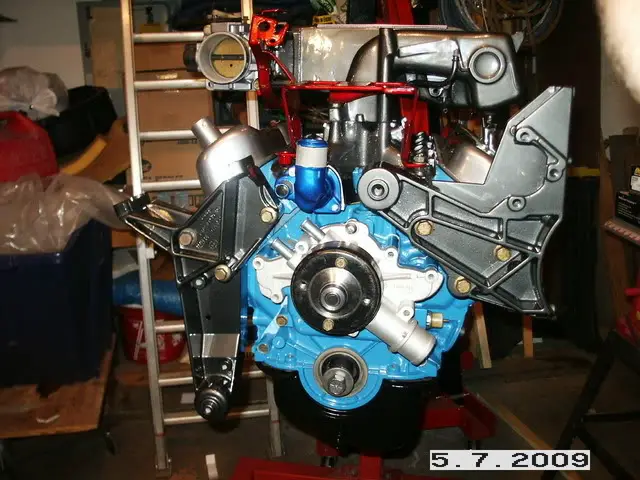

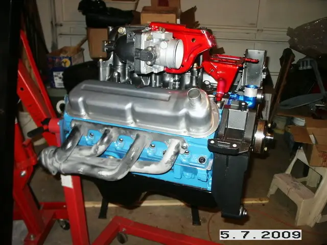

Well I got my radiator in and some more accel spark plugs and I got the heads bolted down and started on the rockers.
The jacked up journal set me back a ways. I may not be able to get the swap started this week. Maybe next weekend.

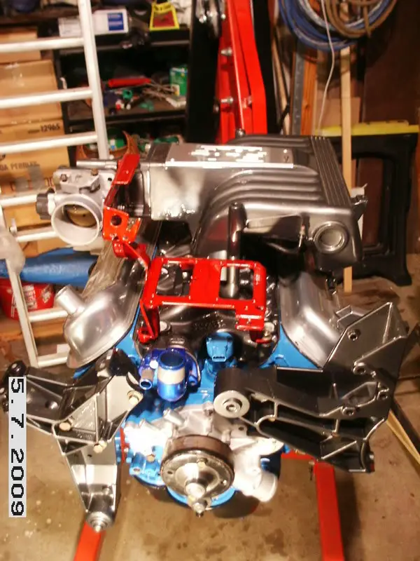

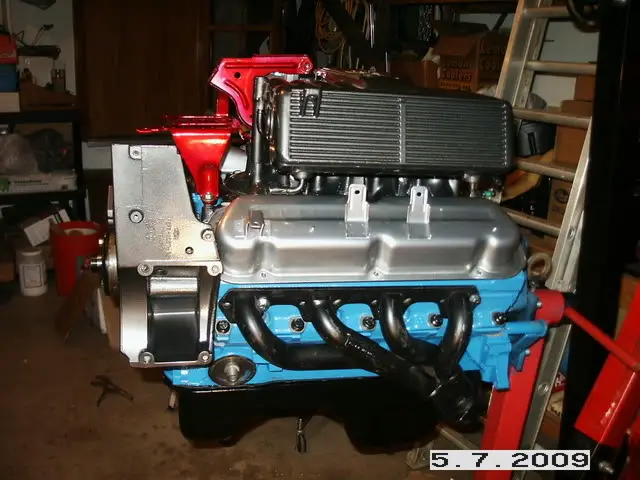

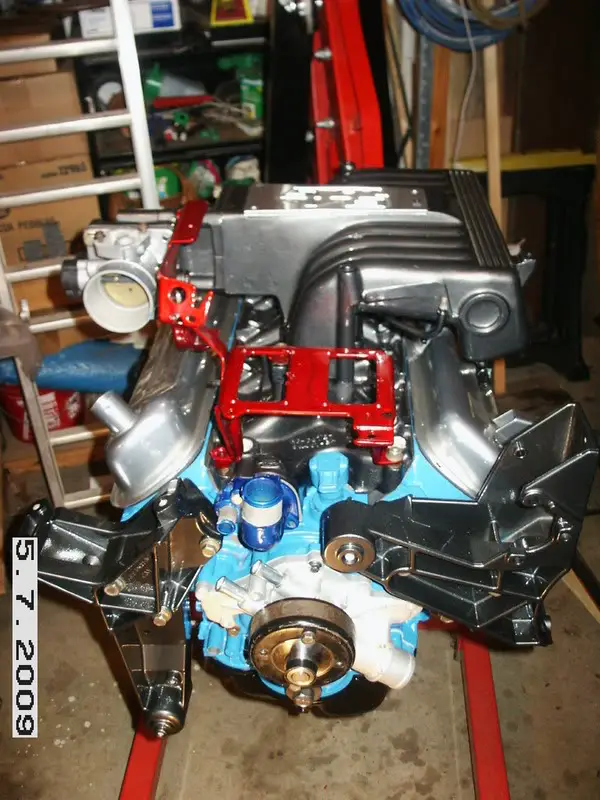

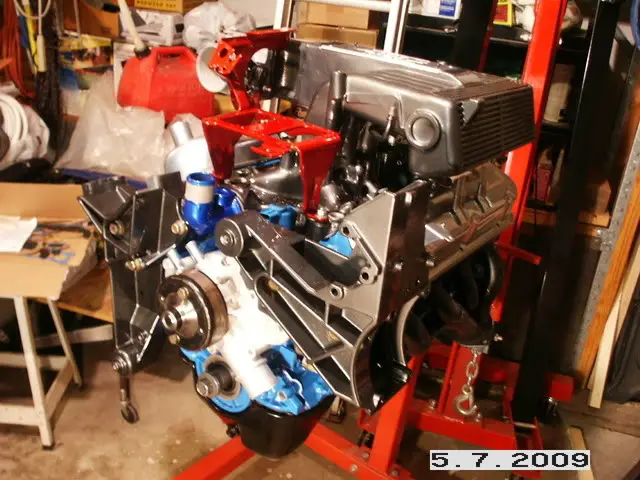

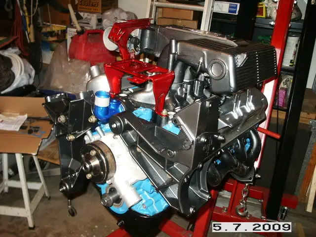

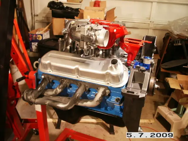

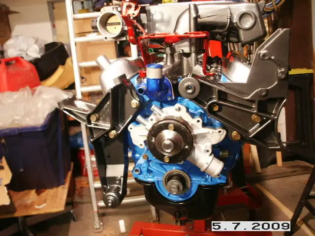

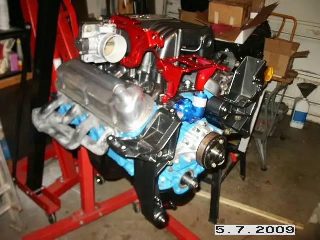

:eek: O.M.G. Sexy! :eek:
Holy Awesome Powdercoating Batman!
Jon if you want full res versions of those pics for your coating thread or whatever let me know.
Very nice, very.
....it looks alright....
I mean, I've seen better......LOL
That looks really good!
Ryan
wow looks great! I would be to afraid just to put oil in it ha ha its so SHINEY. :cool:.
It's almost a shame to hide a BUNCH of that with all the wires..
Ryan
thanks guys.

Whoever powder coated that stuff really knows what there doing. And now you can't start the engine up cuss it looks to good. Just keep it in the garage.
Lol
