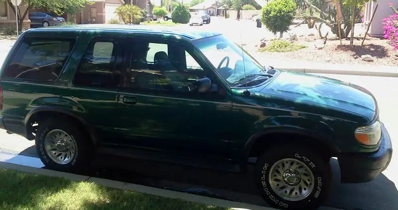

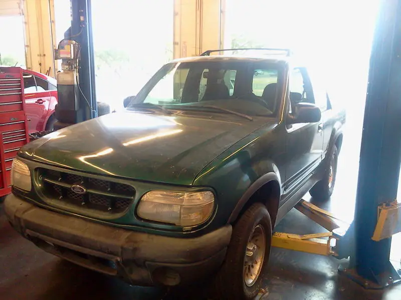

Here she was when I got her. Base model 99 sport 2wd 4.0 ohv 5speed, one owner, 196,000mi

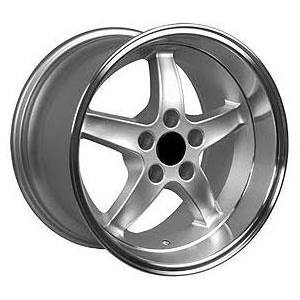

This is after she's all cleaned up and added some pinstripes, removed the roof rack, and lowered it 2". I think I swapped my 3.27 open diff for a 3.73 lsd here too. Then one with the new wheels and tires (before I made the center caps).

I think when it's time for new tires, I'm going to go with a wider rear wheel. I have 17 x 9 cobra r wheels now. I'm probably going with 17 x 10.5 in the rear!
