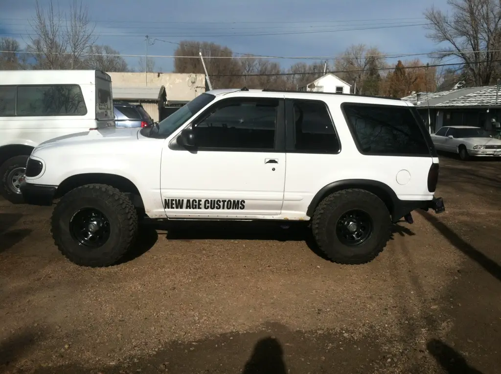

After that I got a really good hook up on a set of black rims from a buddy of mine and out 32s on stock ride height.
So after the new rims and semi used tires it was time to ball out of control
Here in this picture both my X and turbo Legacy are sitting at stock ride height

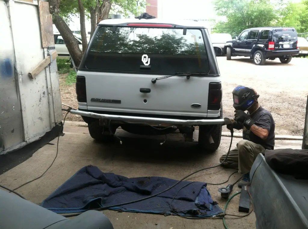

Sorry I didn't get any afterwords pictures right away but after the lift I started to make it look like a actual rig that should be off road. Started the prosses by building a custom rear bumper to change up the look.
No real good images I would like to post with it finished that doesn't have my plate in it. But to make the rear plastic flow into the tube rear bumper I set to work cutting up some plastic and the steel behind the plastic.

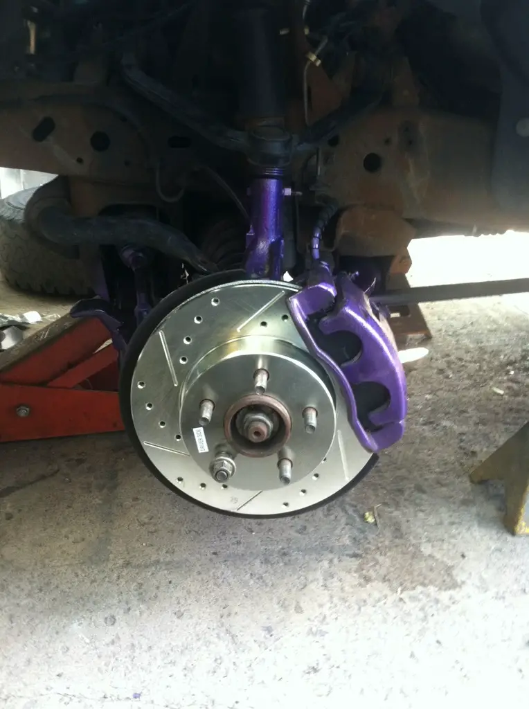

Thanks to my brakes needing to be changed I felt like I needed a little extra braking power up front, and yes all my suspension is now painted purple and the frame is sprayed in duplicolor bed liner

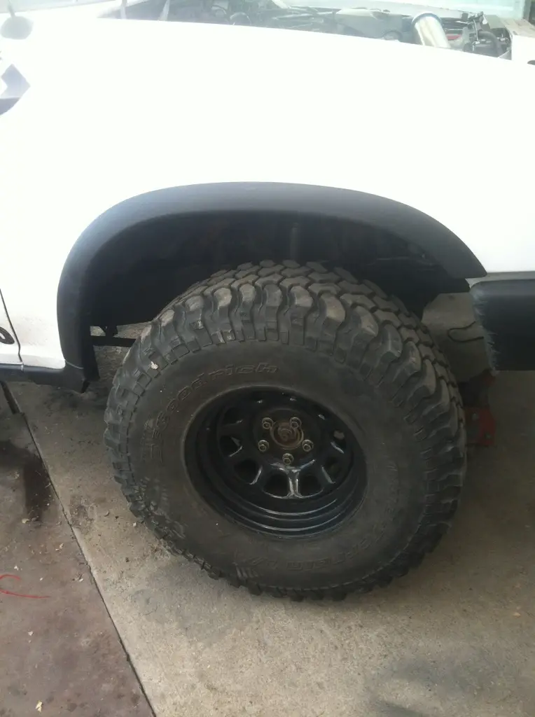

So here's the side profile without the front black plastics on so I can actually get around with some steering.

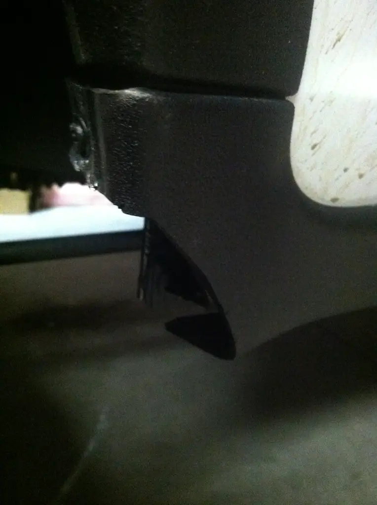

I wanted to keep the inner fenders so I did some trimming on them to make sure they would fit without the tire rubbing on it. As I got them in I had to make a straight cut so now the part that sticks down in this picture isn't there anymore.
Had to get the cut on to make sure I could get full steer with no bind. The fender was trimmed a bit and we had to cut some of this pintch weld to get the clearance then followed it all up with bed liner to make it look good and cover up the cuts
Better picture of the inside
Got all the trim painted black in the bed liner
Had some nice cuts on the trim piece on the lower fender to match the cuts on the fender we made I'll have to get a picture of that for y'all
Here's a better picture of the rear bumper with the hi lift on it. Hopefully soon it won't be on the bumper and up on the roof when my partner at our shop gets my roof rack finished up.

Nice! Any close up pics of the rear panels u trimmed, dont think I have ever seen that done before. Flows really well with your tube bumper.

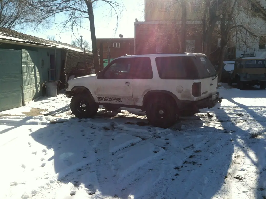

Here's one right when we started to get snow storm's back to back

Mate, bit of advice, if you're going to custom fab a rear bar you're better off putting a tyre swing arm on it and moving it out from the bottom. Also that jack on the lower ass is a terrible spot, as you going into huge ruts and up hills you will smash it hard. Other than that looks sick!
