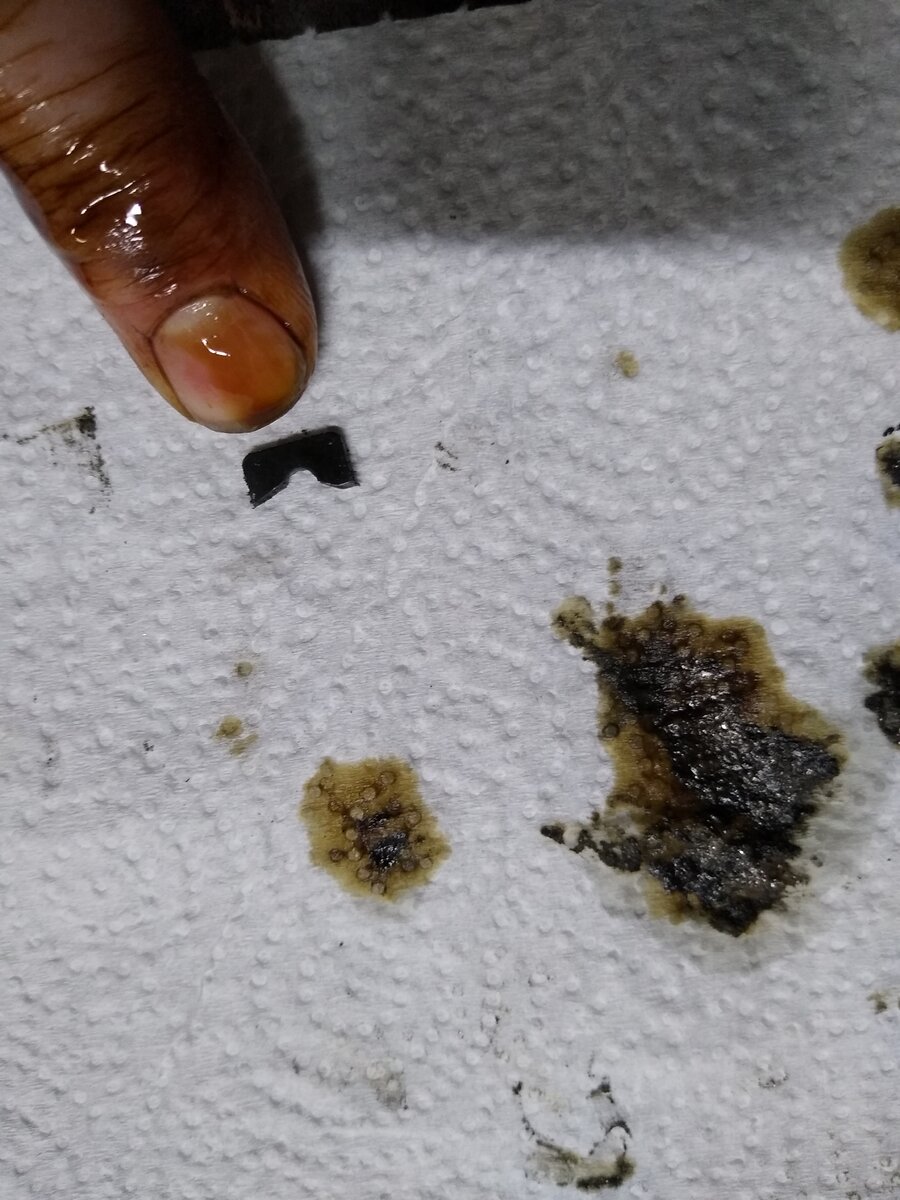

Yesterday while draining the oil this piece was attached to the magnetized drain plug on my explorer 3.5l NA. I'm trying to figure out what part of the engine this has broken off from. Do you think I should pull the pan, replace the oil pump or flush the engine? Weird timing because my water pump started spewing coolant and I had a misfire on cylinder 1 within 2 weeks of each other. Coincidence? What would you do?
Have you fixed the water pump yet? Looks like a part of the secondary tensioners but hard to tell

Yesterday while draining the oil this piece was attached to the magnetized drain plug on my explorer 3.5l NA. I'm trying to figure out what part of the engine this has broken off from. Do you think I should pull the pan, replace the oil pump or flush the engine? Weird timing because my water pump started spewing coolant and I had a misfire on cylinder 1 within 2 weeks of each other. Coincidence? What would you do?View attachment 325883
Looks like a timing chain lock, it´s imperative that while you replace the water pump you check all timing components (chains and tensioners). That oil looks really black, which oil are you using and what interval you change it?
7000 mi intervals on full synthetic mobile 1 with a pure 1 filter or once per year depending on how much I drive it. That black stuff is the metal shavings from the magnetic drain plug on the paper towel. (Bottom right blob)
