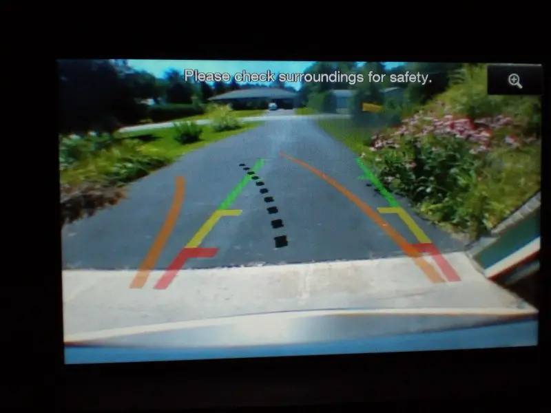

They removed the option for the rear camera to not have the lines curve when backing up while turning. I don't care for the curved lines and find them annoying.
The curved lines were part of the Park Assist system. I don't know why they would remove them I found them very useful even for manual parking.

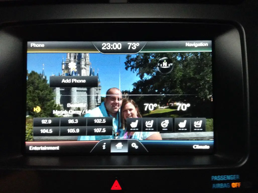

Just got the update installed in my '13 Limited.
Sorry for the not so great pictures, as I took them at midnight with my iPad.
A couple of surprises right off.
On the home screen, the artist and title show up, instead of the station name
And the backup camera now has "zones" with colors for danger.
The screen transitions are much faster this time around. Finally some efficient programming! I notice faster responses for every button. No more laggy delay. Maybe this is because the car was really warm due to the long idle and no phone was Synced to it after the update. I'll have to test it out tomorrow with a phone paired and my iPod connected for how responsive it'll be.
Peter
They didn't remove them, just the option to remove them is gone. Before the options were "active + fixed" or "fixed". Now there is an Enhanced Park Aids option with only on and off which does nothing to the curved lines.
The curved lines also appear on vehicles with BLIS, not just Active Park Assist.
Can someone snap a picture of the curved lines? my 2013 with BLIS but not active park assist has always only shown straight lines. I just want to see what I'm looking for and maybe I'm misunderstanding something.
Thanks for the info Riley. I guess I misread your post. It was after all past my bedtime. I read that the default for the lines is now 'ON'.
Sigh, another trip to the garage.:D
Here ya go. Keep in mind this is with V3.5.1
Peter
