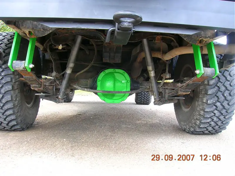

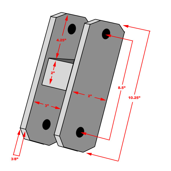

make shackles dude, heres the plan courtesy of one of the other guys on here, he helped me out with them,
as far as install me and my buddy did it in about an hour
heres how we did it as my tools are limited
1. Jack up the side of your truck as much as you can
2. slide some jack stands under the frame where you just jacked it up, usually right in front of the leaf springs closest to the front end.
3. Un bolt the bolts on your factory shackles
4. jack up the side of the axle your working on to take the pressure off the spring
5. Hammer out the bolts in the shackles, watch your hands itll snap up pretty hard and rest against the frame.
6. Take a piston jack and place it on top of the leaf spring and jack it up to the top of the frame, this will start to push the spring down to the level you need it at to install your new shackles.
7. Install em, one side at a time, tighten everything to 40lbs of torque
8. Put your truck back on the ground and give er a run, my jack wasnt high enough to do this and leave the back wheels on so i took my wheels off one at a time as i did the shackles

i made some 12" long but have yet to drill the holes, any idea how much a lift it will give me?
Depends on where you drill the holes at...
10" C-C. and was it 9/16" hole right? How long a bolt did you use? 7"? with nylocks?
Well if you are going 10'' C 2 C and the stock are like (I believe)4.5" C 2 C then you have 5.5" more so 5.5/2 = approx. 2.75" but you can only go so long before that general rule doesn't work...
I just bought warrior's part number #153 and I am pretty sure they are 9/16" like you said...as for the length of the bolt I am not sure I would have to go measure you just need it long enough to go all the way though shackle on both sides of the leaf itself and make sure it will go all the way through the lock nut so you can make sure if locks correctly, might also want to put some locktight compound on the bolt...
Right on thanks I think I will try 10" C-C and see what it does then crank up my torsions to 2" i want it to be a little higher in the back but not by much. I think I have 3/4" steel plate for my shackles that are home made so I am thinking 7" bolt would be lots I think Stock is 5.5"

Hey Regulator XLS- thanks for posting that schematic and pics.. Looks like an awesome truck.
For clarification, did you follow those dimensions when you made your shackles? How much lift did you gain? I'm planning to do the same thing to my 99 Sport, but as it is my daily driver, (I wheel my Jeep YJ) I'm only looking for 1.5 inches lift, max.
Please post up, and I'll get right on my shackles!

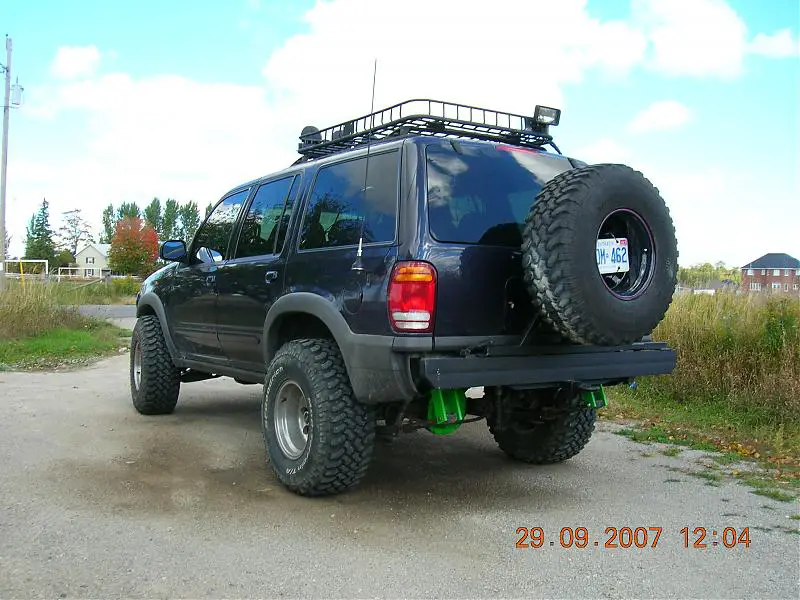

i did them the exact same without the centre brace, i got 1 5/8'' of lift, but i also have a heavy rear bumper which cause me to lose about a half inch of lift before the shackle install. so really it raised it just over 2''. hope this helps!
