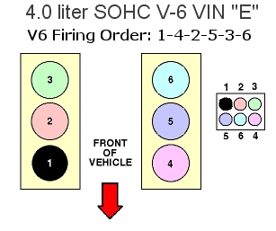

Changed the spark plugs (was planning on doing anyway) seemed to help slightly. Changed plug wires (motorcraft) and got worse/new problems. Changed to plug wires again (Napa) and new ignition coil. Not as bad as before but still has issues, at least now I have engine codes. Gives me lean on bank 2, misfire on 6, misfire on 5, random/multiple misfire (cant remember which) and misfire on startup codes. Any thoughts, or maybe something I may have bumped?
check cylinders 5 and 6
Make sure cylinders 5 and 6 are wired to the correct terminals on the coilpack.
Well I feel like an idiot. Funny that it ran better with the crossed wires then the replacement motor craft ones (those I replaced single wire at a time instead of doing all at once). Tomorrow I'll know better about it still running lean or the shake
