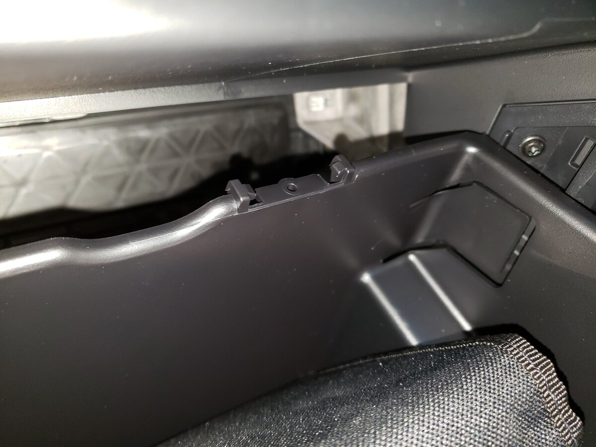

Is that clip easy to pop off? Curious if it has an engineering number stamped in to it. Crazy that it looked to be available only with the complete door, but I have the guys at my local dealer looking in to it. Ford probably got tired of warranty claims from it breaking off, which would have been easily remedied if it was a separate piece. Very annoying for something so minor.
Here's the slot on mine where the clip was supposed to be:

I just checked and I have the clip on my Explorer LTD that I picked up this week.
TBill
February 19, 2014
264
58
Prescott, AZ
2020 Explorer Platinum
The clip presence really depends on when the vehicle was built, deletion was a running production change.
