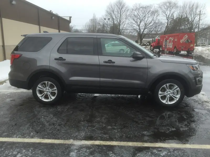

I signed up here, because I thought some would enjoy watching the progress of my companies 2016 Police Interceptor. This vehicle will be a Law Enforcement demonstration vehicle, which travels the area being shown to Police Agencies. It will of course have a ton of new police technology on board, but for the purpose of being here, it will also have all the fun stuff you all like. This will be an on going thread so check back for updates.
This is how it starts.... a relatively basic 2016 Police Interceptor Utility in grey with 18" alloys, and really tiny cop tires.
Stay tuned to follow the transformation, which will include; Black 22" TSW's, H&R Springs, and a boat load of police equipment and technology like a 12.1" in dash touch screen display and a host of LED warning and scene lighting.
are those wheels standard or are they the "street package" or whatever they call it
Oh wow, you have fog lights on your interceptor and non steelies! I thought they only came with the steel wheels and fog lights. Is there are special unmarked version of the Explorer that comes from the factory now?
My PD has a black 16 Explorer with those wheels as well. Very difficult to tell it is a PI because of how they now blend in with the rest of the explorers.
Looking forward to seeing the end result. I am a mfg rep for an emergency light company and have my Explorer Limited fully equipped. I will post up some pictures of it.
This does not have the street appearance package, but it did have the alloy wheel option, I believe. It also has carpet, which for me was a must. The fog lights are not fog lights, but OEM Ford/Whelen warning lights in the fog light housings. This was also an option. Most of the work is now complete, it just needs it's graphics. I also have a '13 Explorer Sport, and an '11 SHO.

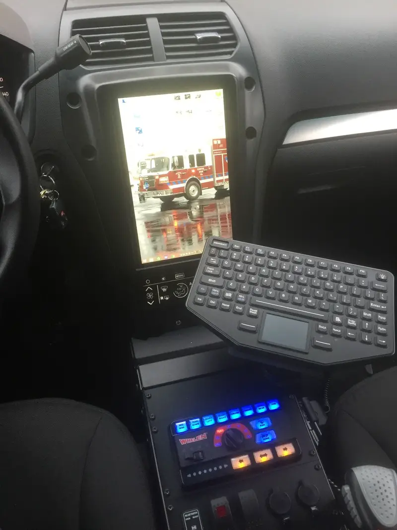

Is it s "low Profile" interior install or you just mounted stuff in the open and drilled into the dash/panels?
Yes confirmation that it is control, because of the red around the rotary knob switch.
I love the look of that smoked Legacy on the roof.
