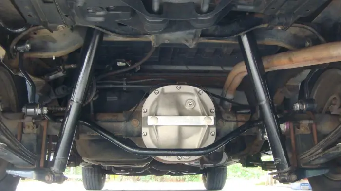

Rear Sway bar 1"
Everything I've read states that the rear sway bar is one of the best mods for handling, But they were also talking about the bigger ones from Explorer Express and Saleen. Is this smaller sway bar going to make a difference?
Also if a go with this sway bar, it looks like I will still need to get poly bushing to upgrade the end link bars. Can anyone confirm before I try to call Summit

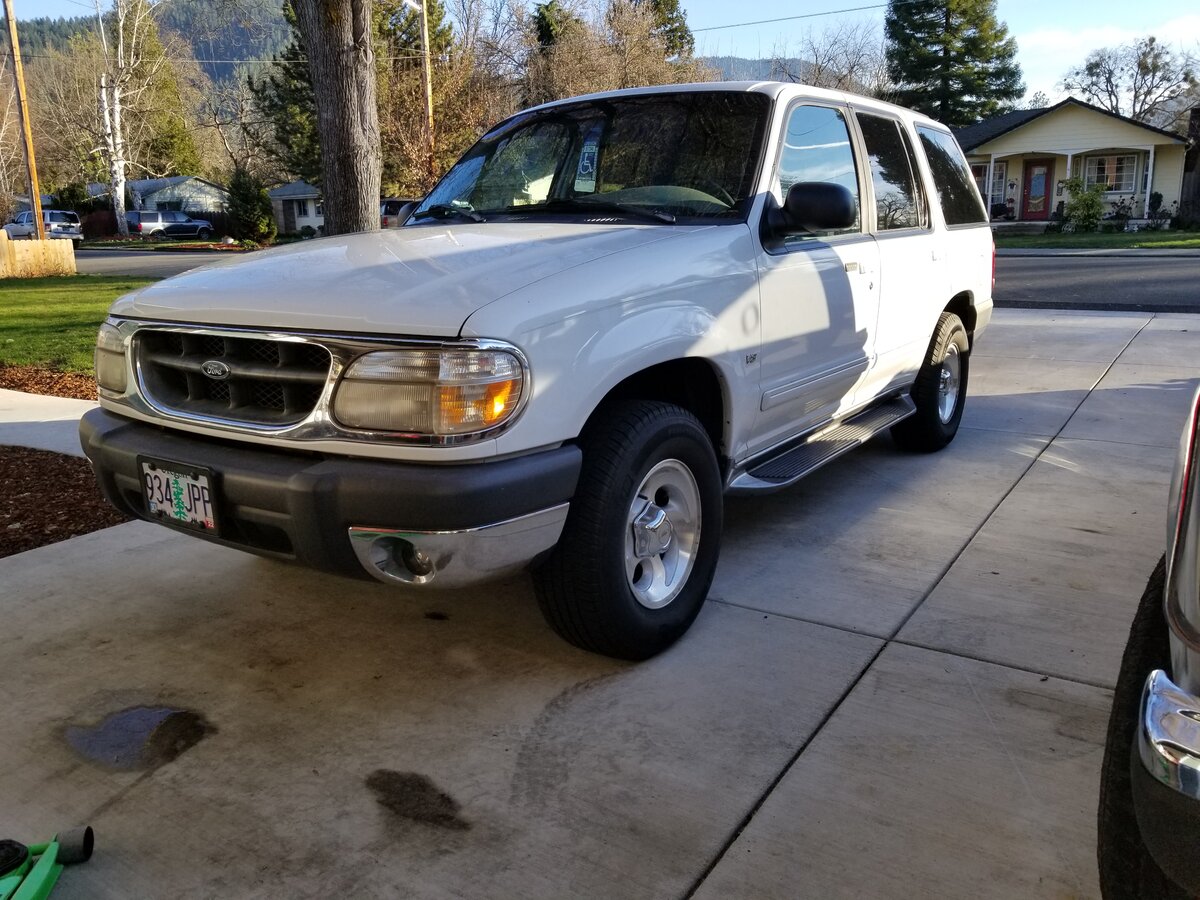

Nice 99 looks like mine

I'm not sure how firm those thermoplastic bushings are. You want them to be as firm as possible for the rear which needs a much larger sway bar. The EE bar is ideal, and that's with the stock rubber end links. Those are 1.125", so the 1" bar you found is getting close.

The sway bars need to be level at ride height, the arm part. As the height changes a lot, the end link needs to change length to match.

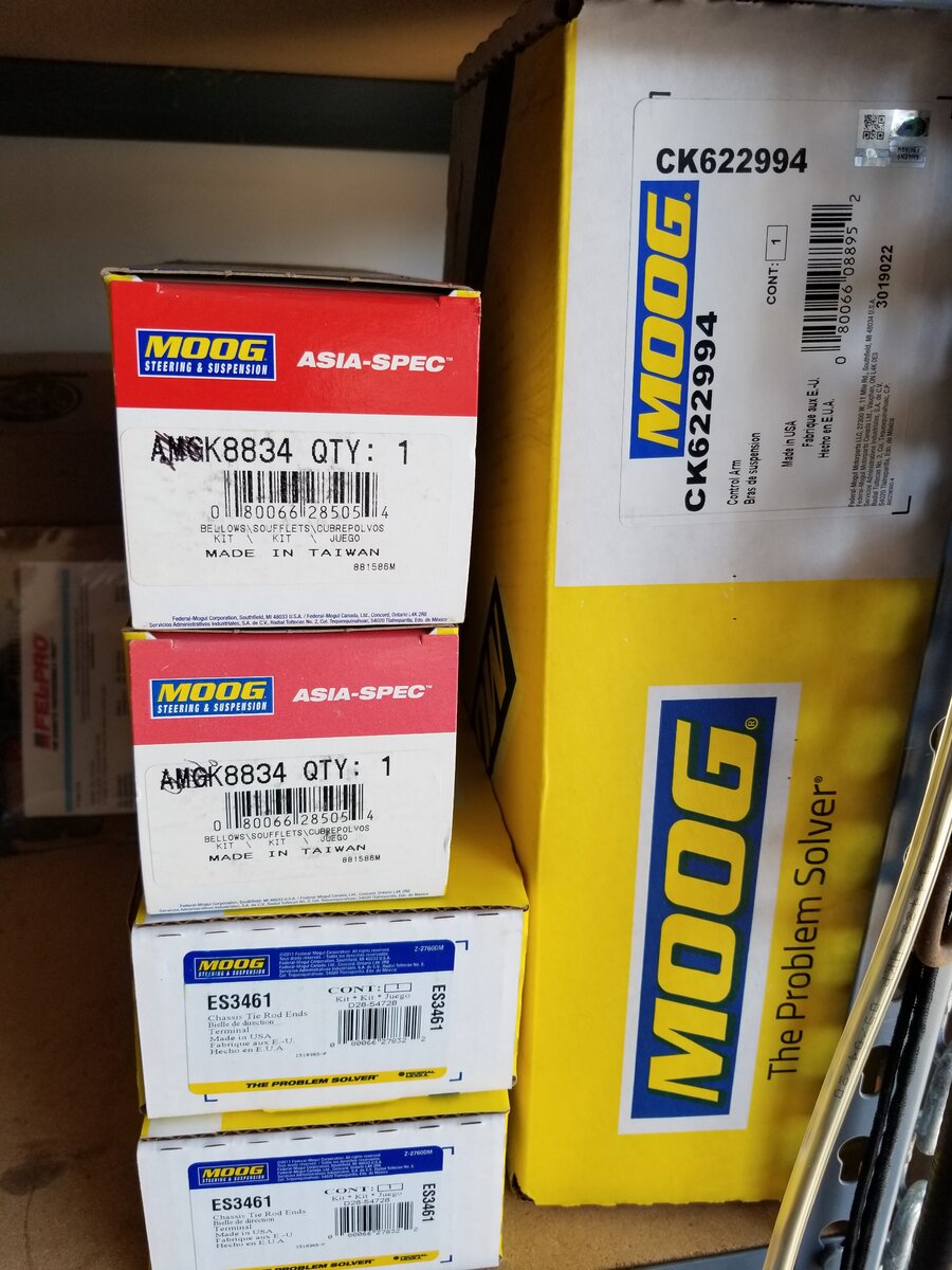

Lower ball joints, inner tie rods, and caster camber kits. Yes they are AC Delco, but I'm impressed and $15 per pair

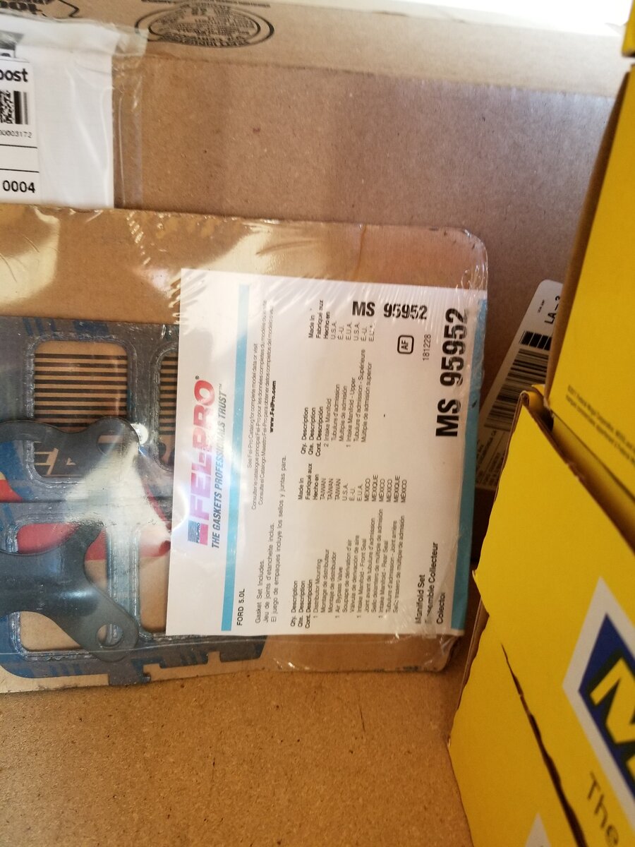

. Upper and lower intake gaskets. The box behind has right side cowl panel, the others side is on the way
Outer tie rod ends, steering rack bellows and one upper control arm.

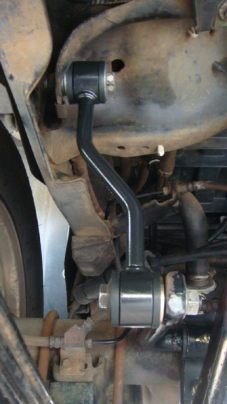

Thanks for the info Don, I'm actually going to use Prothane bushing in the front and rear suspension, plus the springs. I'll have to wait and see the rear sway bar angle after I replaced it and lower the rig.
https://www.amazon.com/dp/B000V53QBE/?tag=serious-20
I found this in other post and stated that it fits the explorer rear sway bar when lowered
Don, after lot's of trial and error, the Moog K80268 rear end links were the correct offset and almost perfect length for my 3 inch rear drop. However, the pressed in bushings must be removed and replaced. I used the poly flange bushings and sleeves from the ES 4.5153G kit. IIRC, the bushing halves and sleeves are sold separately.
