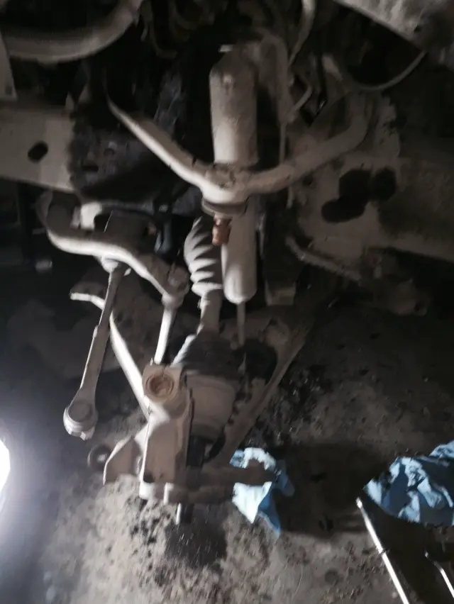

Dont worry I am having a good ol time on the driver side lower ball joint getting it free from the knuckle here is where I am at with the driver side but I should have everything back together by the end of the night or tomorrow
