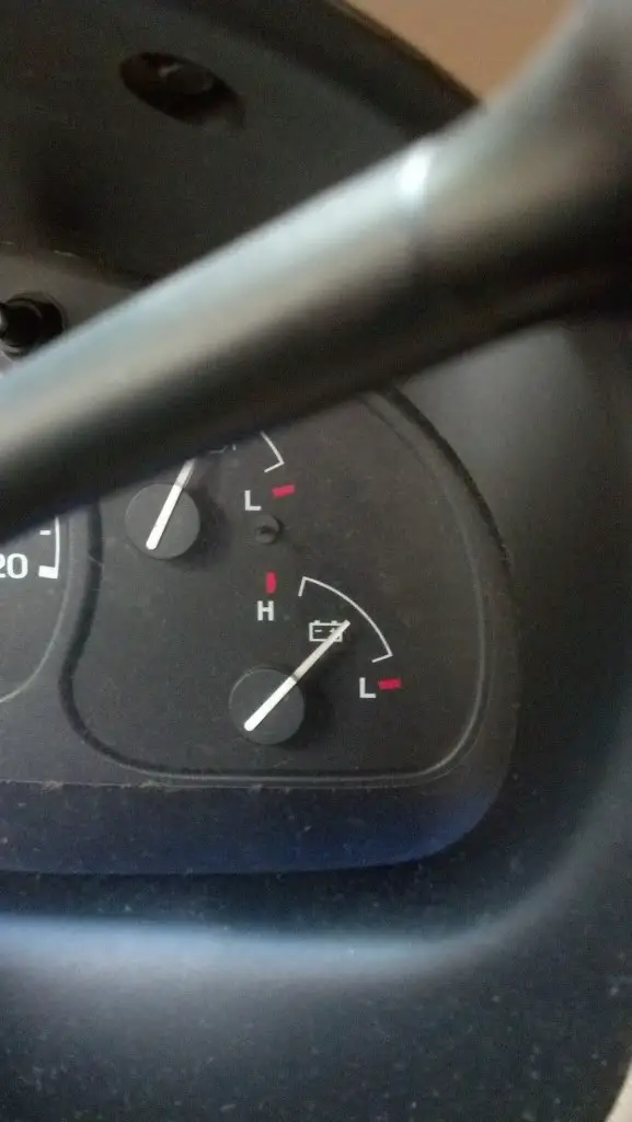

Next issue is the volt gauge. It was sitting a little on the low side. This last start up its just a hair below half way. The center console comp says charging is fine. Just didnt know where the guage usually stays in these

Volt gauge looks normal.
^^^what he said. you can always grab another cluster and try it in there. make sure its from a 97 and up however.
i agree the volt gauge looks normal to me. have you checked the voltage at the battery? with engine running should be 13.6-14+ volts. your weird symptoms remind me of a ground problem.

Ok... So I have a charging issue. Last night I was doing a coolant flush on it. I noticed the volt meter is only sitting about 1/4 way up the gauge while running with lights and radio on. Revs did not change this. Of course I didnt have my meter to see what was going on. I continued to finish the flush and went to move it and the battery was low, Wouldnt start... Had to throw my charger on it. I'll bring my meter home from work tonight to get some accurate numbers. Think the alternator has crapped out from sitting too?

Results from today= Cluster issues again... This thing is charging fine. 14.1-14.3 while running, Also left the meter on it for the night and watched it. No drop. So things seem ok. The battery in there is a good one, It was tested like 4 weeks ago.
