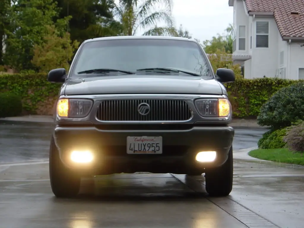

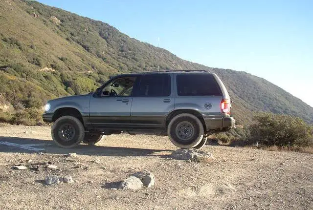

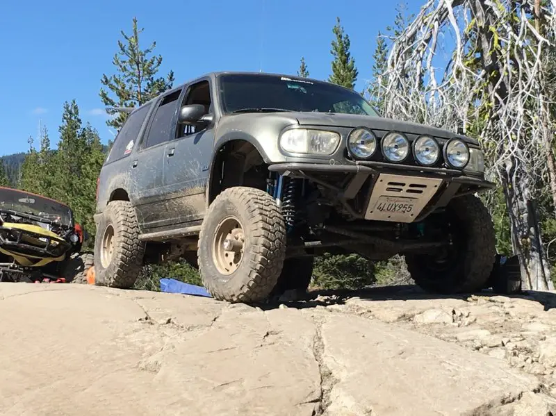

My pride and joy, the Mounty:
Video:
It's a 2000 Mercury Mountaineer. I acquired this fine vehicle in 2003 with just 32,410 miles on the ticker, and it was in pristine condition, having been driven by an elderly couple, and always serviced regularly at the same dealership it was delivered to from the factory.

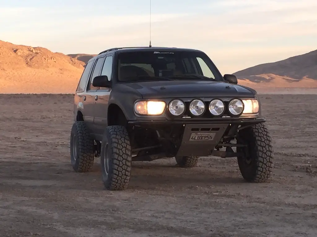

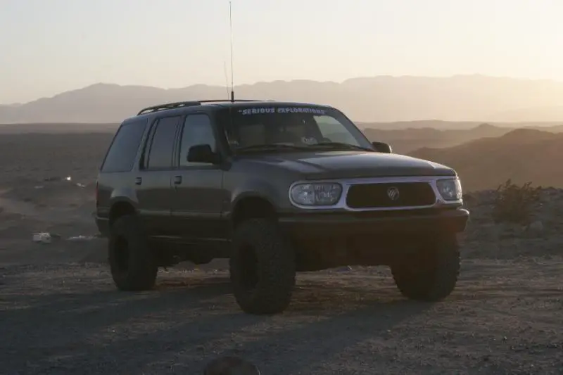

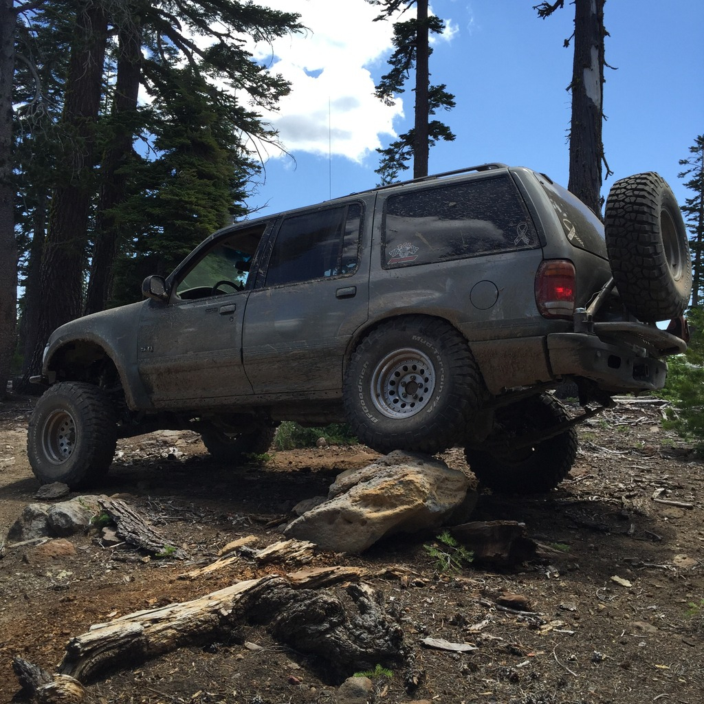

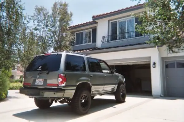

This thing has gone through a series of different suspension setups, but currently it has:
Solo Motorsports 4" extended D35 TTB with D44 outers, and custom radius arms
2.5x12" King coilovers with 2.5x12" secondary King reservoir shocks
4WD conversion with BW4406 manual transfer case
2.5x18" rear King shocks outboard of the frame
custom ordered Deaver leaf springs with 12" 2AM Fab shackles
Full-width 8.8 rear with stock disc brakes, Blue Torch Fab diff cover/truss
4.56 gears front and rear, lunchbox front locker, limited slip rear
roll cage through dash and firewall to engine cage
(previous front suspension setup)
Long Travel front end 5" wider per side with 2.5x8" Sway Away coilovers, Dixon Bros. shock hoops
2.0x2" King bumpstops
Full heim steering
3" Procomp lift spindles
homemade lower rear A-arm crossbrace, lower A-arm mount weld-washers, upper A-arm gussets
8" limit straps
removed swaybar
(performance)
MAC performance muffler with turn down tip
MAC performance intake
(exterior)
front bumper with removable light bar, with 4 Hella 4000 55w HID conversions
custom rear receiver and swing out spare tire carrier w/ gas can
clear corners
McNeil fiberglass fenders
removed running boards
5.0 emblems
color-matched grill surround with mesh grill
clear LED light in rear bumper
(random)
ABS defeat switch
Icom race radio
recovered center console in black
fog lamp-hi beam mod
added tie-downs in cargo area
rear hatch interior handle
4x4 Ranger front towhooks
driveshaft "loop"
COMING NEXT
3-link rear suspenion
add 2.5 or 3.0x18" King bypass shocks to the rear
switch front smooth body shocks for 2.5 or 3.0x12" King bypasses
rear fiberglass
35s

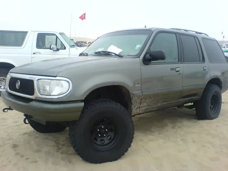

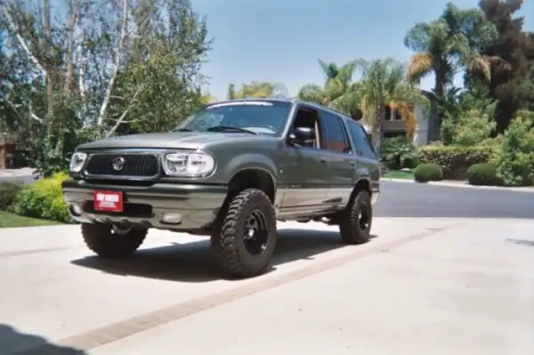

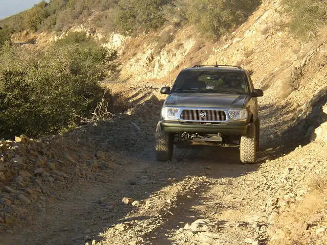

Newly lifted on 31 BFG M/Ts:

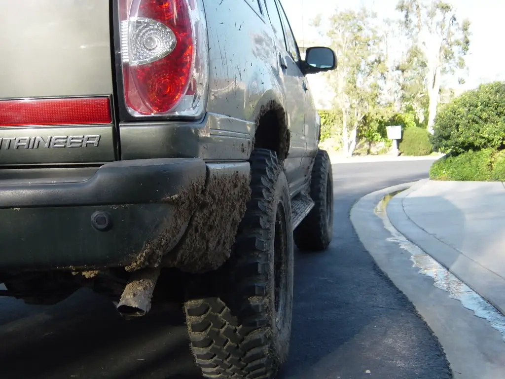

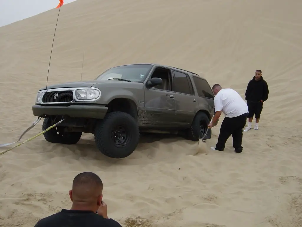

After its first offroading:

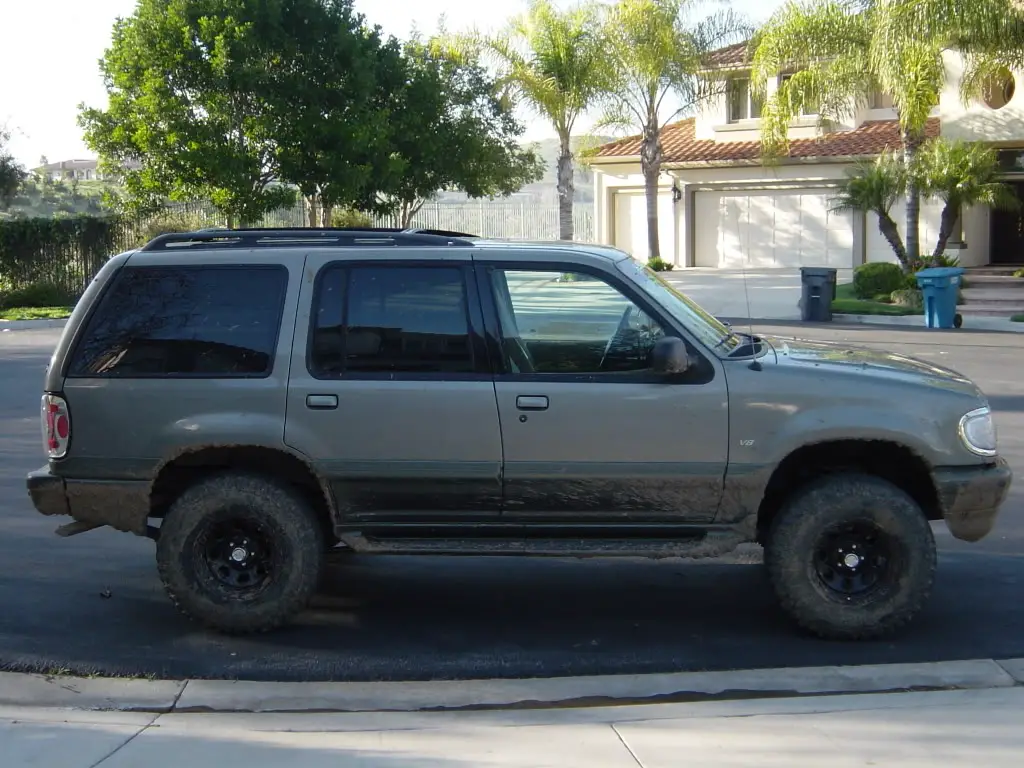

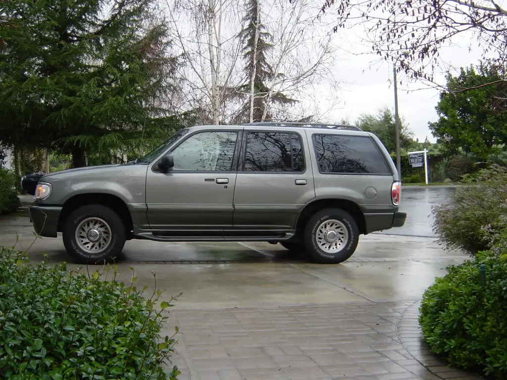

Almost stock:
That first picture is my favorite! Glad to see you finally got a registry started!
Nice! I hope to see it next time I'm out there!
Beautiful truck. :thumbsup:

Hey man, that first pic is sick. That is prob the nicest pic i have ever seen of ur truck, it looks professionally taken
Haha, it was professionally taken :) Care of exploderpilot. I really like it too, thanks.
