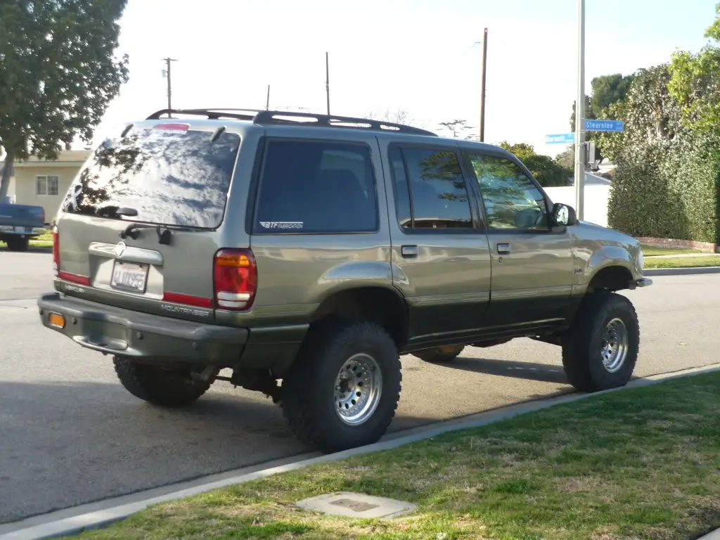

Newly lifted on 31 BFG M/Ts:

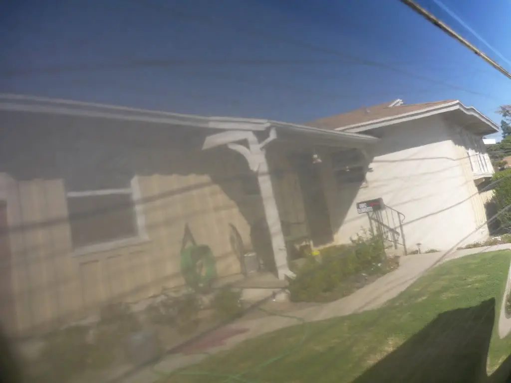

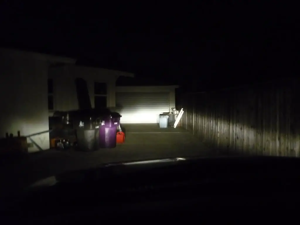

BrianDye, sorry it took me a while to get pictures for you, but here they are. You can see just how freaking bright these lights are. Too much for a street application in my opinion.
headlight
HID
headlight
HID
No prob man, but WOW! Those are awesome! But I fully agree, way to much light for what im looking for.

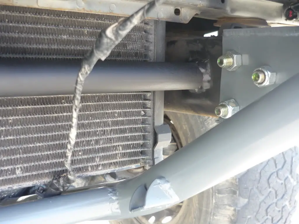

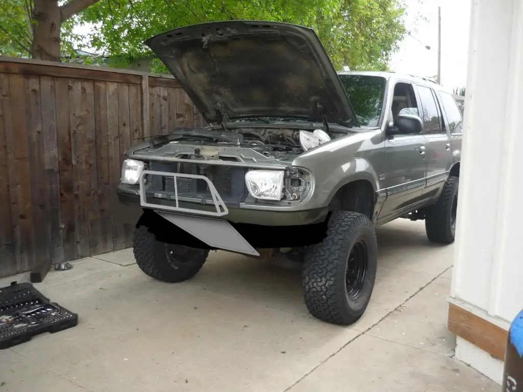

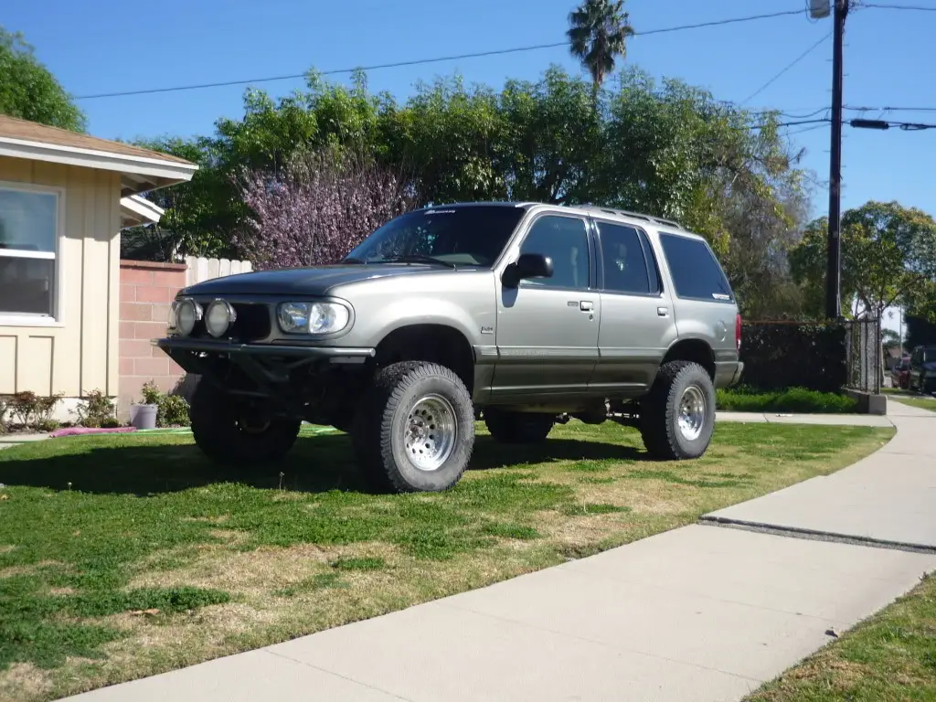

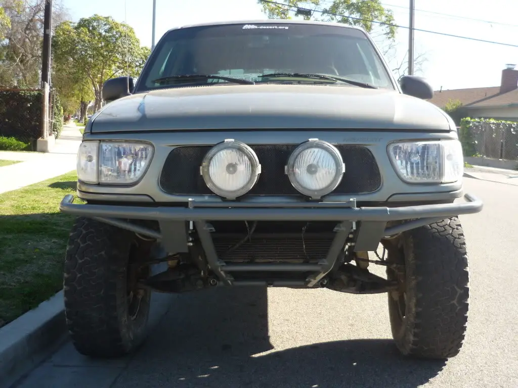

Aside from the aluminum skidplate, the bumper is done! I redid the light bar, made my own longer tabs for the lights so that they are behind the main tube, and moved them towards the center so I can get the bolts out without moving the lights. Also added a crossmember in front of the radiator because there's no crossmember at all in front of the engine, and a little mount for a flag when I go to Pismo or Glamis.
The color is a little bluer than I thought it would be, but I still think it looks pretty good.

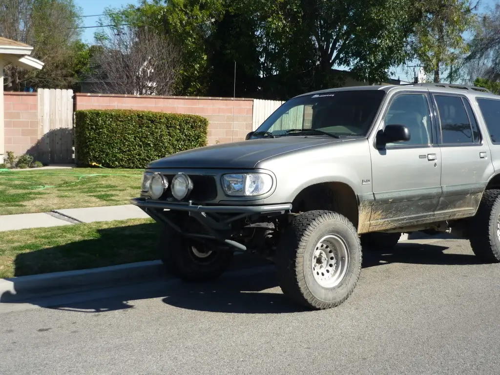

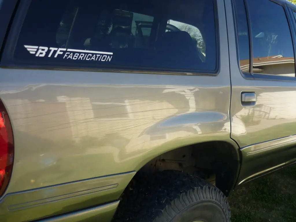

Went to Johnson Valley for King of the Hammers and had a great time, and I actually stayed true to my word and didn't beat on the truck too hard. But still I found some things that need to be addressed. My front shocks are toast so replacing those is a priority, and I need to find what's making a knocking sound in the front end everytime I go into a dip or step on the brakes. Today I finally decided it was time to give it a wash since i've gone probably 8 months without one and have 6 or 7 offroad trips worth of mud and dust and scratches inside and out. I realized that I probably shouldn't wait that long in between car washes anymore if I want to keep it looking pretty. The paint feels like sandpaper and there are water spots everywhere. I waxed the hood and most of the passenger side and it didn't really improve all that much. I'm thinking that sometime in the future I'll have it professionally detailed and try to have the paint restored.
Looking pretty after the wash
Custom pinstriping

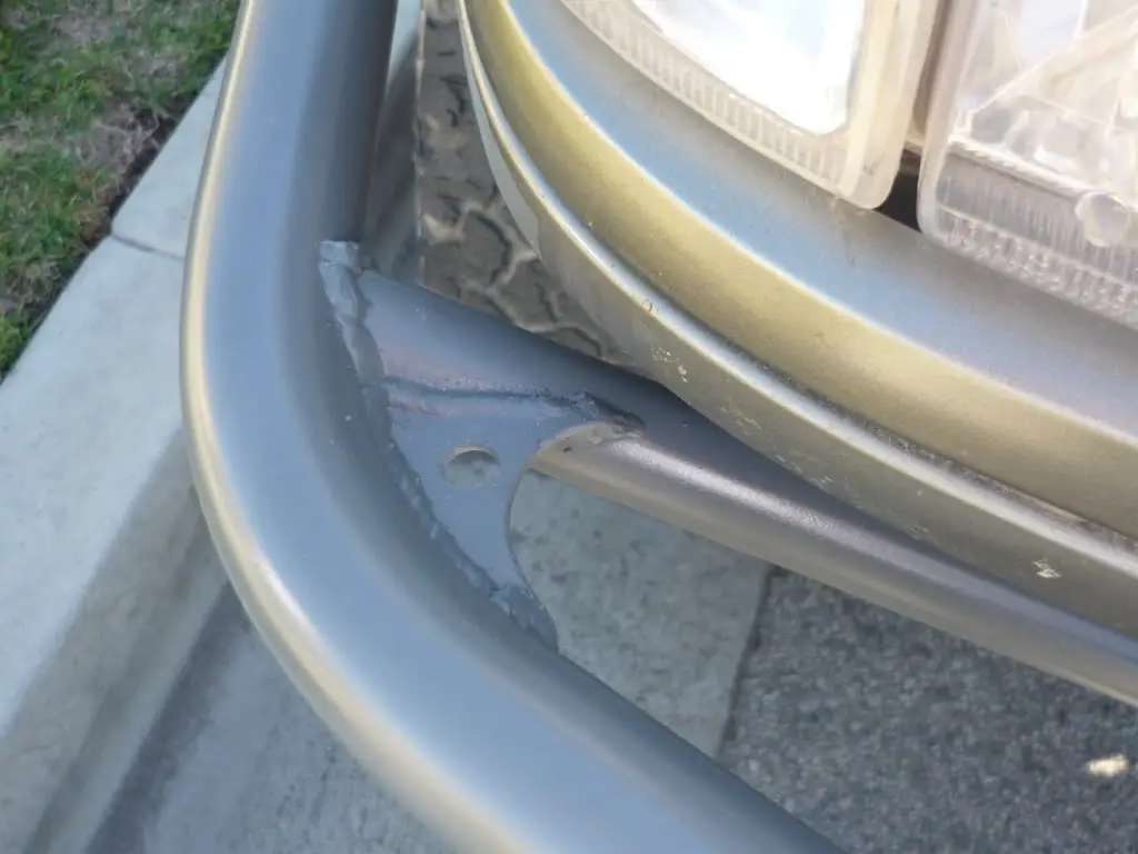

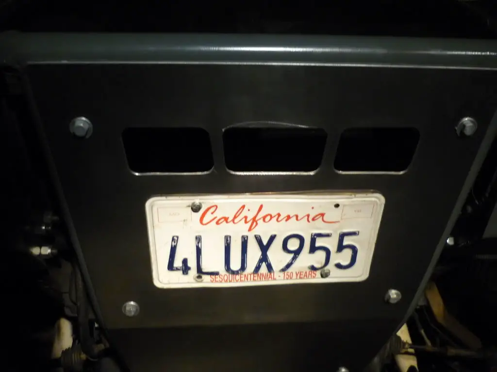

Finally got my skidplate done, it's 1/8" aluminum. The cutouts were done with a drill and jigsaw, and then I polished the whole thing. I still want to add the same mesh I have for my grill behind the cutouts. And eventually I want to sand it all down to get rid of the texture and scratches, and polish it to a mirror finish. And I also want to repaint the bumper either gloss black or the darker green on the lower portion of the rest of my truck. The paint on there now scratches way too easily.
Very, very nice mate, look's sweet as!!!
that is Hawt! d
Not to be a wet blanket here but how visible is the front plate from say 50ft away ?
Only asking this cause when i had my front plate mounted on the Skid Plate of "Big Red"
i was getting harrassed by the Cops claiming they could not see it. Hence why i hung it on the Main Tube.
I did take that into consideration and i'm hoping it won't be a problem. It's actually more visible from further away.

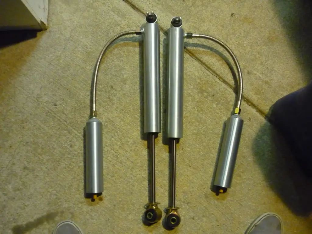

Well in my excitement on deciding to go long travel with my front end, I may have spoken too soon. Long travel is still definitely on my list of future mods, but it won't be for a little while. Probably not until I have a steady full-time job and maybe a second car (not a 2nd offroad toy, that was a big mistake haha). But I need new front shocks NOW, I'm tired of bouncing off of my bumpstops offroad and driving on the freeway can be sketchy at times.
So I bought these off my roommate for $70. We both totally forgot he even had them packed away in the garage, but they're brand new never used 2.0x8" Procomps. Don't know much about them so valving them in the future might be a little more difficult, but they will be much better than what I have now. So as soon as I get a chance I'll be cutting off my stock shock mount and building new ones.
Almost done with school, just one more week! So i'll be doing some work on the truck soon. So I want some opinions. I've been thinking about doing another NEW front bumper on my truck and selling the one I built since I can just unbolt it and put it on another truck.
What do you guys think of something like this? Reusing the original bumper but tucking it up real close to the body and just doing a real simple skidplate hidden behind/below the stock bumper? And have a bolt on lightbar still. The goal is to have a pretty stock looking front end, but still unique and very clean looking. Not that I need more projects to do...
..I really like your current bumper..
..Keep it and you can still dabble on making other custom bumpers..Make a couple more like yours and sell them so you have money to fabricate other new ideas..:biggthump
