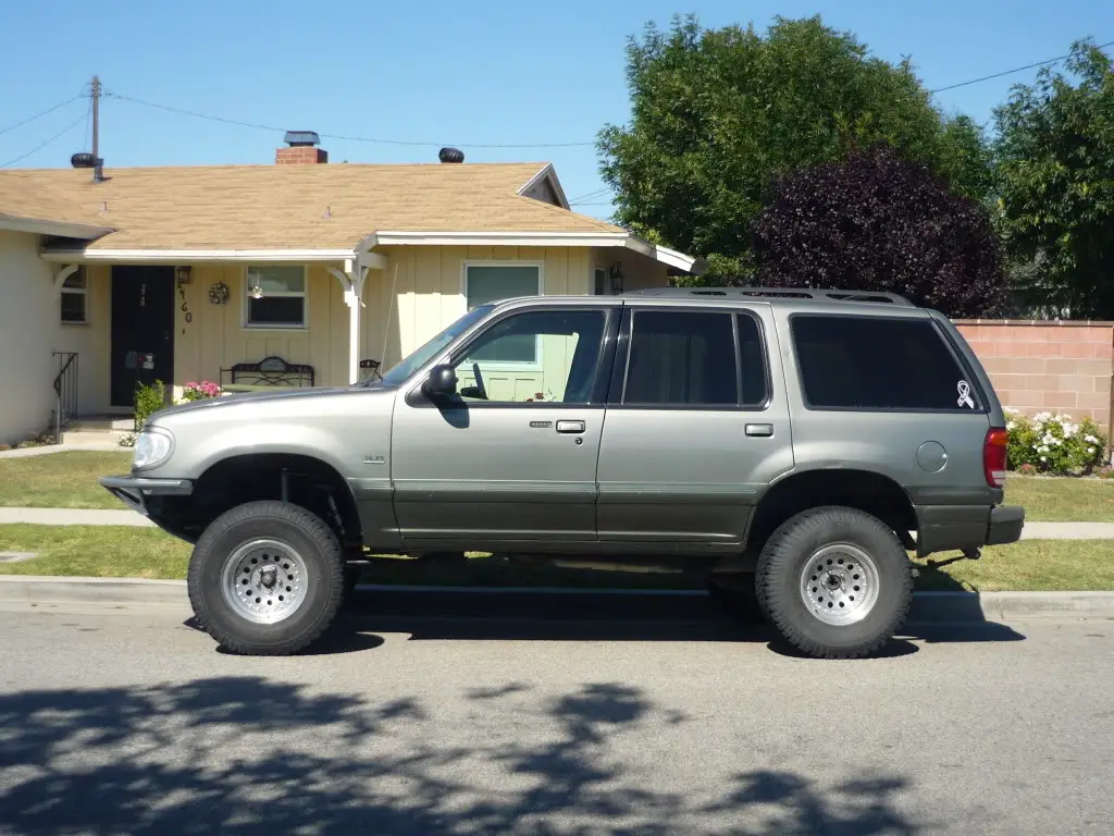

It's a 2000 Mercury Mountaineer. I acquired this fine vehicle in 2003 with just 32,410 miles on the ticker, and it was in pristine condition, having been driven by an elderly couple, and always serviced regularly at the same dealership it was delivered to from the factory.

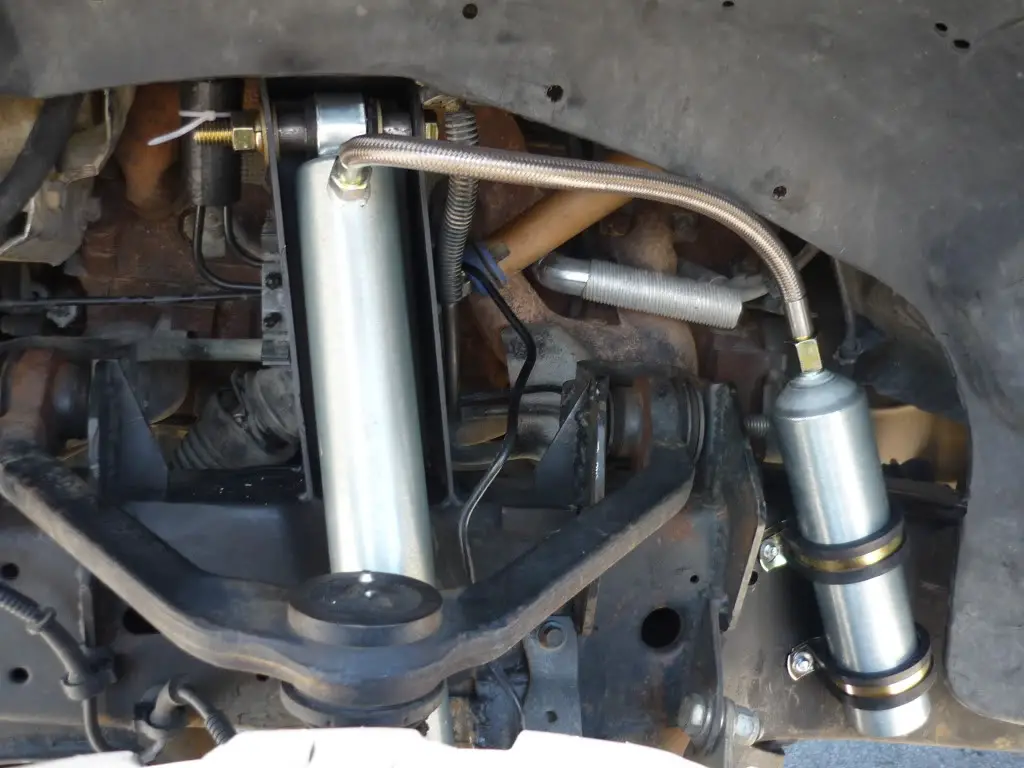

Switched out the other torsion bar yesterday and I got a little bit more lift out of them, and I can feel the difference in stiffness driving around. I forgot to take pictures until the very end today, but the shock mounts are ready to be welded onto the frame tomorrow. Here they are after paint.
And the welding. Not my prettiest.
Tomorrow I have to figure out where the shock reservoirs are going, and weld tabs onto the lower arms to mount the shocks. And then it's time to test it at our local jump. :) Maybe.

Once they're on, the back will be hard to get to for paint.

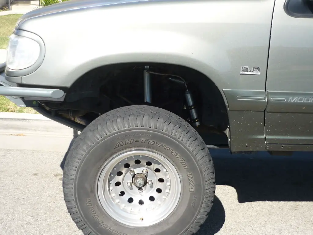

Got the front end done today, and I love it. It's so much better with the new torsions and shocks. Hit some big dips with some speed around my house and the front feels great. The back feels like it could use some valving adjustments though.
And the front sits perfectly now compared to the back.

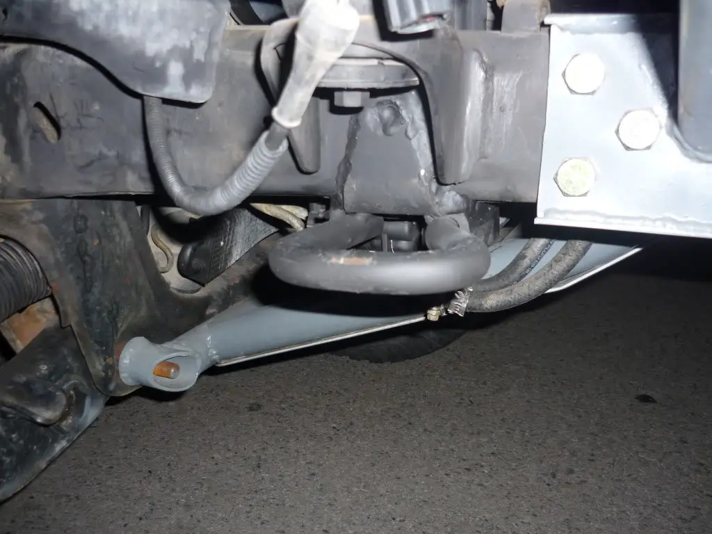

Still have to get tow hooks on and make a driveshaft loop this week before heading to Pismo Friday night.
My roommate welded these 4x4 Ranger tow hooks on today, one on either side in front.

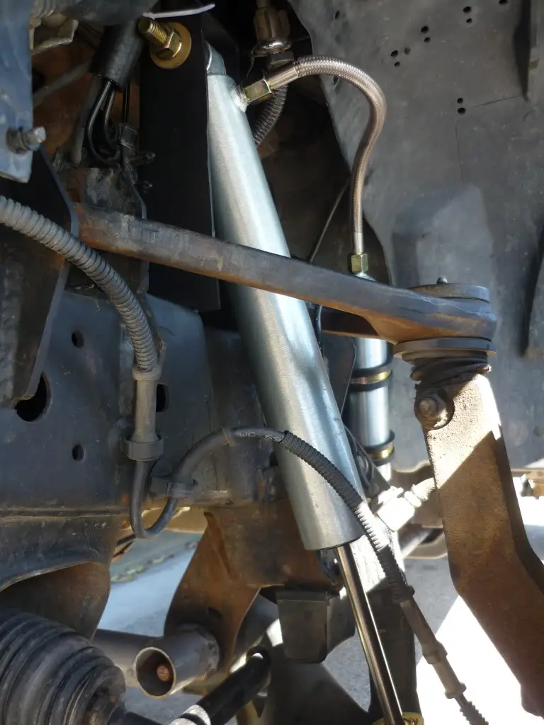

Truck did pretty well in Pismo this weekend. Front shocks make such a huge difference, but I think they can still be a little stiffer on compression because it still was on the bumpstops more than I'd like. I'll see how it does in the desert first though. I need to put in a 90* fitting for the reservoir hoses because on the passenger side the upper BJ hits the hose and crushed it a little bit, it's not completely crushed though.
The new tow hooks held up great too. Pulled my friend out once, and then he pulled me once. Didn't get any pictures all weekend unfortunately.

Got some 90* fittings for my front shock reservoir hoses. I'm hoping they give enough clearance now though, otherwise I'll have bigger problems than a crushed hose. And I have weld-on reservoir mounts ordered too. The ones that came with the shocks are crap.
