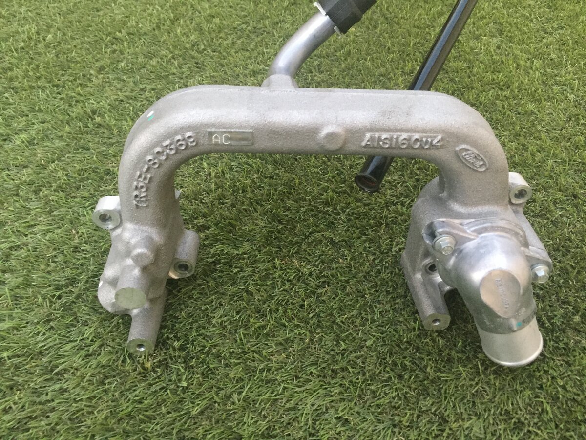

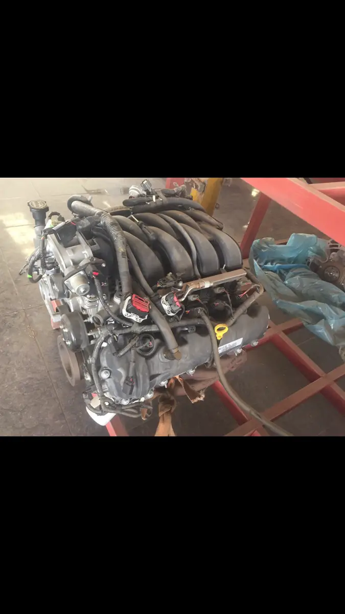

Ford Mustang 4.6L 8 cylinders 3V SOHC complete engine of unknown model year (with crossover water inlet No 7R3E-8C369, made me think it’s a 2010, but not sure) was swapped into Ford Explorer 2006 4.6L 8 cylinders 3V SOHC, with 6R60 transmission. The two engine looked the same. Differences noticed during swapping:

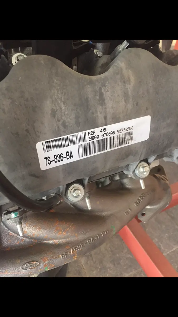

How to know the engine year model? Would using the serial number on the engine sticker help?
The old engine block start with 3L, new one start with 6L. Any difference? Any significant here?
- Intake manifold and throttle
- Wiring harnesses
- Engine oil pan
- Engine oil dipstick
- Exhaust manifold
- Water pump & water crossover inlets
- Radiator hoses
- Knock sensors were canceled (not present in Ford Explorer.
- Flywheel, used the old one
Everything went smooth, until two days later:
- Deceleration noise appeared after warmups
- Screeching/grinding/squalling noise with a little rattling sound
- Occur every time a RPM is slowing down (ex; release gas pedal, transmission upshift lead to RPM drop & then this noise,...).
- The noise is hard to localize by stethoscope, coming from front engine, intake manifold & valve cover.
- Over the the following few weeks, the noises is getting louder. I could hear it when driving slowly, when engine is not on load, but mainly during decelerations.
