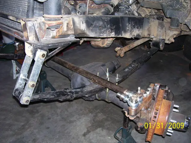

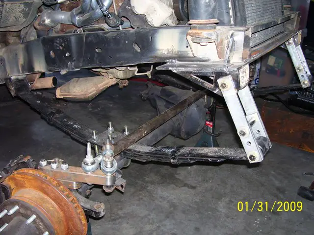

OK I got the front mount plate moved back, welded and braced.
I think the angle is fine., and I finally got to put it down on it's own weight.
On to the winch plate!

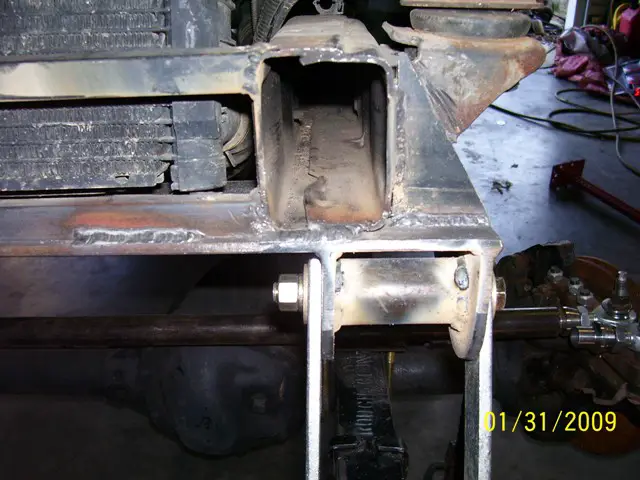

Here's the beginnings of the winch plate, I've got to trim it down and shape it a bit, then weld it on and build the bumper from there.
But the front is all but done. Got a few more braces to build but for the most part its good to go.
