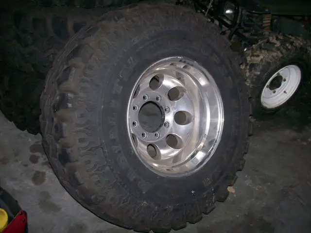

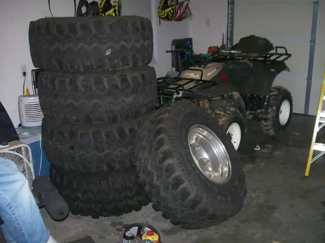

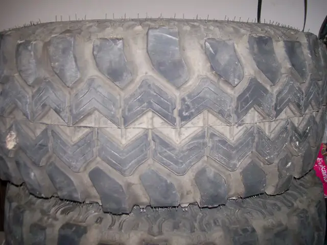

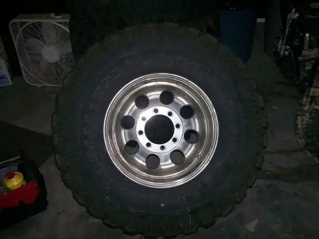

Tire PICS
As promised, If a bit late...
They are 35X14X16.5 Super Swamper SSR Radials on Mickey Thompson 12" Aluminum rims.
Ive had them on the truck but wasnt able to get pics since it started raining and hasnt quit for 2 weeks while I've been home.
I CANT WAIT!!!!!
