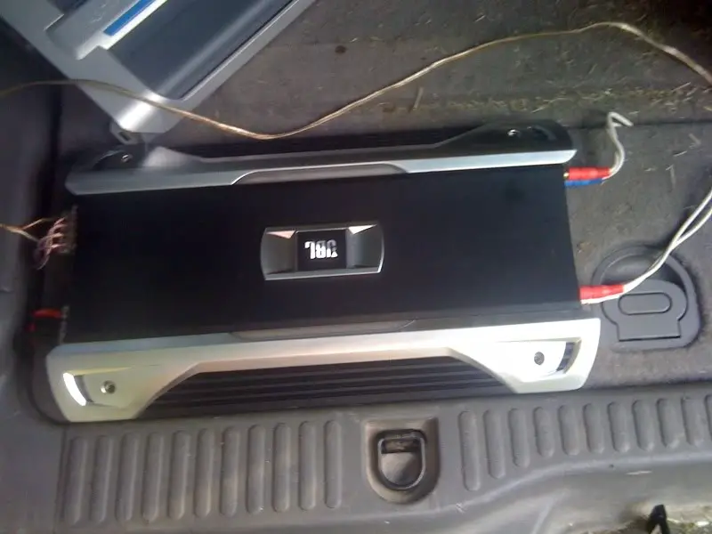

Edit: installed an amp for the door speakers today. Pics coming soon, when I have the time and patience.
Edit2: Installed better amp, Added in sub for temp use, took crappy cell phone pics.

Hi. Can you please send pictures especially vacuum hose location and IAC. Thanks

New pics up!
