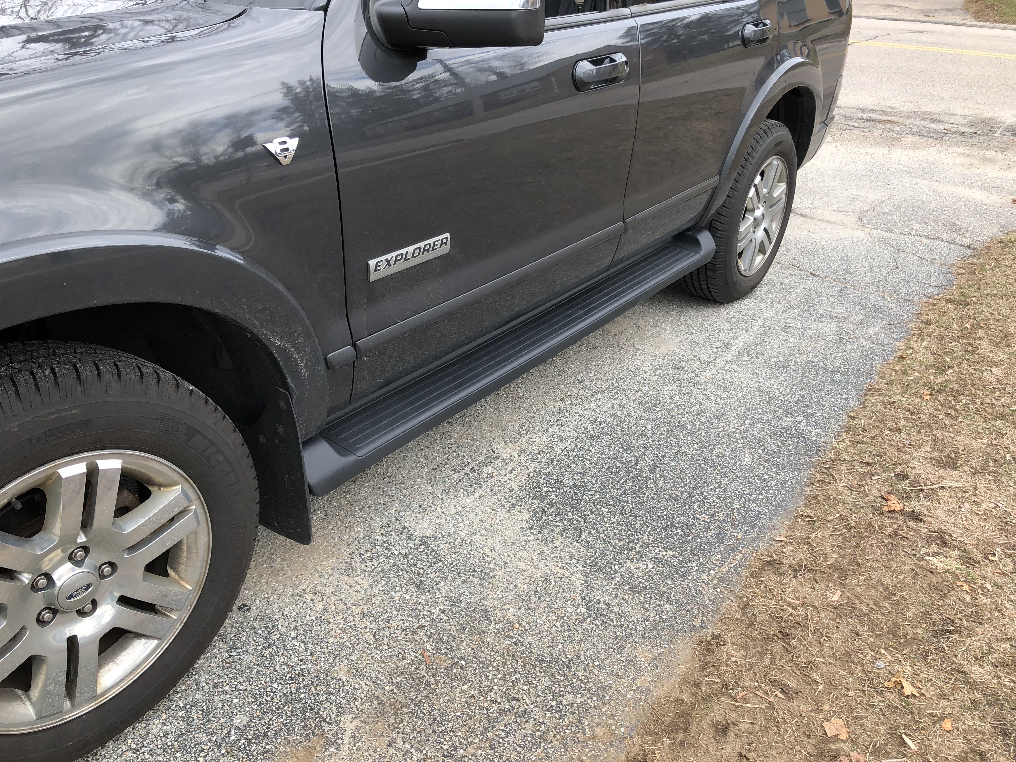

We had a unseasonably warm day today, so I changed the running boards/side steps on my (wife’s) Explorer. She didn’t like the ones that came on it from the factory...remember the ones I re-painted?...
(can’t wait to put those summer wheels back on)
...and since it’s pretty much her vehicle now, I wanted to make sure she’s happy with it...since I’m driving a brand new F-150!
...with the ‘new’ factory running board...
I still have a bunch of parts to swap on this vehicle...stay tuned!
If I were to remove that style of running board on my 4th gen and install the tube style bars should I assume the mounts will line up?
