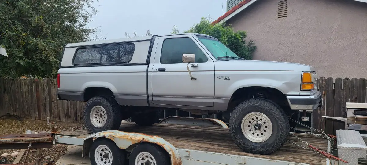

I picked up this 1991 Ranger a few days ago to become my daily driver and who knows maybe a few small off road mods. It is a 1991 4wd XLT standard cab long bed with 122k miles. Powering it is a 4.0 5 speed manual and an electric shift tcase.

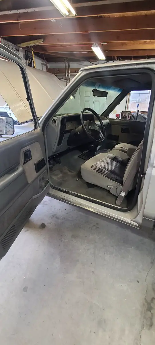

Inside is a near perfect 60/40 bench zero cracks in the dash and a perfect headliner. Also it has AC, cruise, power windows and locks.
The previous owner installed a 4 inch rough country lift and 32" tires but the factory 3.55 gears remain.
The truck does need some work. There were a few vacume leaks I already fixed under the hood. The rear main seal is leaking pretty bad and needs to be replaced soon. There is no muffler or exhaust behind the new cats the PO installed. It currently won't pass smog so I need to solve that before I can start driving it as well.
