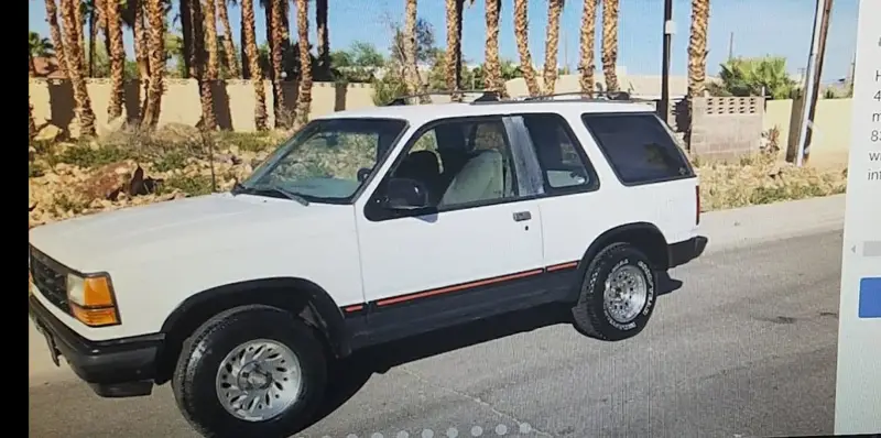

After seeing the latest post I thought Id start 92 build as well. Picked this up a couple months ago and waiting on money to get parts in hand. Have parts and starting build.
1992 Explorer Sport

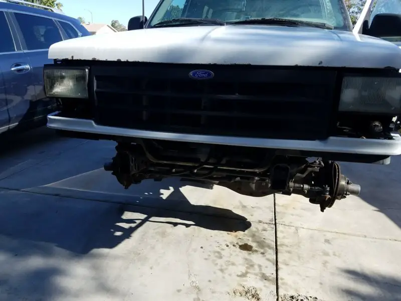

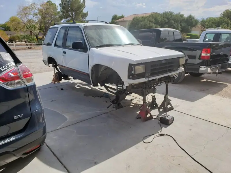

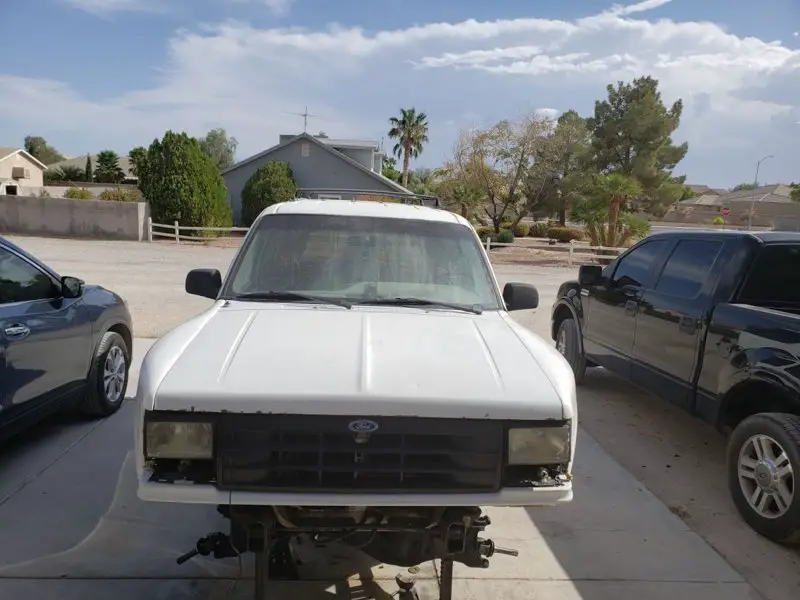

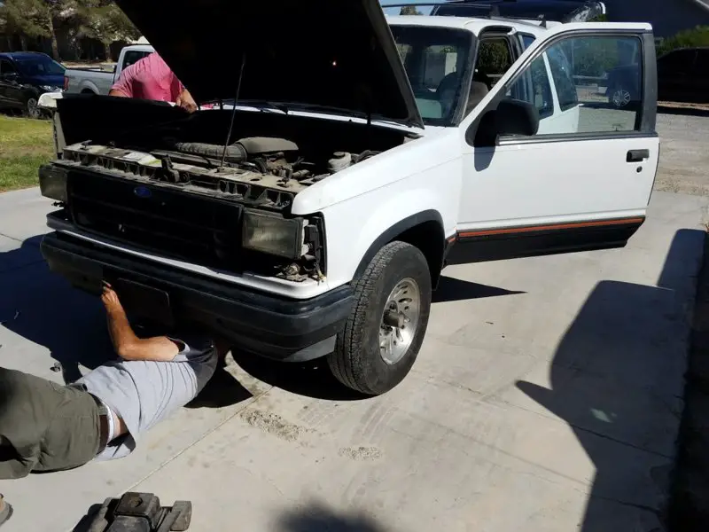

Drove this gem home and started tearing down.

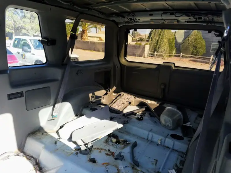

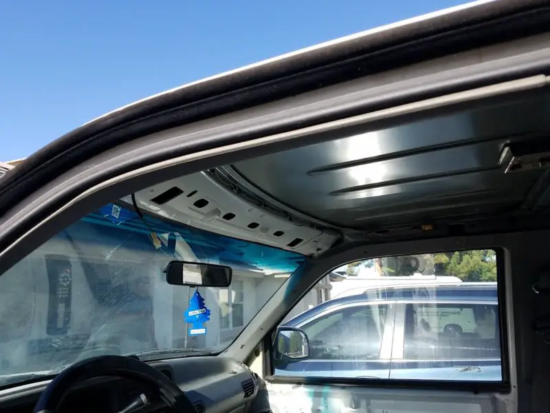

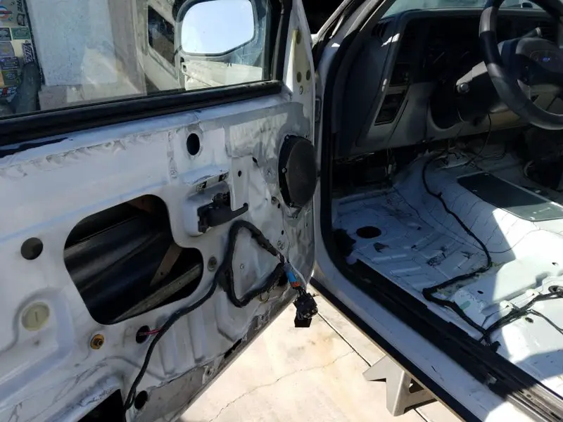

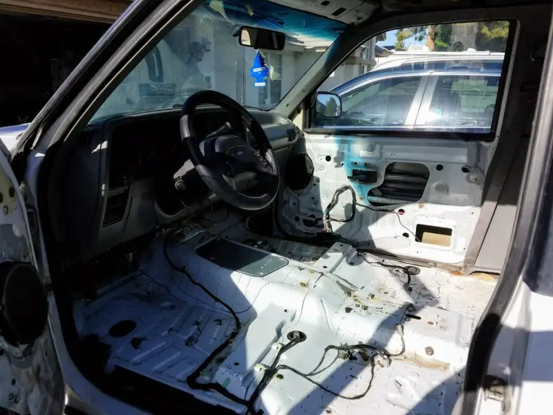

4wd motor not working but all else seamed ok. Interior pretty trashed so it got deleted.

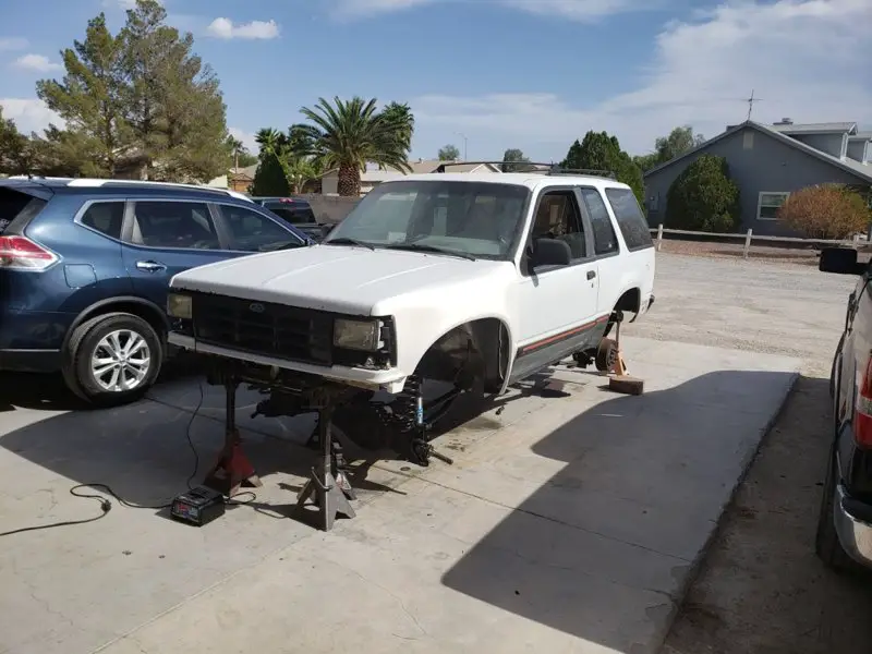

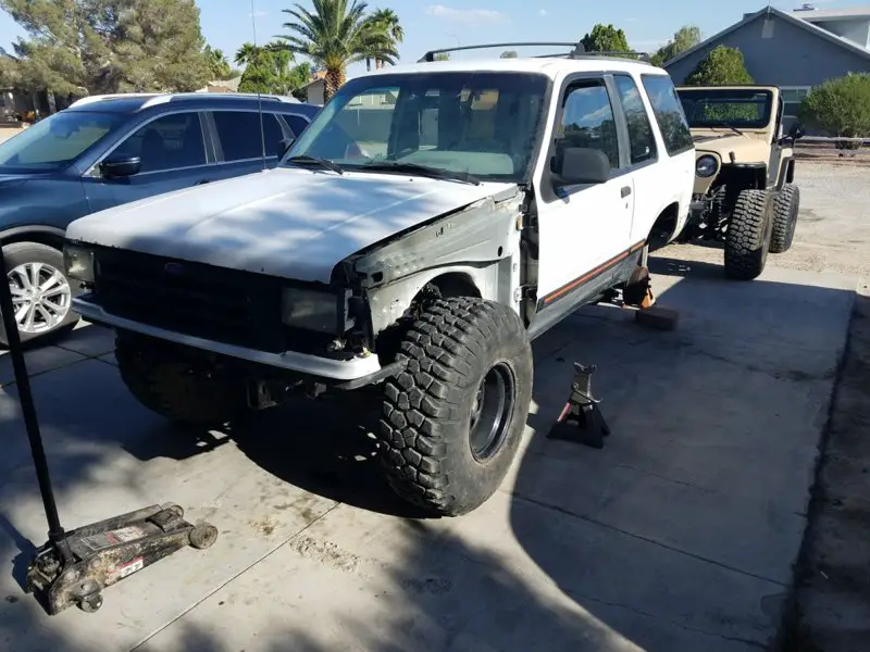

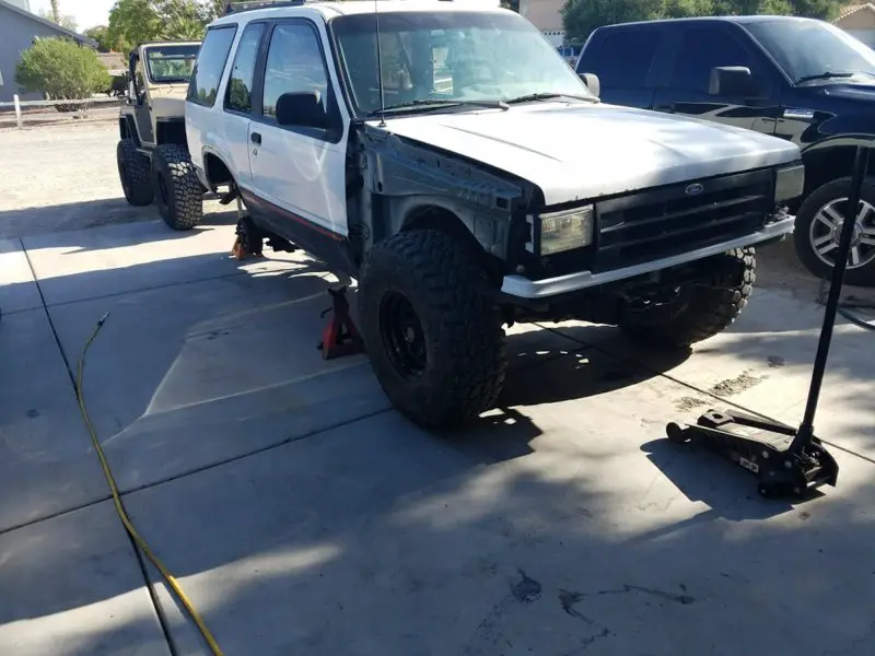

test fit 35s before lift to check bump clearances.

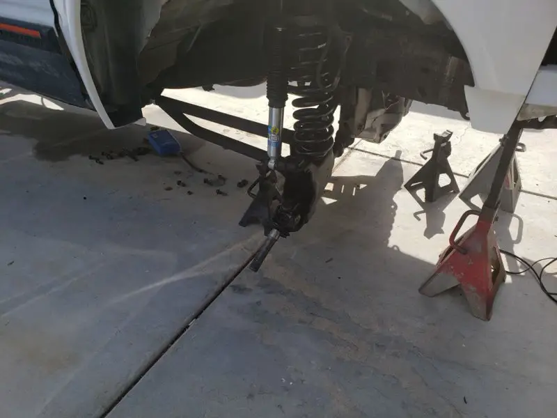

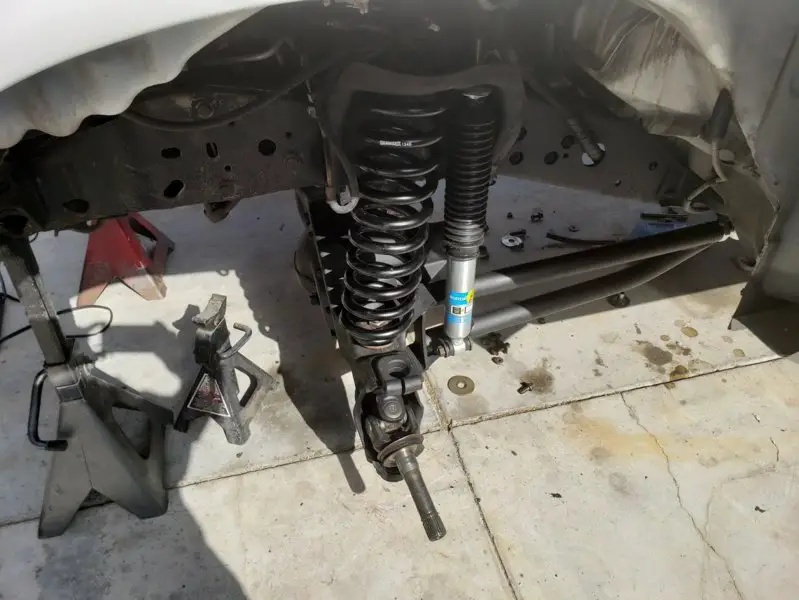

Start rebuild Solo 4" lift with 15" travel. Gears and trac lock in front end. New ball joints and wheel bearings should arrive today so hopefully that will be installed tonight
crashhard
May 15, 2018
125
80
Las Vegas
1992 Explorer Sport 4x4
Have deavers sitting in garage and ready to install those this week as well.

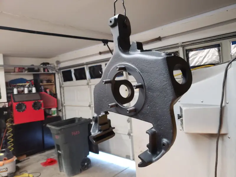

Did finish sand blasting spindles and paint. I hate the waiting

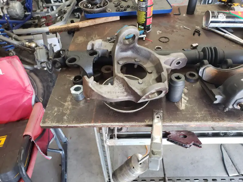

Tires showed but spindle going on cut & turned beams is not working out. I don't know if something is off with lower ball joint not seating all the way or hardly at all.
Pulled new ball joints out and pressed original ball joints in and same issue.

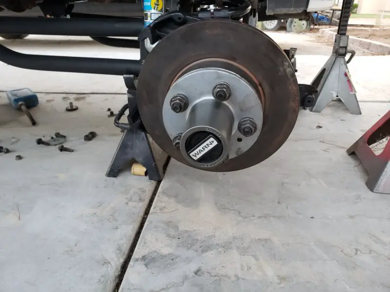

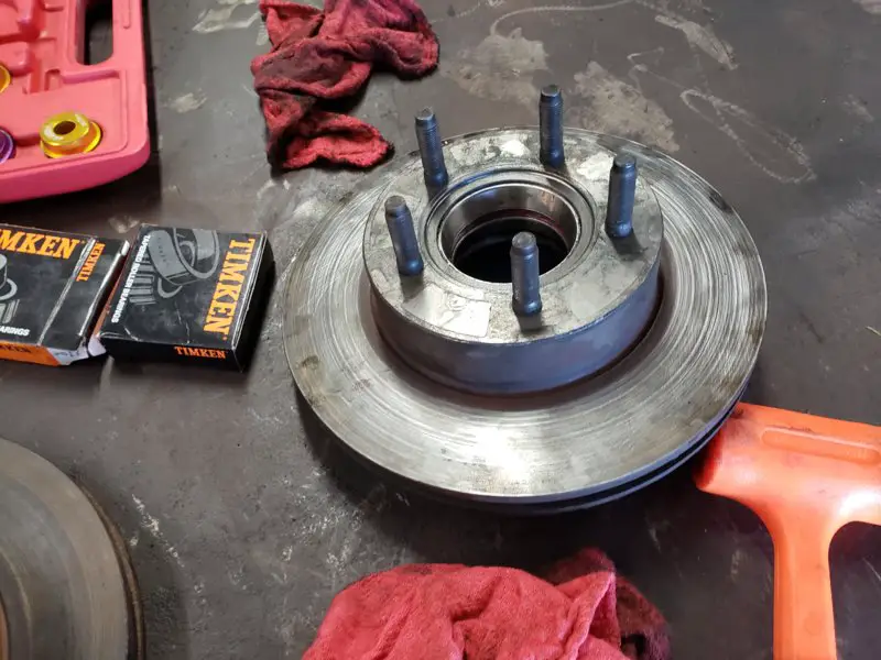

New bearings in
Swaped auto hubs to manuel.

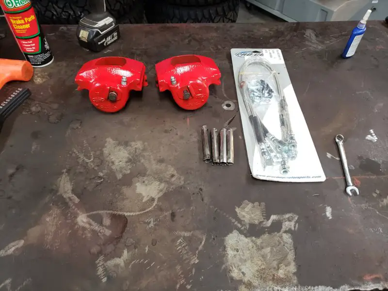

Brakes and new lines are ready to go.
Picking up pads first thing in morning

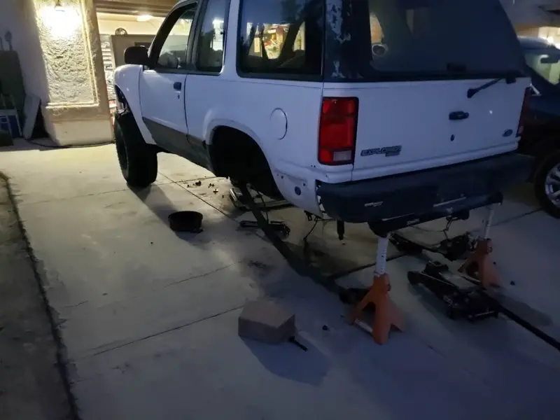

front end 100% and sitting on ground. Rear end pulled out.
