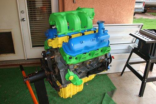

To go under the truck and look for these...Look in the side of the block for the round brass discs that are in the blocks above...You also have freeze plugs in the heads as well..
Can you tell what area of the engine the coolant is running down from?
