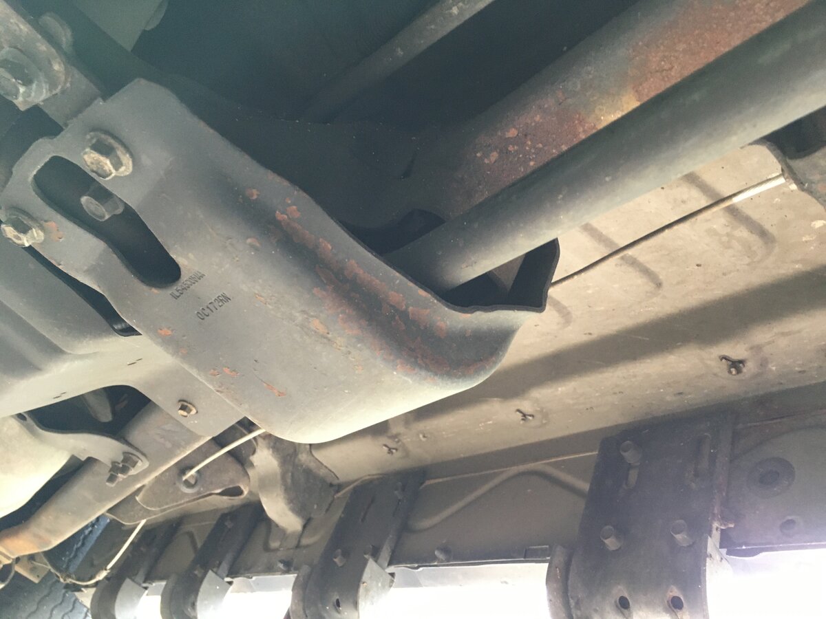

I wanted to show how good the rocker panels were on this vehicle. Even the frame is still mostly black.
Anybody selling a second gen Explorer should post pictures like this one, then our time would not be wasted going to look at them just to find they are rust buckets.

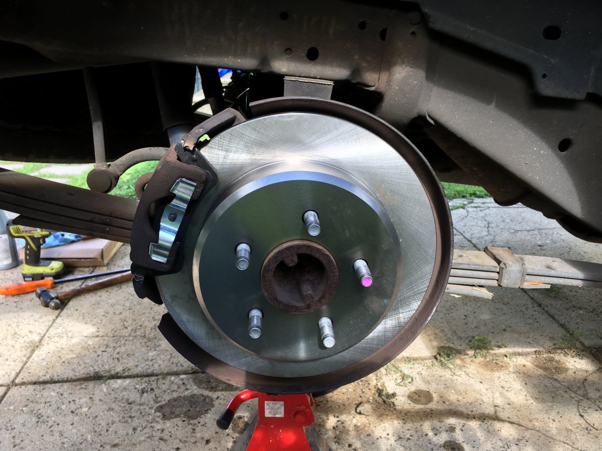

The parking brake didn't work.
I replaced the parking brake cables, parking brake shoes with spring kit, axle seals, pinion seal, differential cover, rear rotors, Rear Brake Pads, and the passenger side rear caliper bracket because one of the caliper bolt holes was stripped out.
Parking Brake Cables:
The old
The new
Rear Brake Shoes, spring kit, and axle seal done
Rear rotors and pads done.

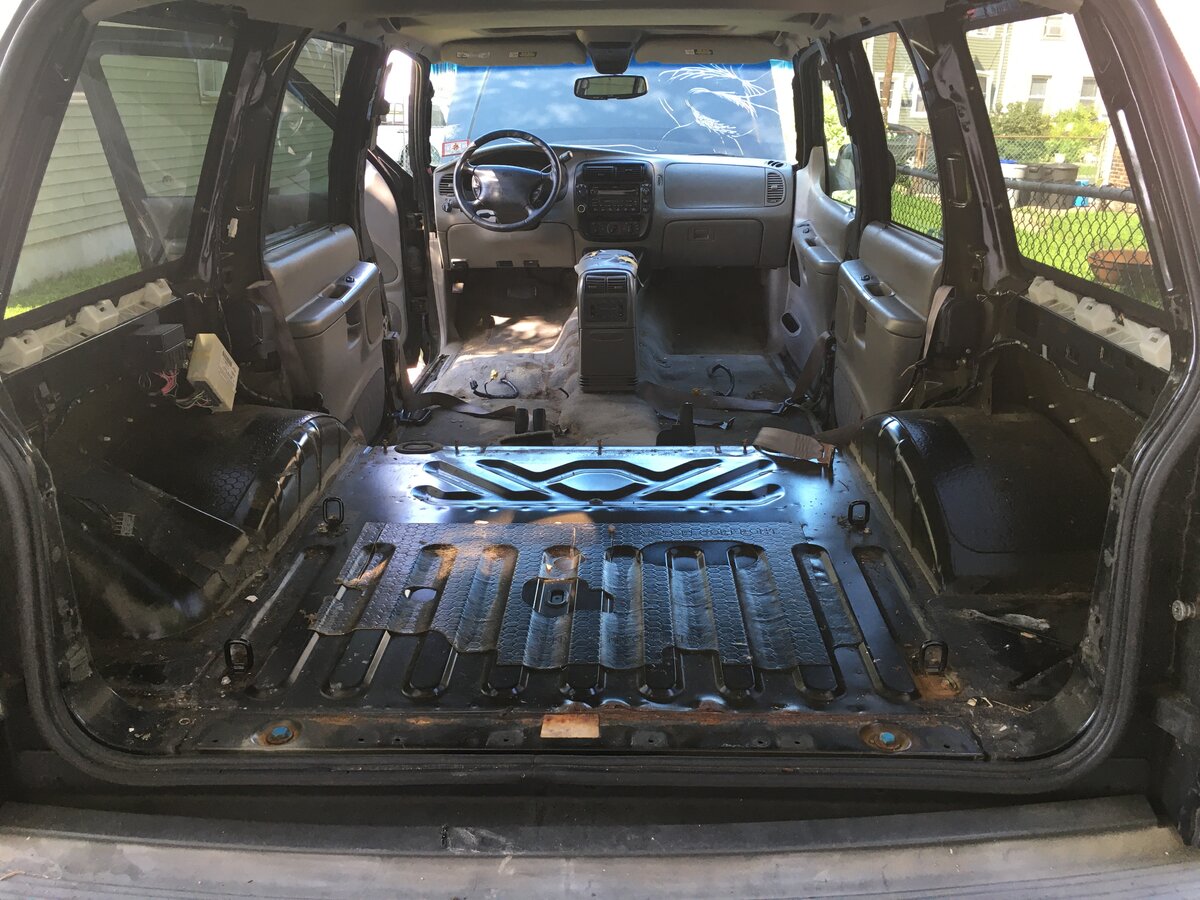

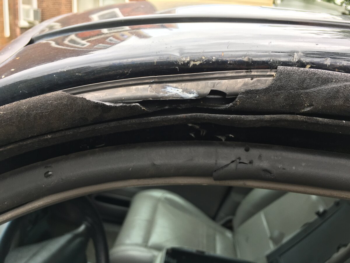

The moonroof is leaking so water is getting into the headliner and carpet. The windshield is also cracked pretty bad.
The driver seat is torn up and so is the center console arm rest. I will probably have Safelight Auto glass come out to my house to replace the windshield. I installed the seats, carpet, door panels, and center console arm rest from my 98 4 door, into this truck.
Update: added "after" pictures.

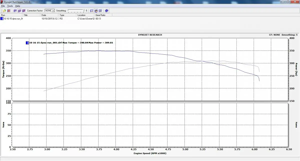

Wouldn't the OHV version be a better "long term" engine compared to the SOHC and the constant guide/tensioner issues?
I have a 96 OHV and I have driven a 98 SOHC version and I must say I prefer the midrange torque of the OHV in almost every way except for on-ramp runs (in those situations the higher-freer revving of the SOHC is more "carlike"). Honestly, in highway passing and everything else I find the OHV version to be plenty. On the highway the part throttle acceleration of the OHV is even better than the SOHC until it downshifts. Once you get higher in the revs the SOHC has more power. But in the midrange the OHV has a LOT more torque.
This analysis is straight on. There is a torque curve comparing the two. The OHV peaks a bit higher in torque at 2400 RPM. The curve looks more like a diesel. The HP at higher RPM :lol:.Lets not go there.

I can not view the picture posted above by 96eb96 but I am guessing it is a graph on how the two 4.0's look together.
