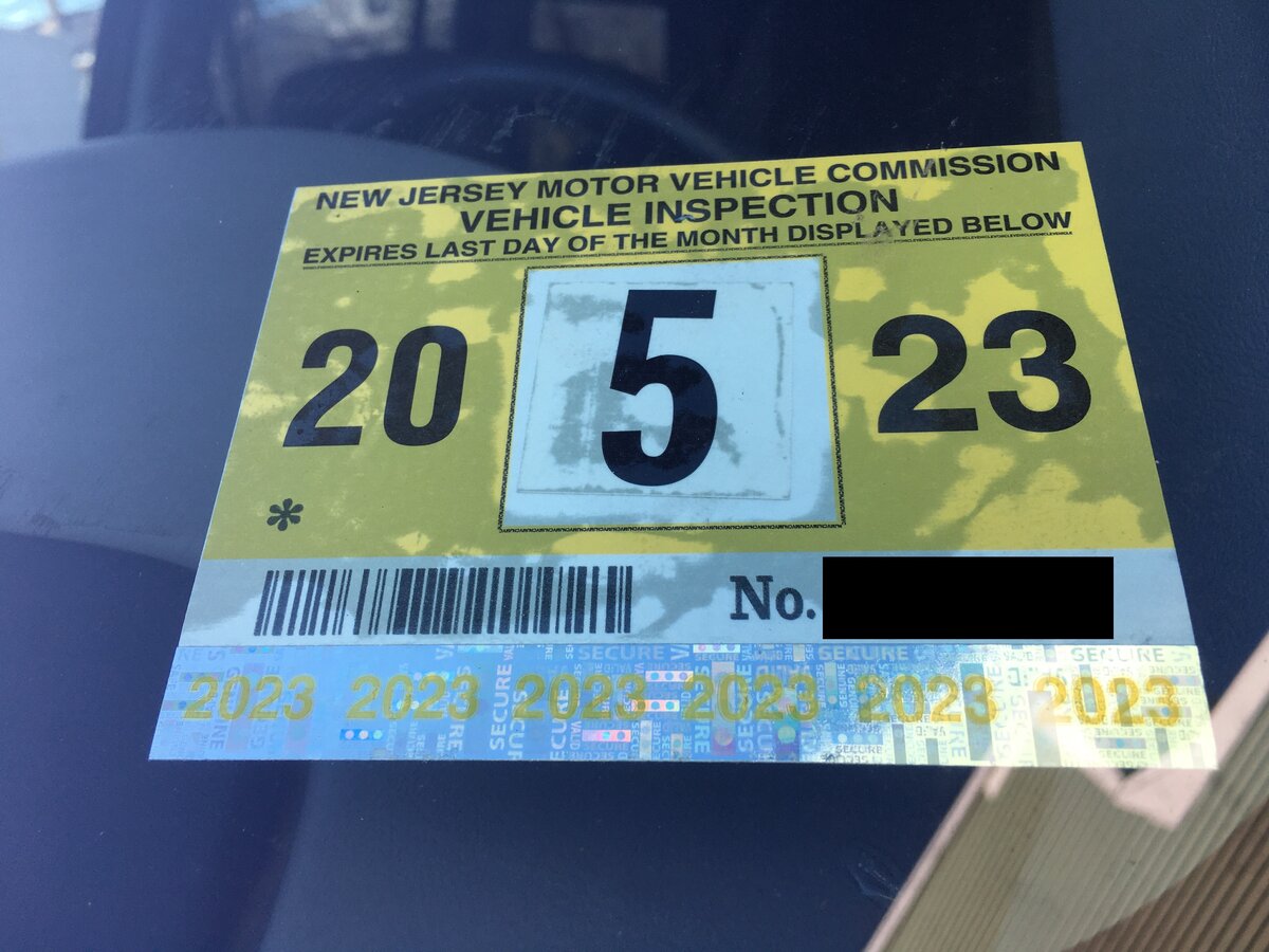

Yesterday on 04-03-2021 this 2000 Explorer passed state inspection.
I was surprised because someone had changed the engine in this thing from a 4.0 SOHC to the 4.0 OHV engine, and I ended up having to buy a used PCM off eBay for the OHV engine so it would run correctly. The used PCM has a different vin number since it is from another vehicle and the eighth vin which designates the engine is a X(OHV 4.0) instead of an E (SOHC 4.0) now.
I checked and all the monitors were ready and there were no codes.
When I first put this PCM in and drove it I ended up with a P0420 code, I thought the cats may have been damaged but I just cleared the codes and drove it until now and the code never came back. It is possible that the cat was "fouled" or coated with carbon which could have been blocking it from working and after driving it longer with the engine running correctly that it cleared up.
I may swap back to the original SOHC setup if I can find a donor 2000 4 door, but I am in no hurry.

I don't think trucks this old store the VIN In the PCM. And I think you can have 2 monitors fail and it will pass. (98 could be 1, not sure).
And NJ don't care about any safety stuff either, and a 2 year sticker :lol:. NY checks safety and emissions every year. Some places will test your parking brake to failure by hitting the gas.
2000 explorer PCM's(and 1998's) do store the vin in the PCM, it is referred to as the VID block.
The monitors cant fail, but they can be not ready which means they have not run yet.
