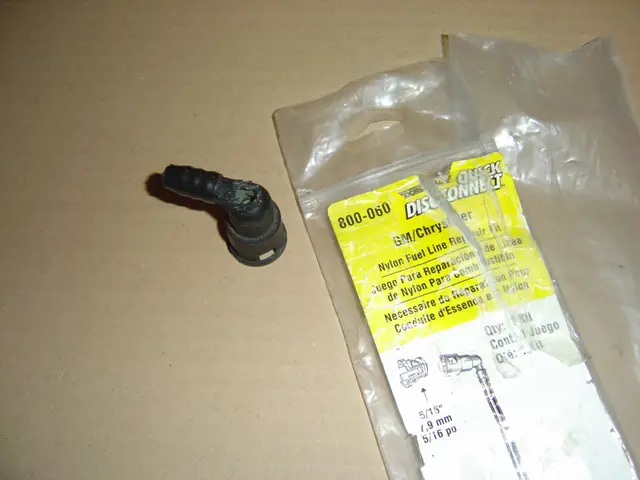

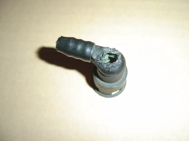

Turns out a mouse chewed a fuel fitting on top of my fuel pump.
I fixed it with something I found at a local parts store. it was not the exact one for my truck so I had to modify it a little. I had to trim a little plastic off the retaining clip but it worked. Just a note for anyone that may have to repair a plastic line like this, the instructions say to soak the lines in hot water but that did not work for me even after 20 minutes of fighting with it.
I put the metal union in a small pair of needle nose vise grips and installed that into a vice. I then heated the lines with a cheap Harbor Freight heat gun and it worked in seconds.

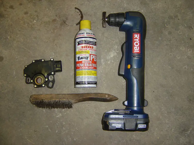

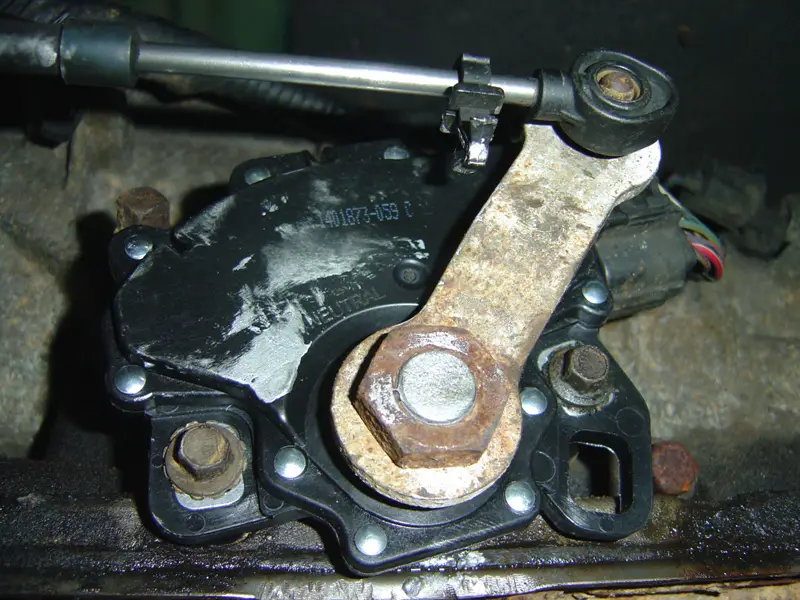

The shifter has been stiff for a while now. I guess for too long since the shifter bracket on the steering column came loose like many other's have. I tightened up the two screws and will be replacing the MLP (manual Lever Position switch) which is also referred to as the neutral safety switch.
I am working on a friends 2001 explorer which had the same symptoms but worse, his would not go in park and to top it off his E brake don't work. lol.
To find the reason for the stiff shifter movement I unhooked the shifter cable from the transmission. the shifter moved easy. The transmission lever where the cable hooks up was real hard to move. I next unbolted the MLP and the lever became easy to move proving the MLP was binding.

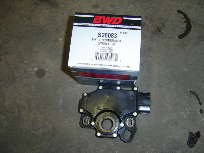

The Old MLP sensor was fun to get off of my Ranger. The shift shaft had rusted underneath the MLP. I got the bolts out, cable disconnected etc and had to pry on it working it back and forth. It finally came off. I had to wire wheel the shaft, and scrape it with a screw driver. After cleaning it thoroughly I applied some anitseize. I think some ended up on my ear, stuff gets every where as soon as you open it. lol.
I did not have to adjust the cable but if needed, the adjustment is done at the bottom of the cable where it attaches to the bracket on the transmission. You pull the white/yellow part out to unlock it and push it back in when you have it set correctly.
I had noticed the shifter was a little stiff but did not realize how bad it was until after fixing it. It is so much easier to shift through the gears now.

1. old part, new box with BWD part number.

4. Shifter Cable adjustment location.

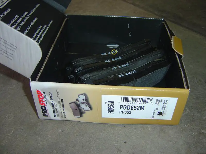

Yesterday I did some maintenance on my Ranger.
Air Filter,Fuel Filter,oil change to start.

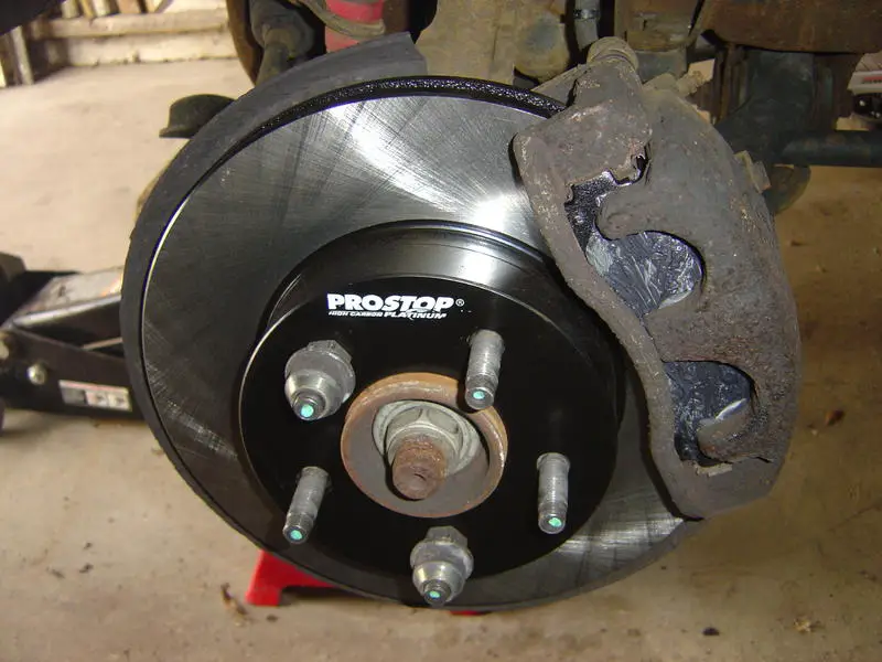

Then it was on to the brakes. I got the same brake pads I always get from PepBoys, they were stamped with FE (friction rating). I also got the high carbon rotors. I checked the rear drum brakes and they were fine so I adjusted them and bolted the tires back on.
