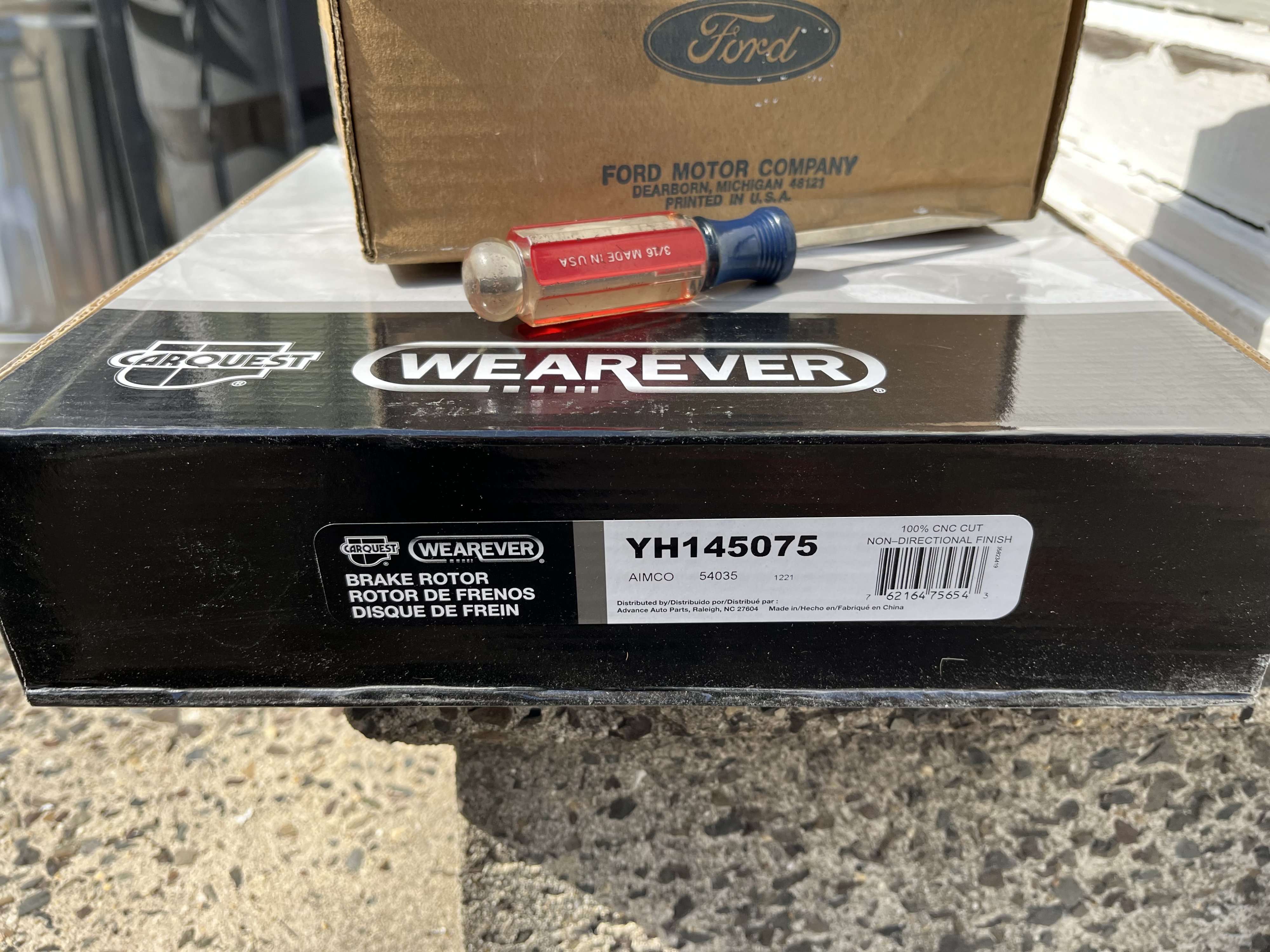

Today I ordered Brake rotors from Advance Auto Again. Once everything gets here I will replace them.

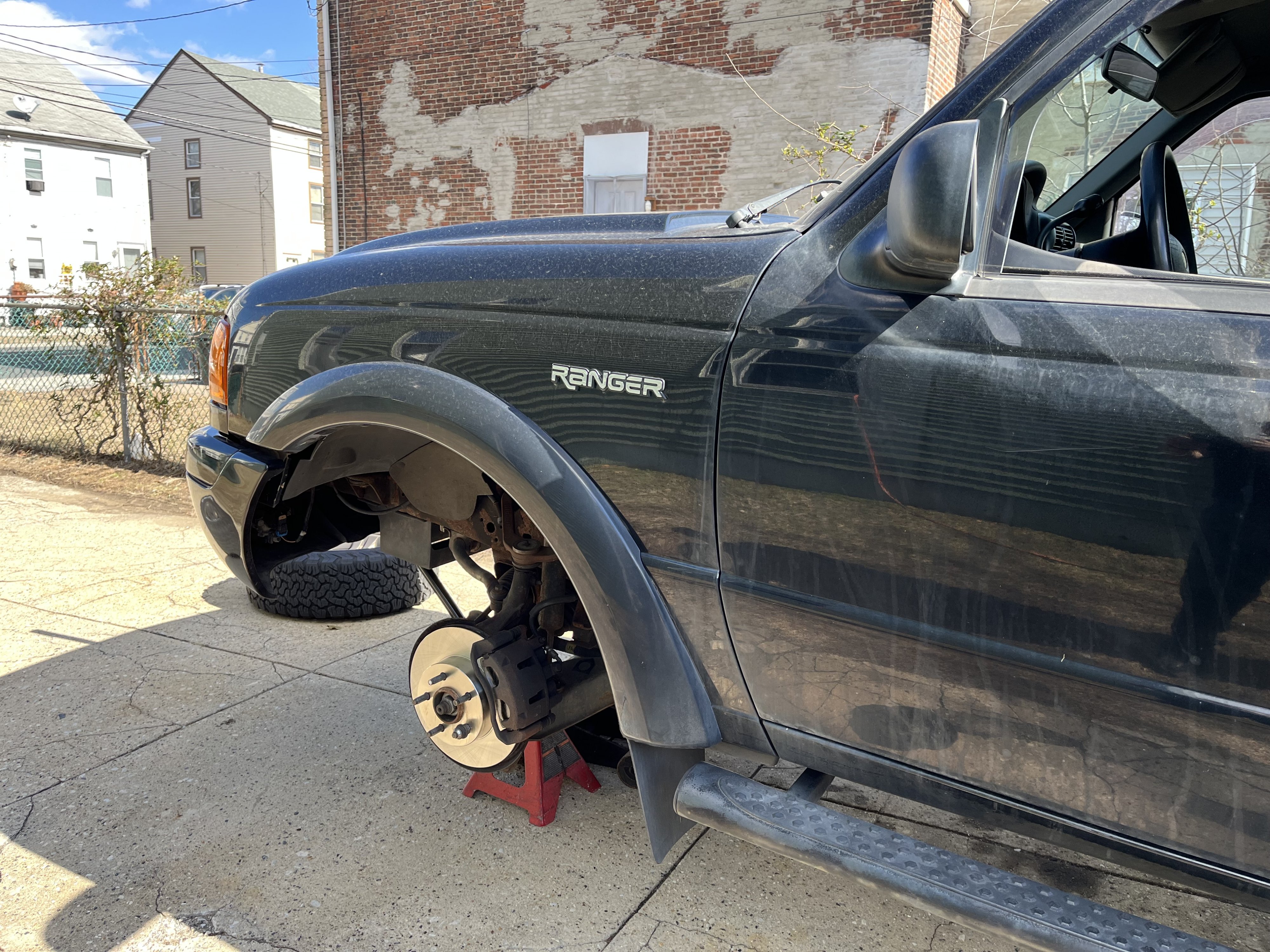

Today my rotors arrived and tomorrow my Motorcraft front brake pads should arrive. It's also warm here for some lucky reason so I hope to install the parts tomorrow after work if possible. I will take pictures of course.

And just for the record, the caliper slides can be moved very easily with one finger, and the caliper pistons went back in without a fight.
The brake pads do not bind in the caliper bracket. Again, brake hoses and calipers were replaced recently and posted in this thread.
After installing the new parts and putting the wheels back on I left it on the jack stands. Then I started it, pushed hard on the brake pedal a few times, and then with it still running I got out and spun the wheels and they moved freely. I road tested it and it stops straight and the pedal feels firm and doesn't sink or anything like that. I installed Ford OEM pads this time.
The brake pads are placed as they came off. The worn one is the driver side inner pad.
That's too much wear of one pad, but the rest look almost new. I haven't had to change many calipers, mainly from lack of driving a car for years. But the times the rebuilt calipers had some sticking pistons was a high percentage, maybe 25% out of about 8 or so.
Unless you could see something wrong to fix with that left caliper, I'd replace it again. My black 98 wore out the rear pads in about nine months after the first brake job. The inner pads wore out and the outers were about half gone. I installed rebuilt calipers, and over a year later one side was still wearing a little too fast. I had that replaced under warranty, and it functioned fine after that.
Re-manufactured parts have a slight risk to them versus new or the original parts. I learned about 15 years ago to avoid rebuilt steering racks for Fox Mustangs, the cores are in large part, all worn too much.
