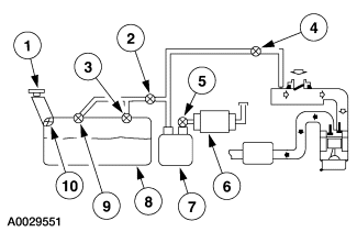

I also noticed this Evap line missing an attachment(and goo on it). I wonder what goes there?
Gonna look into that later.
The brake line was replaced/bypassed, I knew about that one.
Update:
It looks like someone broke the plastic Y fitting and glued it back together. In the process they clogged it up. I tried to blow air into it and it was clogged solid. The hose that was attached to that spot is also plugged up with a bolt, it is on top of the gas tank.
Now this system is for catching fuel vapors as they expand and also allows pressure out of the gas tank while catching the HC's (fuel vapors) in the canister. Fortunately for me there is another Y on that line with another hose going to the top of the fuel tank at the sending unit/pump so pressure can still be vented through the Evap canister. #9 in the diagram is still functional but 3 is blocked off on both ends.
I will replace the whole line since it is plastic and has all these crazy fittings on it. The thing is about $95.00 though so it will have to wait a bit.
I also removed the old brake line and secured the new one better.
Item Part Number Description
1 9030 Fuel filler cap
2 9C052 Fuel tank pressure sensor
3 9B593 Fuel vapor vent valve
4 9C915 Evaporative emission canister purge valve
5 9F945 Canister vent solenoid
6 9B328 Evaporative emission dust separator
7 9D653 Evaporative emission canister
8 9002 Fuel tank
9 9B593 Fuel vapor vent valve
10 9A244 Fuel filler pipe check valve
