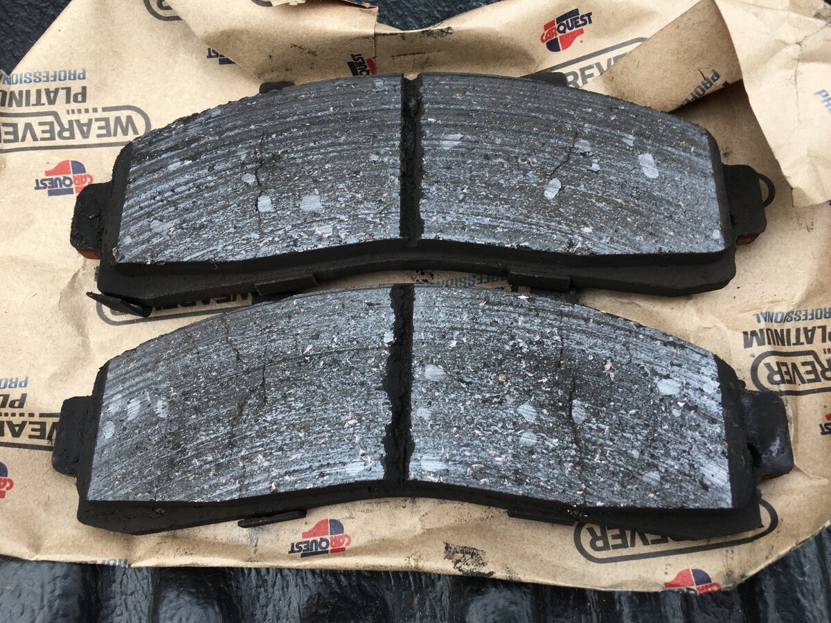

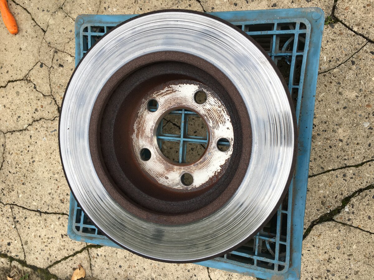

Here are the brake pads and rotors. There are hot spots and even some small cracking on the rotors. The pads are cracked as well.
Here is the small cracking I found on one of the rotors.
I didn't look close enough at the other one to see if it had cracks too, but it probably does.

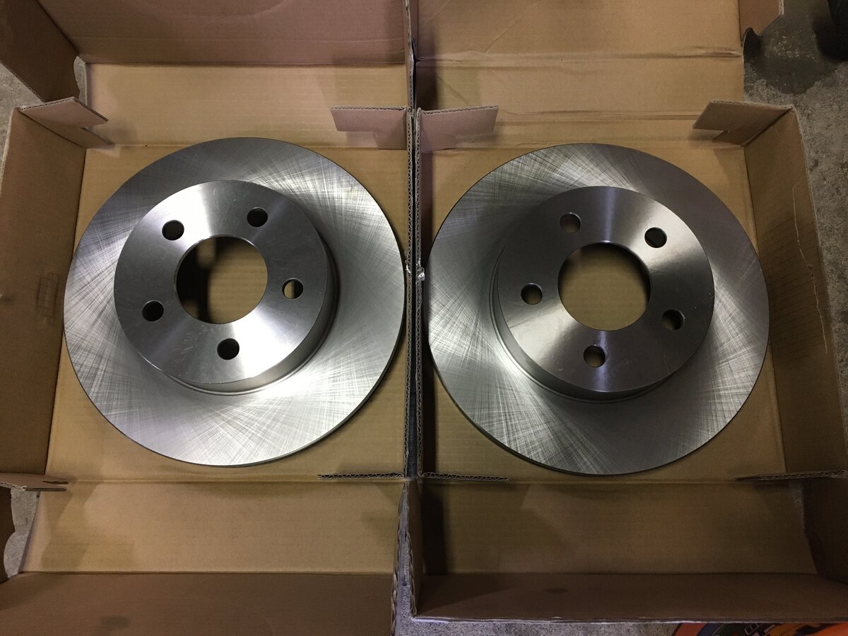

New Rotors and Pads. Pretty straight forward, I will add these pads are the top of the line that they had in stock and were the same as the ones I installed back in 5-30-2019. They have a number stamped on them ending in FF which is a friction rating. Later the letter in the alphabet, the better the friction. Both being F's means the same friction is there cold and hot. I have FE's on my 2000 Explorer and will look for FF's the next time I replace them. The pads came with all new anti-rattle hardware.

The rotors

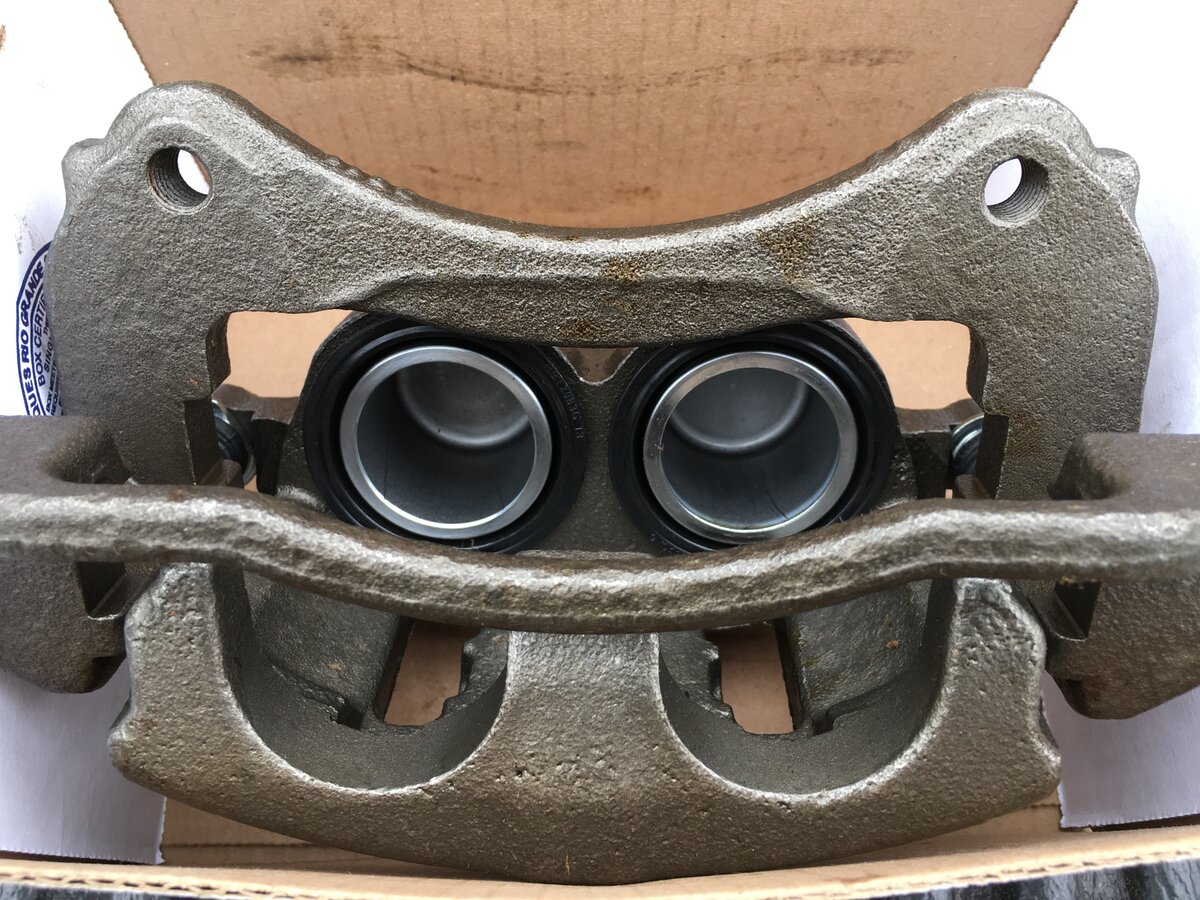

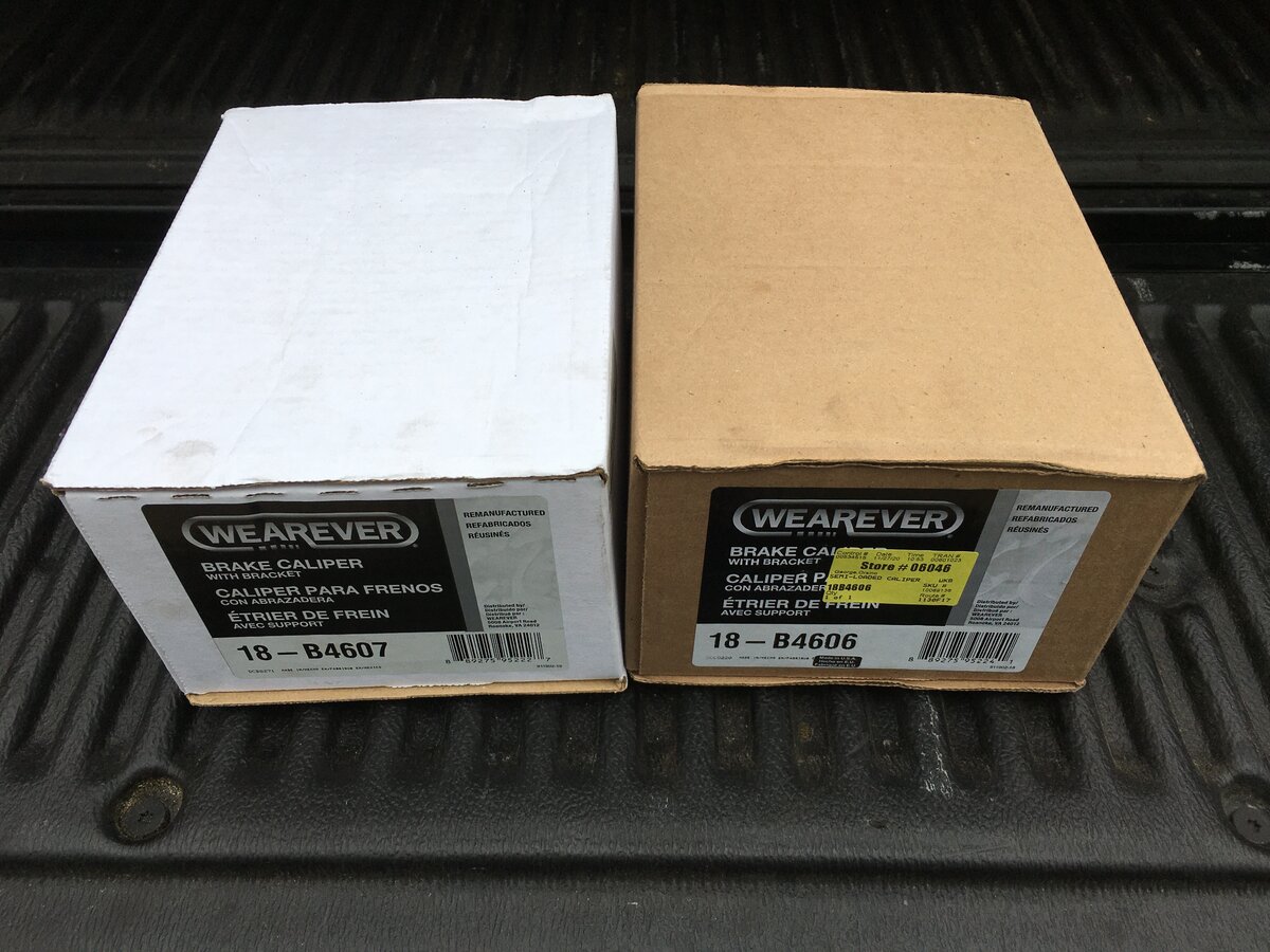

Remanufactured calipers.
Here is where I was a little disappointed in the quality of the parts I bought.
I ordered two Wearever brand calipers with brackets online but when I picked them up one was a brand called OEM and the other was Wearever.
The Wearever caliper was very nice looking quality, new pistons and everything looked like it was put together correctly - a quality remanufactured part. The OEM brand caliper.....just not the same.
Pulling it out of the box I saw one of the dust boots was not installed correctly and one of the caliper pistons was dented like someone threw it across the room before installing it. I did receive another Wearever brand caliper but it was not much more promising than the OEM brand one.
The caliper in the white box was the first Wearever one I received and looked very nice.
Here it is.
I did not take any pictures of the caliper with the OEM brand name on the box.

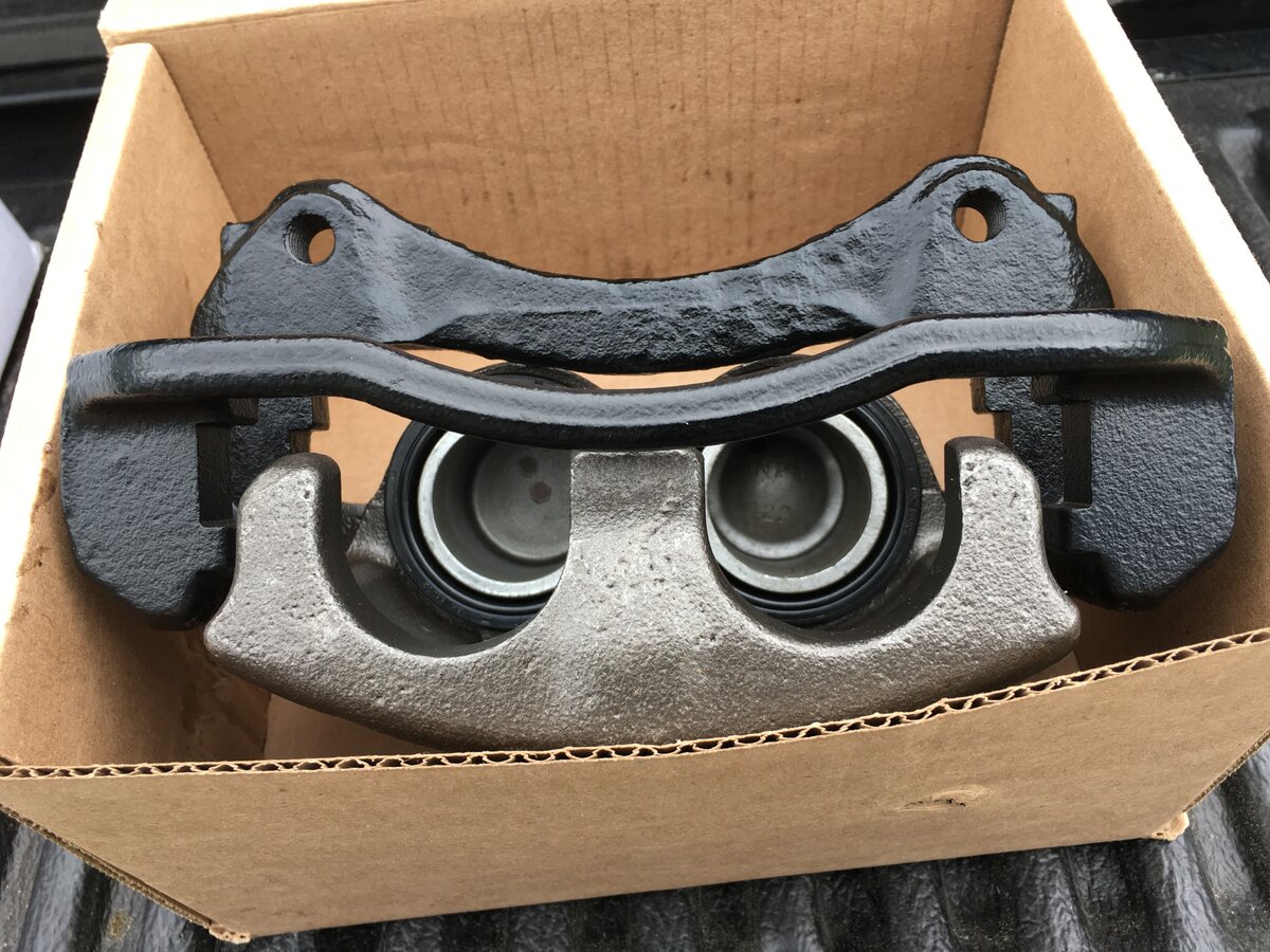

Here is the replacement caliper I got, at least it came in a Wearever box!
The first thing I saw was the caliper bracket was black, unlike all the other parts. OK?
Then I saw that there are two different pistons in it. LOL. Maybe I am being too picky.
At least all the dust boots on this one are installed correctly.
I did end up using it and it seems to work well at the moment, time will tell if it holds up. LOL.

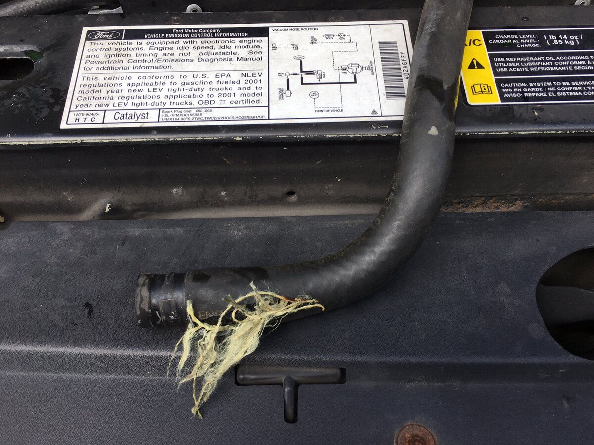

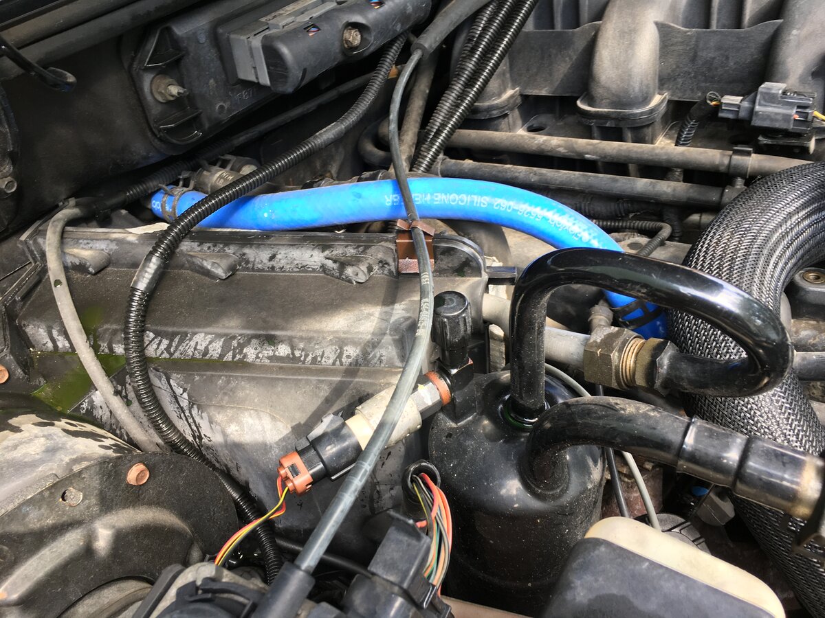

Yesterday I had a heater hose blow out. I was half way to work and turned around and drove it home smoking all the way.
Overheated of course. Took my 2004 supercharged Explorer to work and still made it on time.
I replaced the heater hose and it took over 2 gallons of coolant to fill it back up.
After cleaning the engine compartment and hood from all that coolant that blew out, I road tested it and heat cycled it a couple of times.
Today I took it out and got it all warmed up, turned on the AC and beat it hard to see if anything else would pop.
Nothing popped, no overheating, and no coolant loss. The gauge seems a little more active, like when the thermostat cycles but the gauge is not going any higher than it used to. The thermostat may have been damaged from all the heat so I will keep an eye on it.
I thought I would add this picture of the blue hose that I had in my garage that I installed. I use this stuff inside my intake manifold on my 1998 supercharged Explorer for my liquid intercooler. I cut about two inches off the end and it fit perfectly.
You can also see all the coolant puddling on top of the evaporator case, it got everywhere, even in the hood insulation.
I cleaned under the hood and under the truck with a garden hose. Funny thing is I still smell coolant, but I have not lost any coolant at all in the last three days since I replaced the hose. Today I even pulled the radiator cap off when it was cold and it was filled to the top. No drop in the overflow tank either. When the new thermostat shows up I will be replacing the one that is in there now, maybe next weekend.

Today I did the brakes again, they were pulsating for quite some time. These have less than a year, and only 6,001 miles on them.
I switched to the Wearever Semi Metallic ones labeled "gold" because I got the Wearever ceramic labeled "platinum" the last two times and I am not impressed with them.
The ones that came off looked horrible, just like the last time. Heat spots in the rotors and the pads are all cracked up.
I am hoping that the different pads I installed this time will solve this problem. If not I will be switching brands and probably ordering off the internet instead of buying local.
In this picture below you can see the hot spots in the rotors and cracks in the pads on the right. There are cracks in the pads on the left too, they just did not show up in the picture. I am hard on my brakes and I have 31 inch tires on this truck, but I have never had this happen to my old 1998 Four door Explorer even when it had 315,000 miles on it. I might even look into swapping the rear 10 inch drum brakes to a disk setup in the future.
