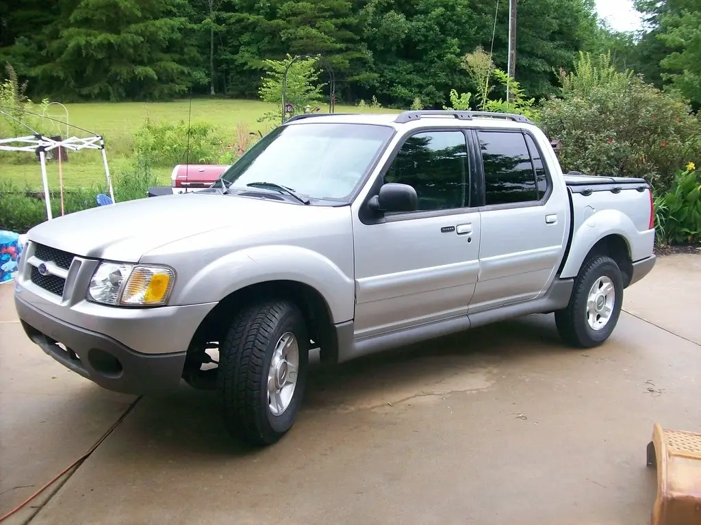

Good luck with your project. I'm nearly finished with my '01 ST project. (see my "New Toy" thread for details) which I started this past June. Here's a pic of the way it looks today.
