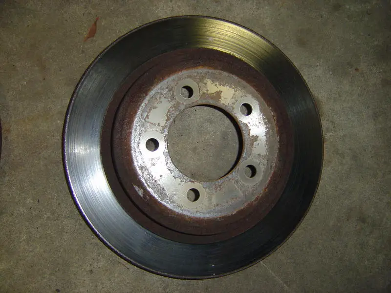

Today I spent most of the day tuning my supercharged Explorer.

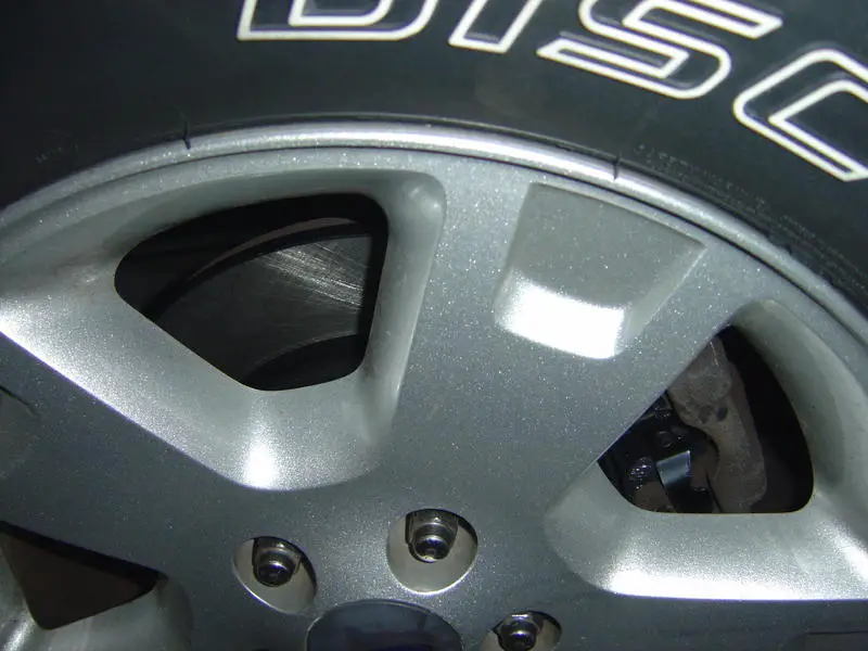

After finishing that I put rear brakes and rotors on my 2004.
There was a pulsation and it felt like the rear, no steering wheel shimmy.
I already replaced the front brakes and rotors.
New rear pads and rotors took care of that pulsation, it is gone. Stops nice and smooth like it should now.

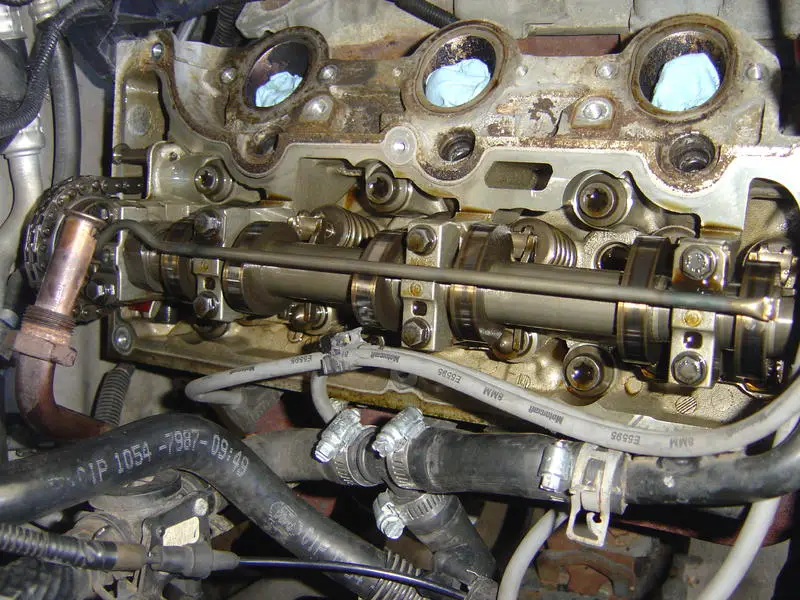

Timing Chain Guide
Today I decided to do a little investigating on the engine of this truck.
I have a lean condition on one bank so I decided to remove the intake again and see if the o rings that I just installed were still in place. They were, I looked over the intake manifold at the seams but couldn't see anything wrong there either. Decided to pull the injectors out and swap them from side to side just for the hell of it.
Once the injectors were off, I had no excuse for not removing the valve covers and inspecting the timing chain guides. I had heard a noise at start up, funny how the noise went away as it warmed up. Found the timing chain guide on the passenger side rear of the engine to be all busted up.
So I started pulling the transmission to gain access to the rear bolt for the timing chain guide. I have not even started to rebuild the original transmission yet. Planning on doing that at the beginning of May. LOL. Guess I will be pretty fast at pulling the transmission out after all these times.
I am amazed how clean the engine is inside.

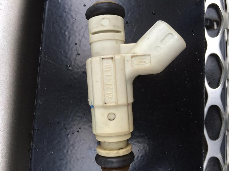

Did you put bigger injectors on your Explorer?
Are the old ones white?
Have any pictures of them?
Thanks for the offer.
I am not going to worry about the injectors right now, got to get that timing guide fixed first. Then I will see how it runs.
I want to find out more about the injectors, specifically how much they flow. It may be that they flow the same and are just different in body design.
Yes now I have in the ford racing cobra 39 injectors
and yes the old ones are white

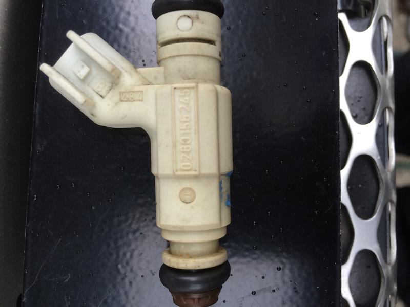

here is the photo

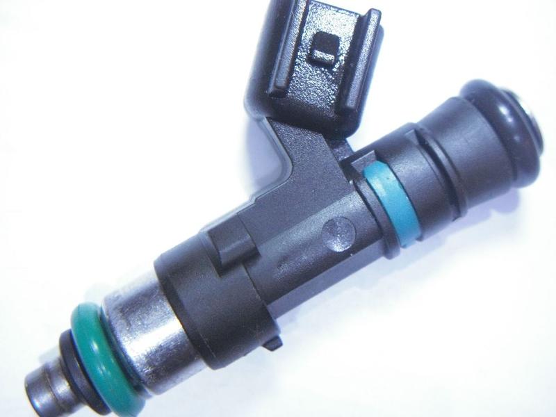

Injectors
Thanks for posting that picture,
here is a picture of what mine look like except the plastic thing near the top is white not green. It would be interesting to see if the specs are different.

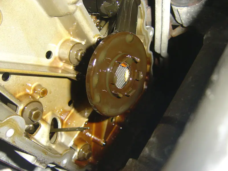

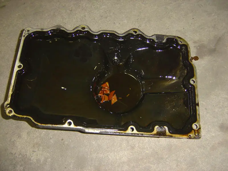

Timing Guide almost done

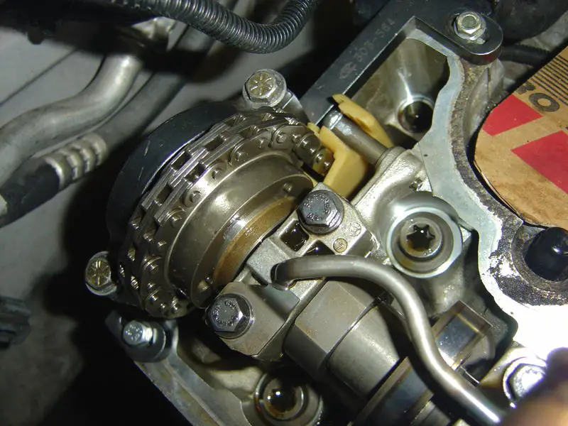

Almost finished replacing the timing chain guide that was shattered.
There were pieces everywhere like I expected.
Pulled the transmission again to get to the bolt that is below the bellhousing.
I am getting faster at pulling the transmission, cant wait to start rebuilding the original trans that came out. Not starting that till May though so I put the used trans back in.
When the trans was out, the lower oil pan was real easy to get out. It may be just as easy with the trans in, I will have to take another look at that.
There were all the other pieces of that guide, in the pan and in the pick up screen. Good stuff!
The truck is off the jack stands, only top engine stuff to do like install the fuel rail, injectors, and intake manifold.

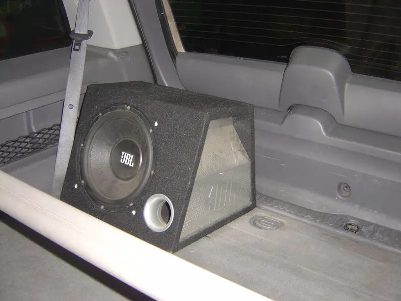

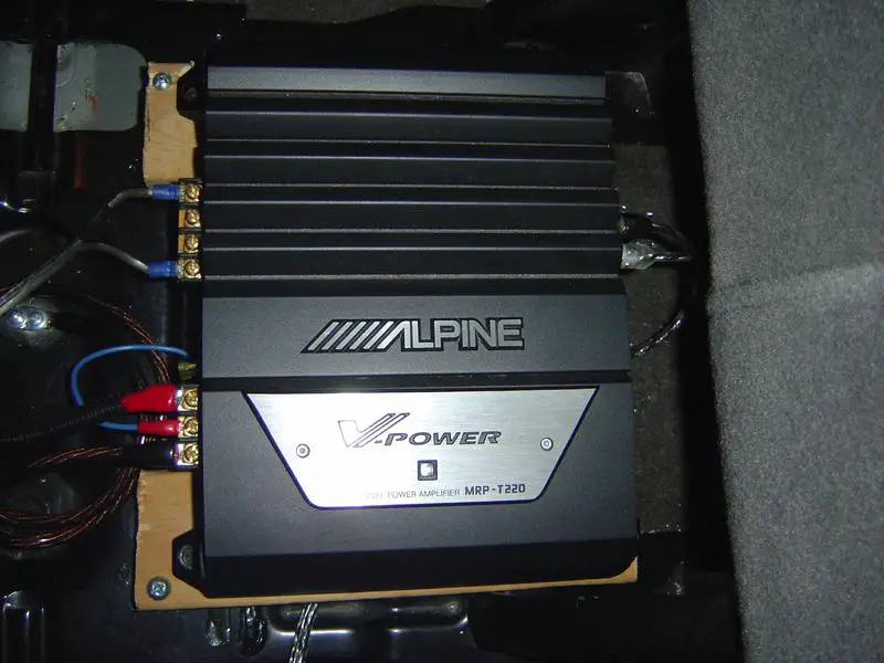

Even had time to install an amp under one of the rear seats.
Now if it gets noisy again I can just turn up the radio. lol.

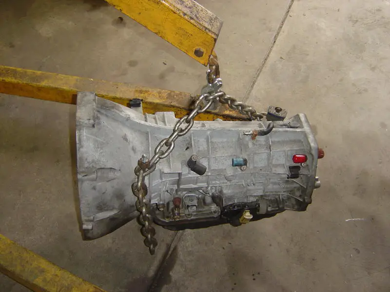

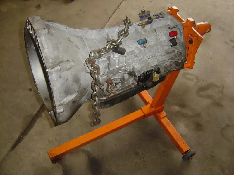

Transmission rebuild has started

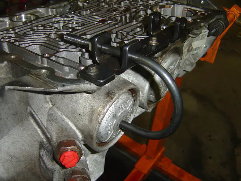

Got a good start on rebuilding the original transmission out of my 2004.

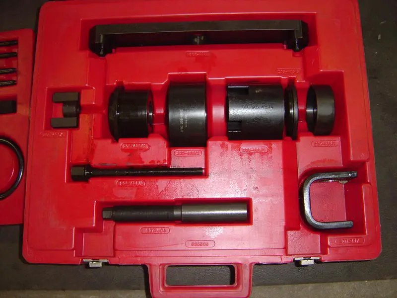

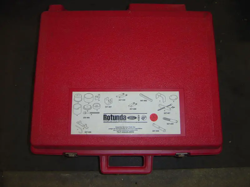

Got lots of parts, and some new tools too.

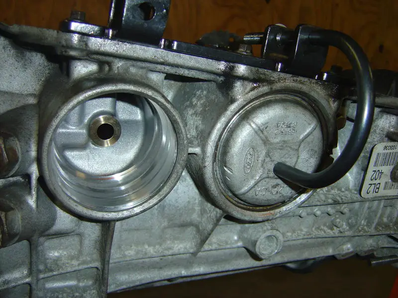

Two tools that have made tear down much easier are the pump puller, and the servo cover depressor.
Man that pump was holding on for dear life, slide hammer attached to the pump puller and after a few good bangs it came off.

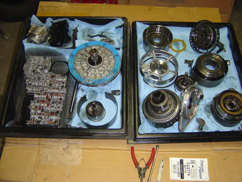

soak time

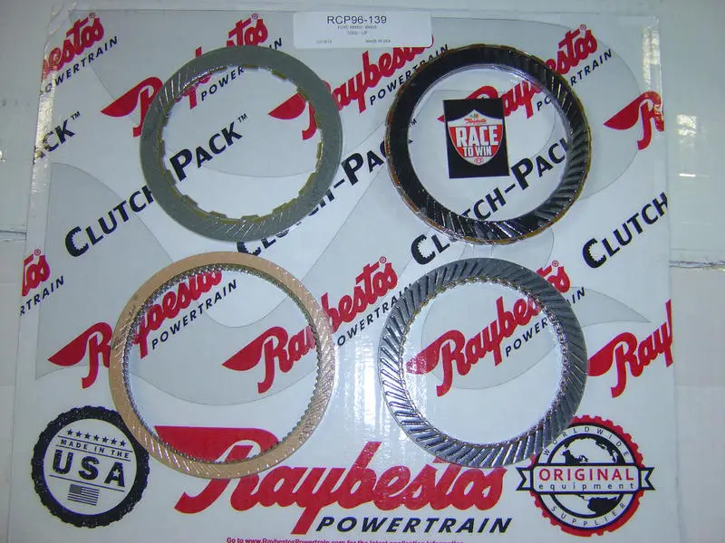

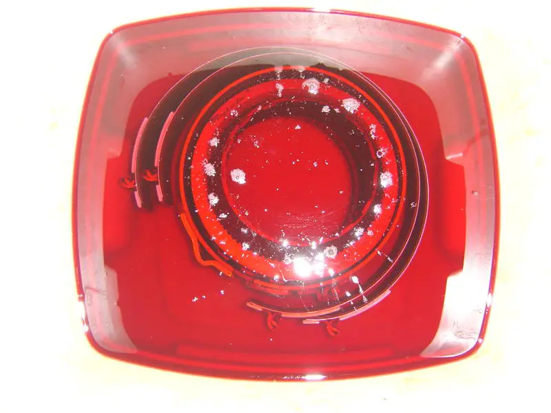

New clutches are soaking overnight.

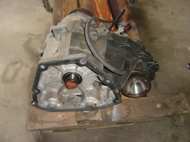

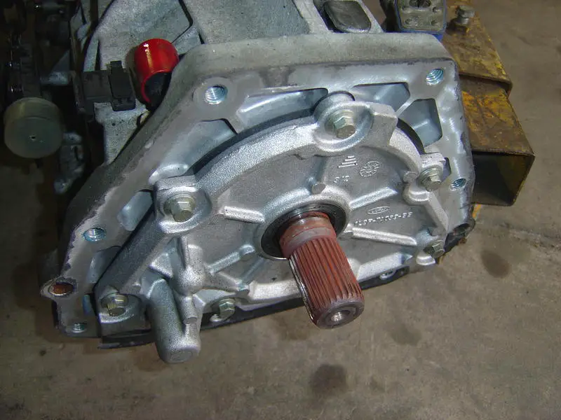

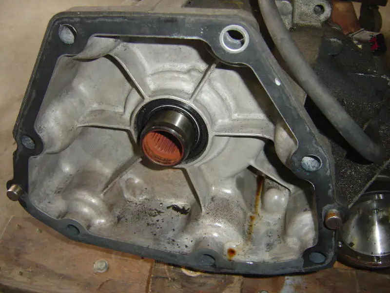

One thing I thought was cool was how when the transfer case was removed, there was no fluid in between the transmission and transfercase. There is a plate with a rear seal that goes on the back of the trans.
