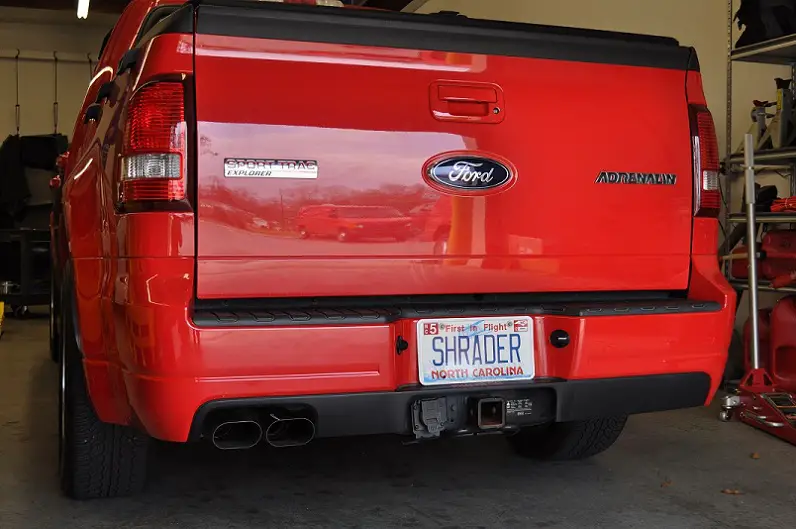

Got the exhaust all wrapped up. Here's a shot of the custom oval tips I ordered from Pypes. Pricey but worth it.Exhaust now goes through dual 3" 50 series Flowmasters, true duals all the way out the new tips.
Awesome bro! Looks very well fresh and clean. Can't wait to hear a clip of you driving it from the inside and out! :thumbsup: :thumbsup: :thumbsup:
