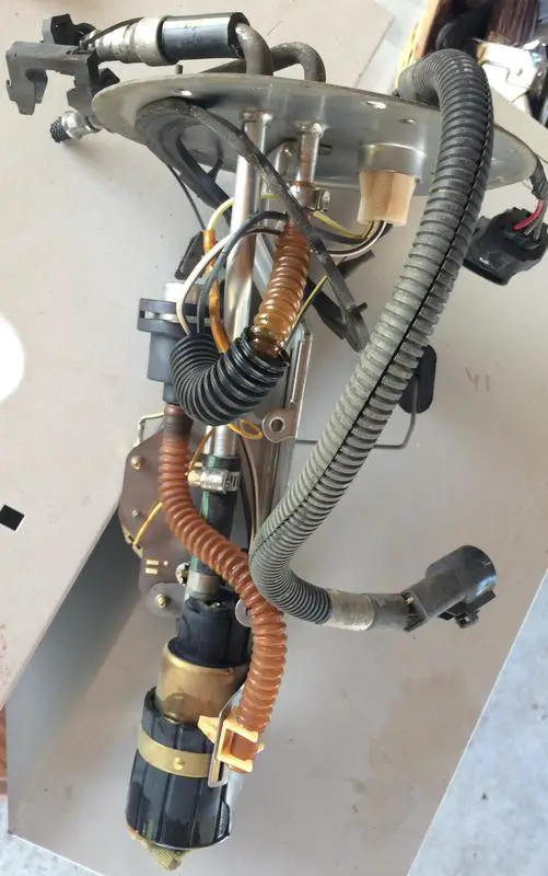

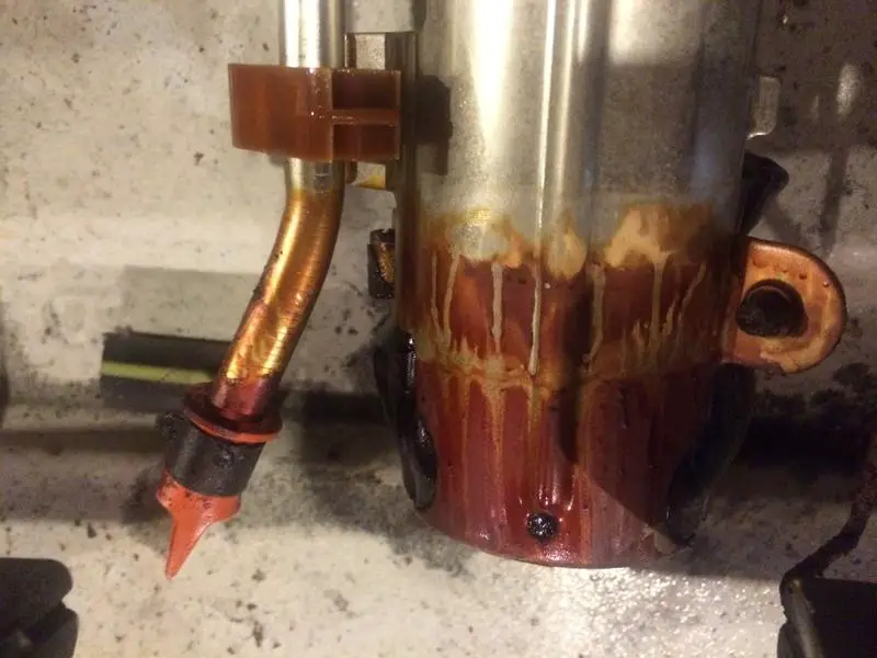

Here is the bolts to remove to take out the tank,
in tank pump was varnished over and the strainer filter was nearly eatin away by the old fuel. Pump was dead!
