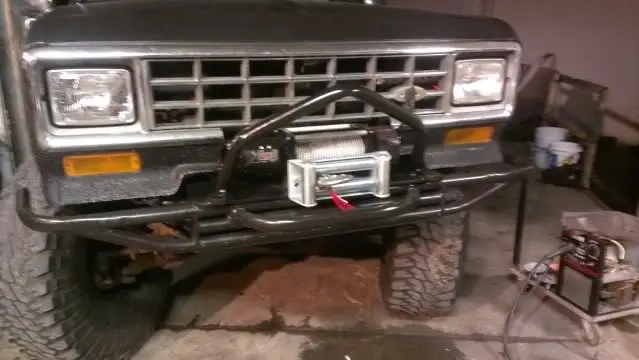

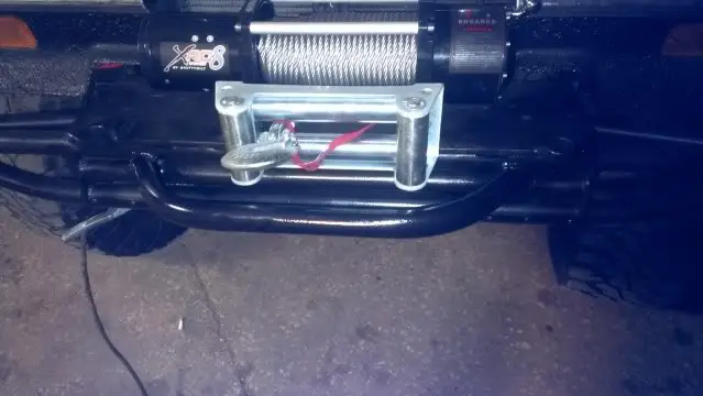

×2 on the winch, looks good (kindof how mine is, tucked under the grill a bit)

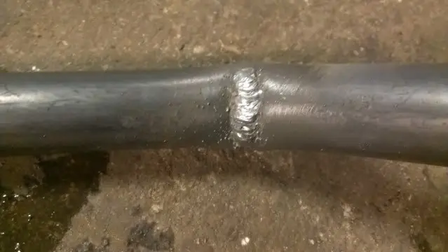

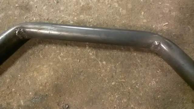

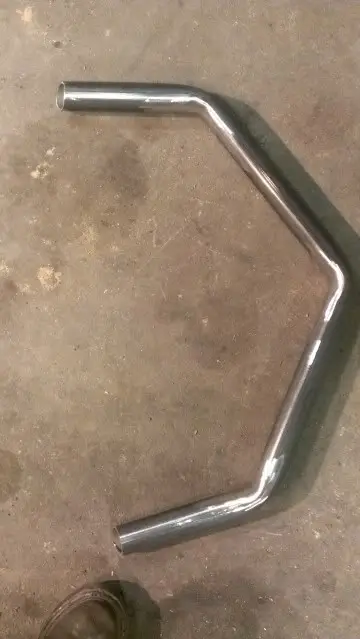

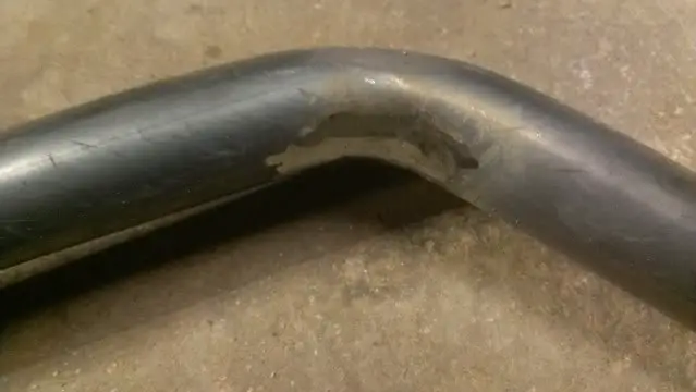

OK.. I added a small bar in front of the winch next a stinger...
On the stinger after I bent it I didn't like the way it creased at the bends, so I fixed it...
Still not done but looking better, I think!

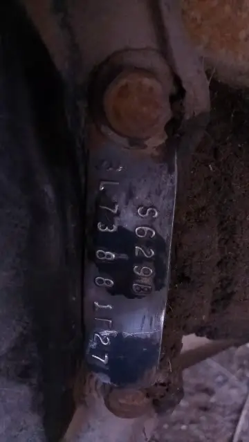

I got the bumper done, I'll have to get some pics loaded. I found a 93 Explorer with this rear end tag.
I'm getting the hole explorer to get what I need. has 79K on it. Now with the D35 front, I will need to buy manual locking hubs? Or is there another set that will work on it?
