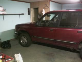

Pictures of the explorer sitting in her new garage. Sadly enough its already full of crap and I've only lived in the new house for less than two weeks now. Moved in on September 3, 2011.
Also removed the roof rack, even more sad is that the explorer was just an inch or so from the garage door when pulling in. With it all the way in and the door shut, I have like two feet in the front and maybe one and half feet behind the explorer.
