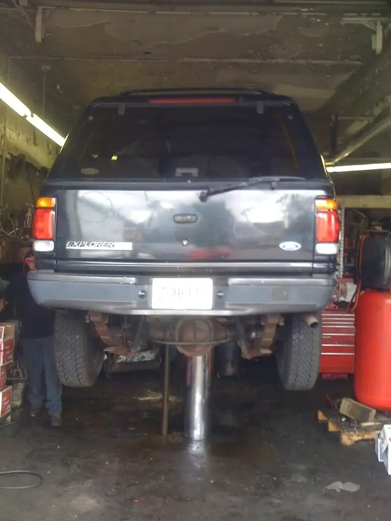

Here are a few pics of the Explorer on the lift today.
Oil Change + Transmission Fluid Change + Pan Gasket & Filter
Trans feels alot smoother now... less clunking when shifting to reverse or drive.

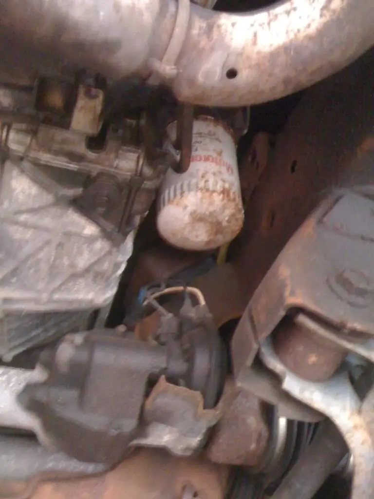

Holy Rusty Oil Filter Batman

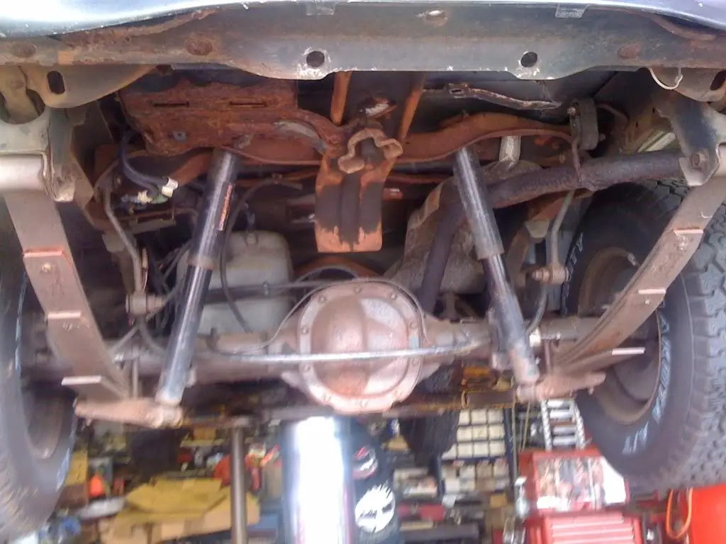

Front End
Hooray Rust! (The rear diff seal was fairly new.. so I left it)

Jeez....someone didn't keep up with maintenance well. I see you work for the place I was considering to get my front windows done on my explorer, can't find any places closer plus they facebook good deals.
